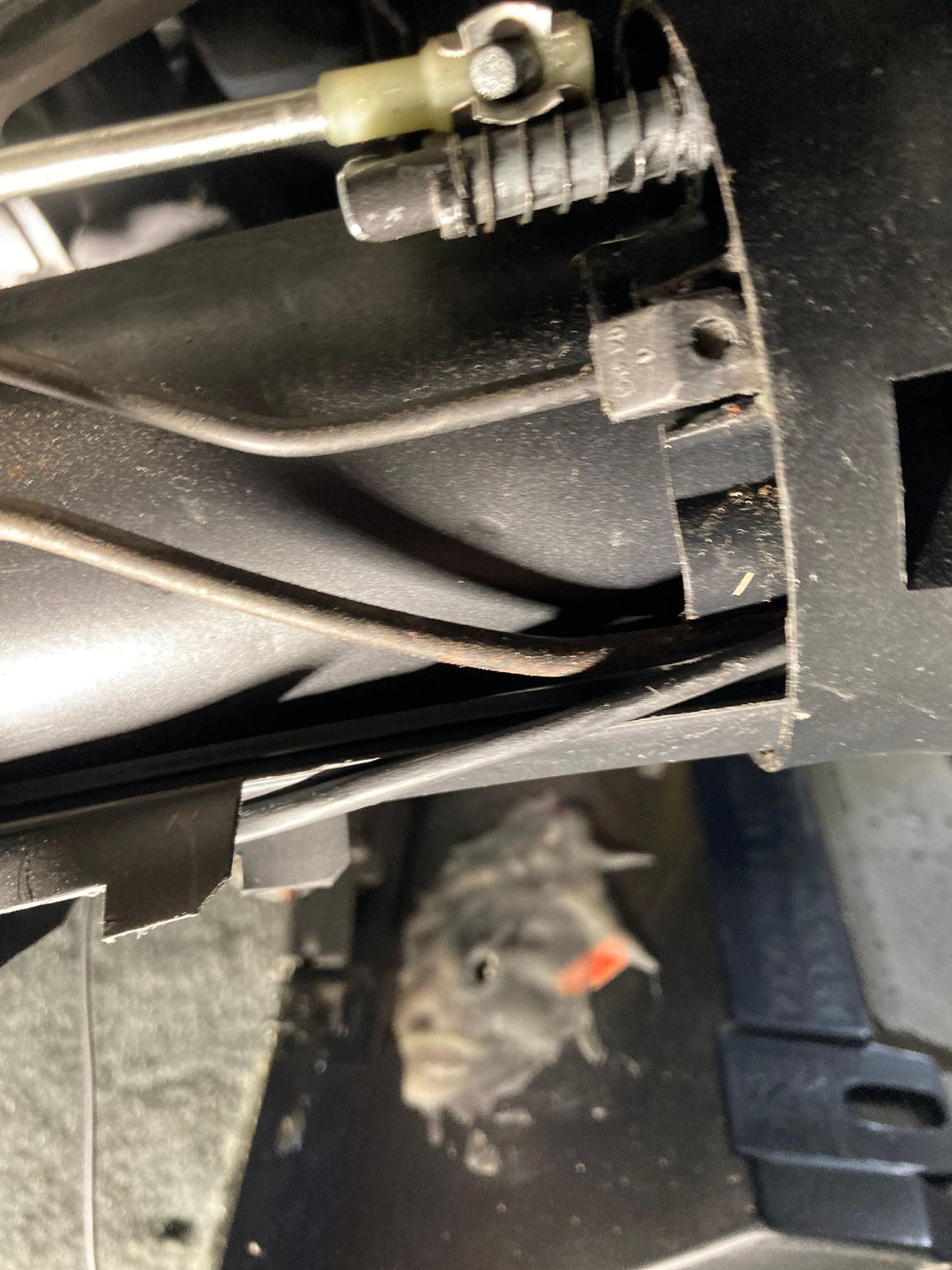

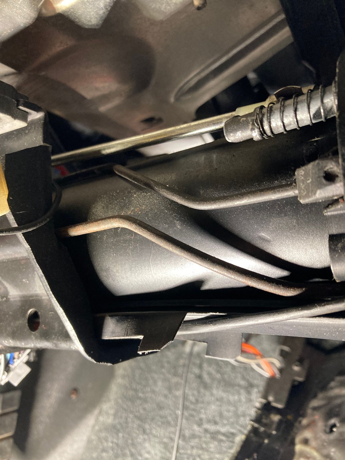

OK, I checked the park lock cable, and all looks good with that.
I have gotten into the steering column and the first thing I did was loosen the 2 bolts holding the column to the brace under the dash and noticed the lock cable as shown in the pic not connected to anything.
What does the lock cable from the transmission connect to on the column?
The steering wheel has never locked since I have had the car, but I was able to turn the ignition to the lock position and remove the key before.
What will prevent the steering wheel from locking?
And could someone tell me what all of the linkages are?

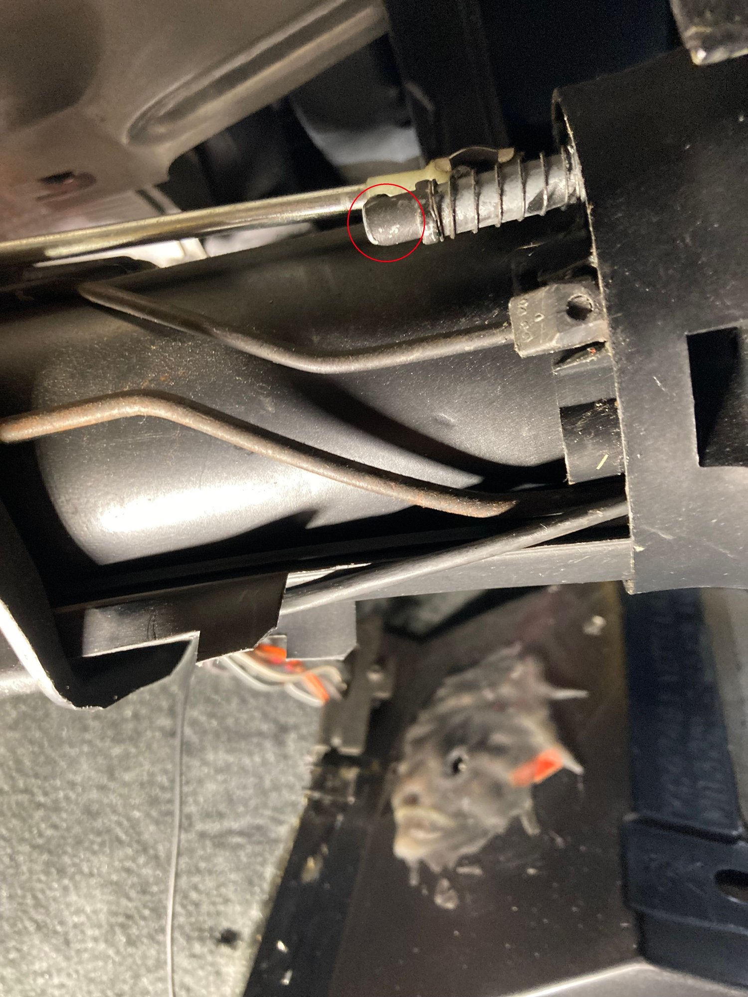

It appears that the 'ball stud' is busted off of where your shift lock cable should attach. Stud looks to still be in the cable end.
This eBay column has several snapshots you could 'zoom' for better comparisons. There are other columns on eBay for more and maybe better images.
https://www.ebay.com/itm/13390760372...8AAOSw2N5hbbKH
It's difficult to confirm from your snapshots but the rod down the column from the rack and key cylinder pinion to ignition switch seems to be likely OK. It's difficult to tell without 'touch/feel'. You should be able to ID the rod to the 'dimmer' and the other is ignition rod/rack (switch to cylinder pinion).

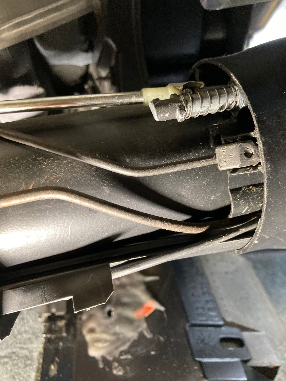

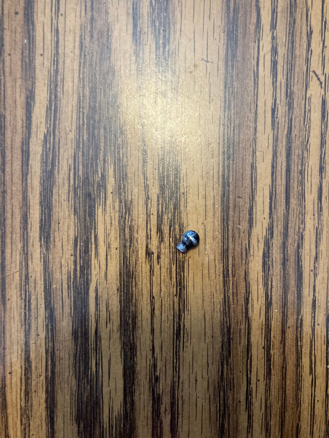

WVZR, I was hoping you were going to reply . That listing showed me what I needed. Here she is:
It is obvious where it is supposed to be:
Would this part be the cable backdrive pin? And where does one get this part?
Now I understand that this was preventing me from getting the key to go into the lock position to remove the key, correct?
But does it also lock the steering wheel? Because the wheel has never locked as long as I have had the car, but I could get the key out before?
And how does it come out to be replaced?

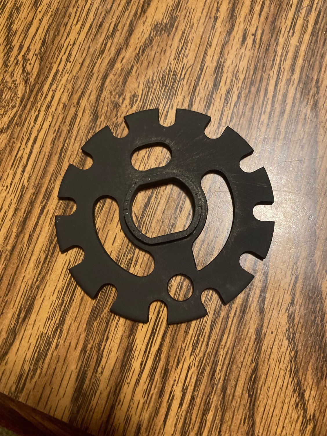

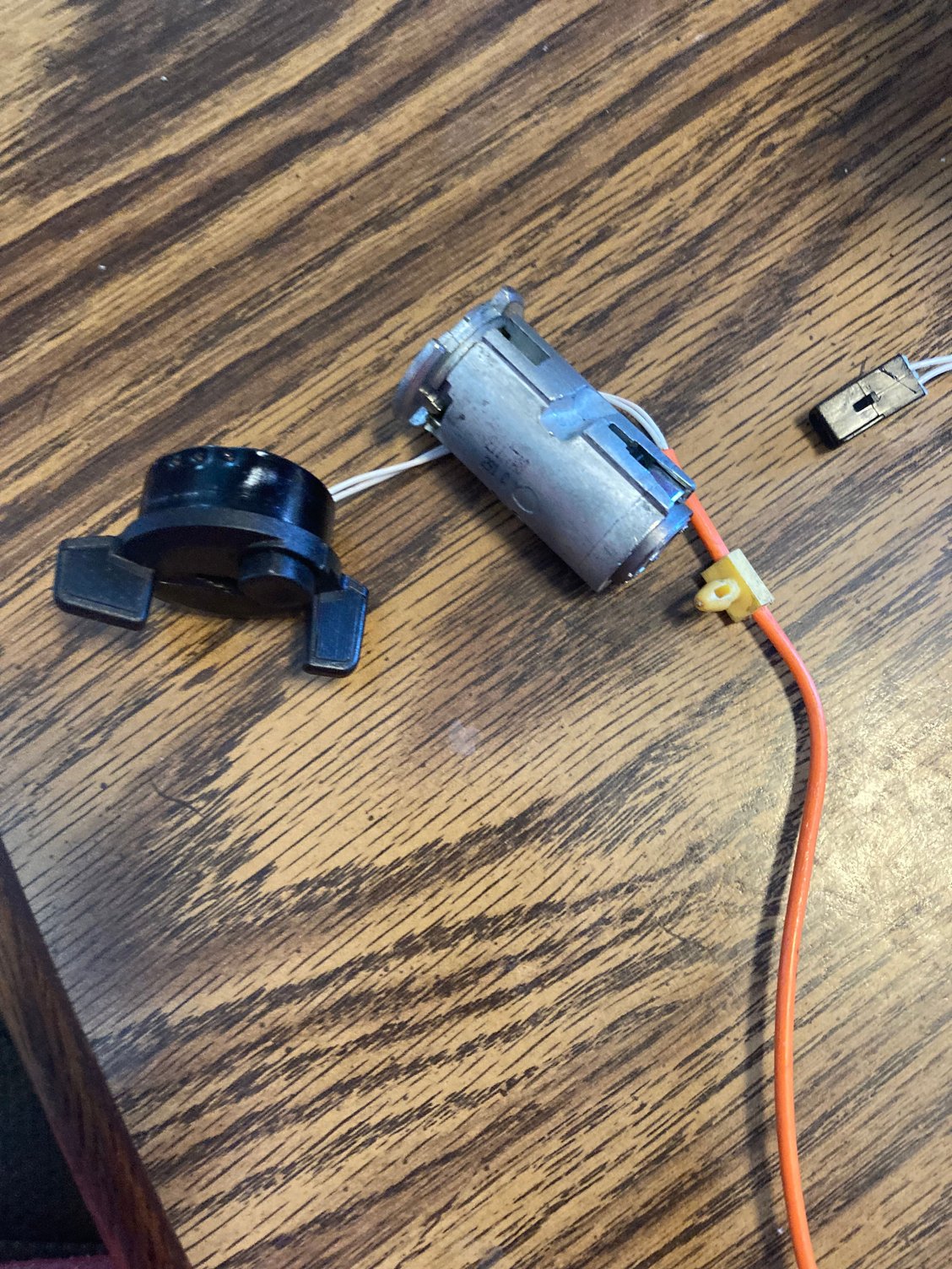

Well, I got the new lock cylinder in and got everything put back together. I was not able to start the car because I had my battery off of the tender, so it needed to be charged. In the process of checking the key function, I noticed the key getting really floppy. So, I took it all back apart again and the cylinder literally fell apart in my hands.
So much for this $70.00 POS. I got this from Corvette Central part # 504397-1. I did not like the push button.
I decided to purchase the 86-88 All & 89-96 Auto Ignition Lock Cylinder w/Test Key from Zip. Item # LK-381. $50.00
I also discovered that the lock plate was installed backwards. I don't know if the locksmith that I had out last year had done this or if it was already like that before he got to it. Does installing it backward hurt anything?
This side that is showing should be installed facing out, am I correct?

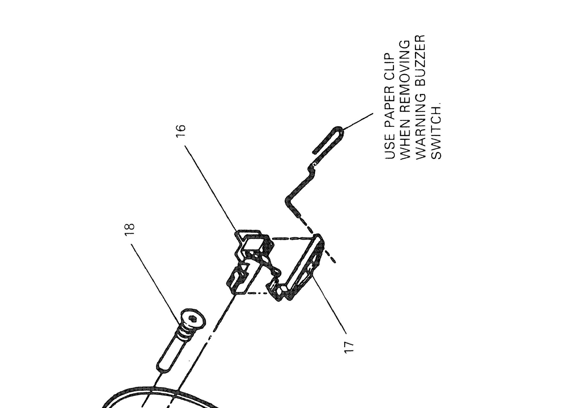

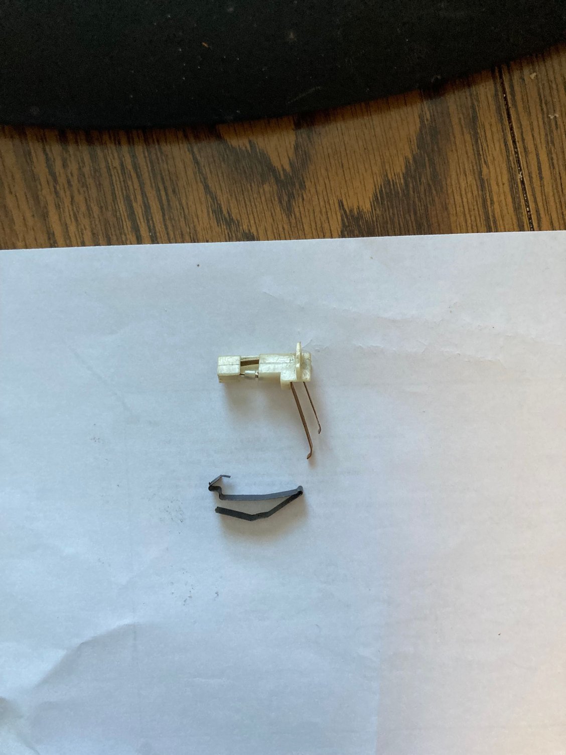

Ok, I got the new lock cylinder and have it installed, but I am having an issue with the key warning buzzer switch assembly. With it installed it prevents me from turning the key in any direction. With it out, the key turns to all positions. Any ideas what I might be doing wrong here?
Old Feb 26, 2022 | 04:54 PM
  #39
WVZR-1's Avatar
WVZR-1
Joined: Sep 2003
Posts: 25,393
Likes: 2,741
Maybe the 'buzzer' clip is tweaked

The clip looks normal to me, The battery is disconnected, and I have not gone any further with assembly beyond the key cylinder and buzzer.
