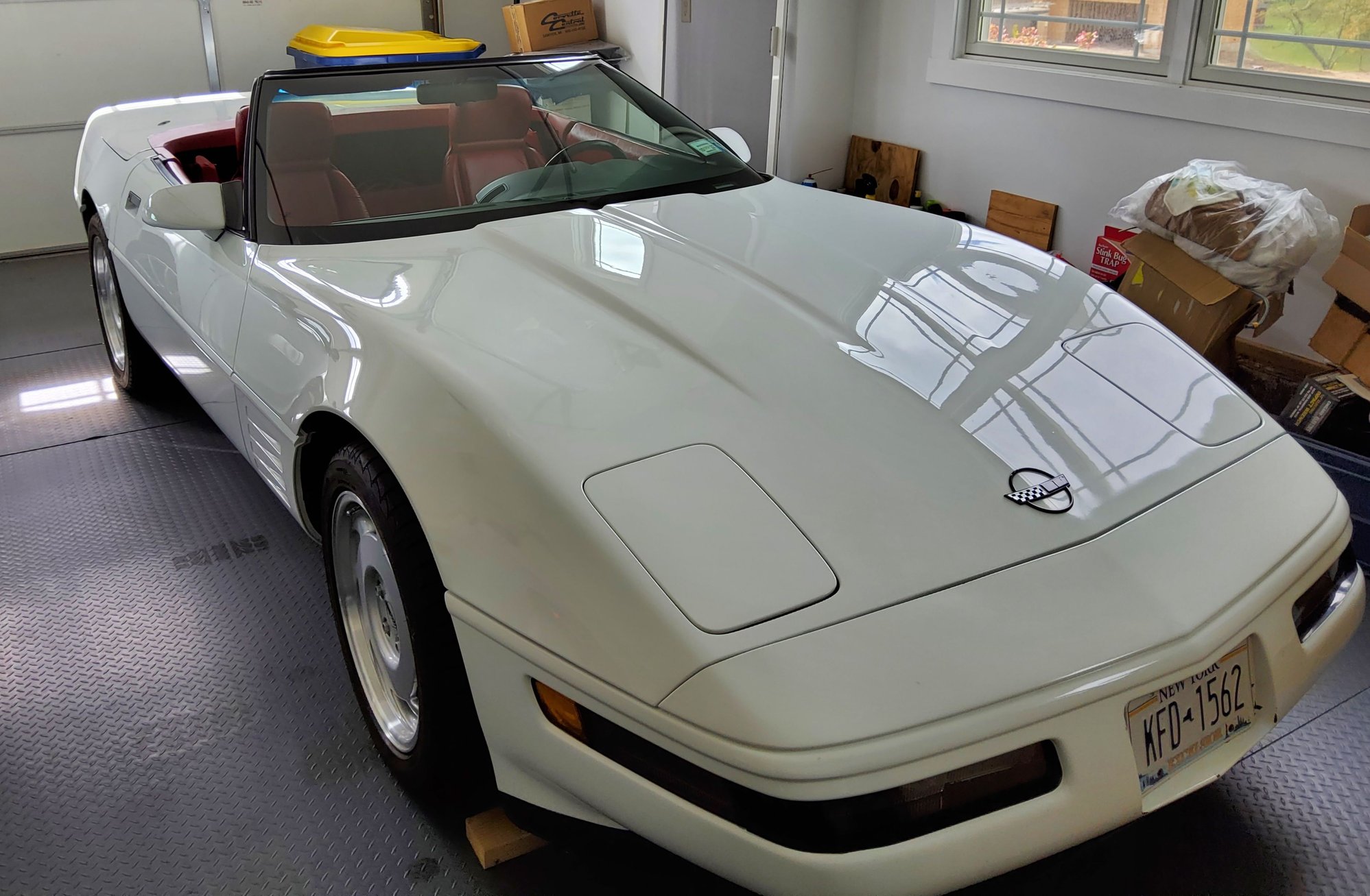

I have a '91 convertible that I drive only in the summer with about 16,000 miles on it. I bought it used when it was a year old, so it is mostly original. The fuel pump went last week and the car died and wouldn't start, which was bummer. I replaced the fuel pump, fuel filter, screen, sending unit all was pretty easy to do; then started it and it idled pretty rough and knocked on very low idle. So then, I then did a complete tune up with new dist cap, rotor, plugs and wires, but reused the old coil. But that didn't make much difference, it still idles rough. So now I'm scratching my head. The problem apprears fuel related, so is it possible that I need new fuel injectors? Or can it be something else? So before I go out and buy new injectors any advice will be appreciated. Here are a couple of photos of my car:

Oh and that car is beautiful. You don’t see many unmolested C4s anymore.

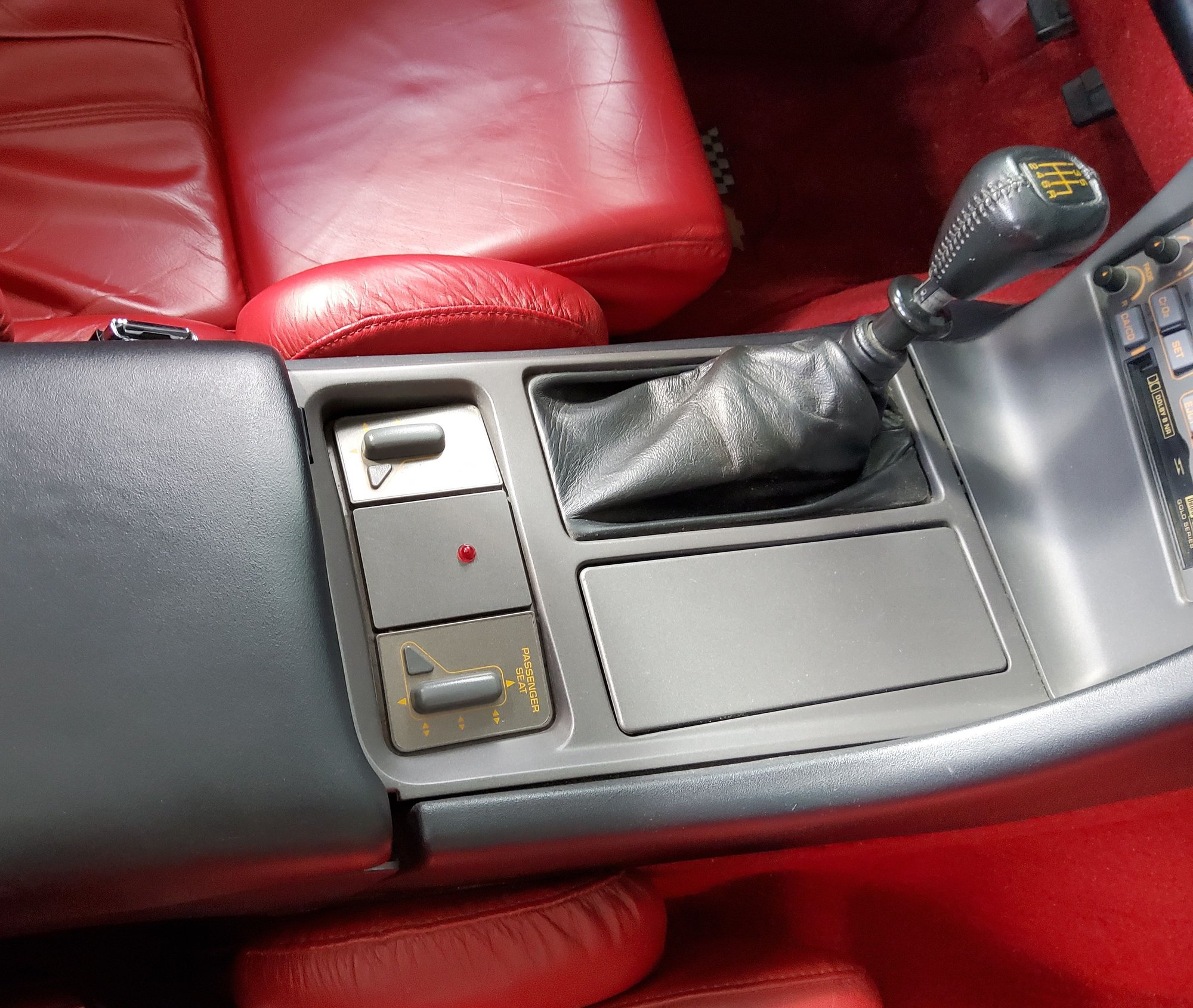

Thanks, I've had the car for 29 years and maybe had the top up 5 times. The top does have a one inch crack in it and was planning to replace the top, but figured why bother since I'd probably never use it. The guy I bought the car from had an after market alarm installed but I disconnected and removed most of it, so the only thing not orginal to the car is a piece of plastic trim that fits in between the power seat switches where they drilled a hole an put in a small red lense/light. I'd like to replace it but haven't been able to find a replacement part. I assume it snaps off and a new can be snapped on. See photo below:
