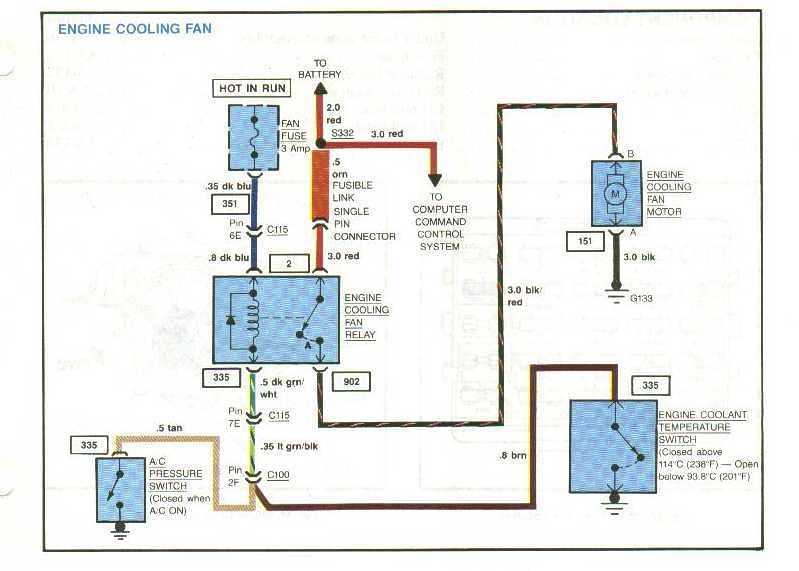

It is very simple. Just splice in a wire anywhere on the 355 route. Ground that wire thru your new switch. With the new wire grounded the fan will run when ignition is on.

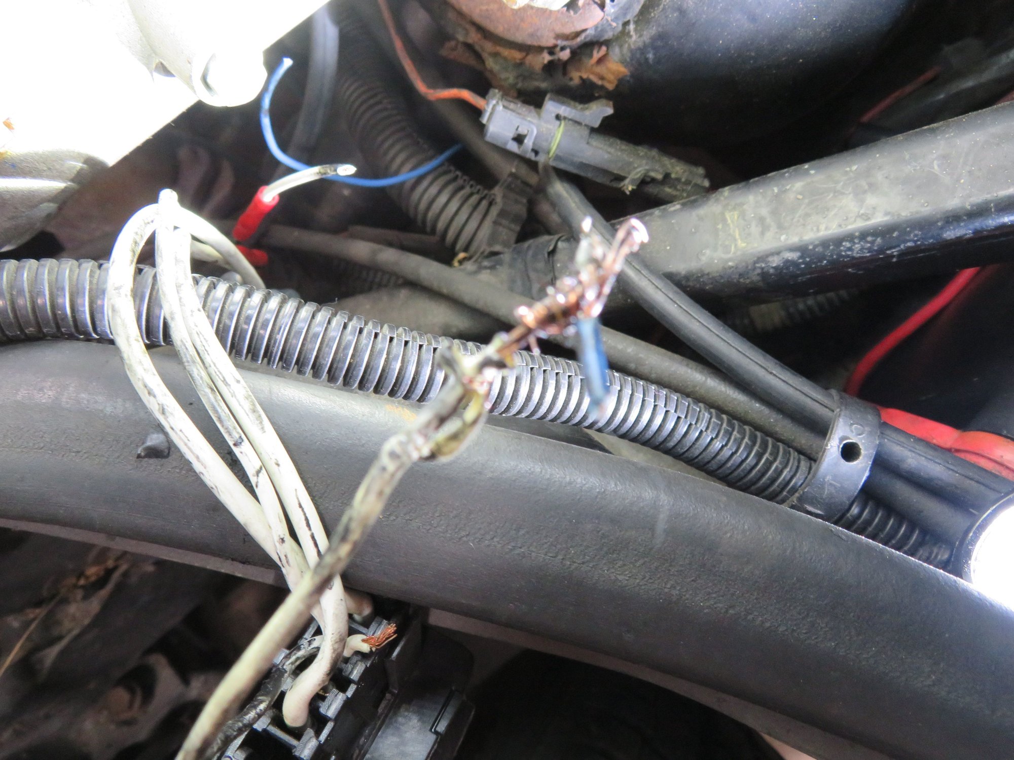

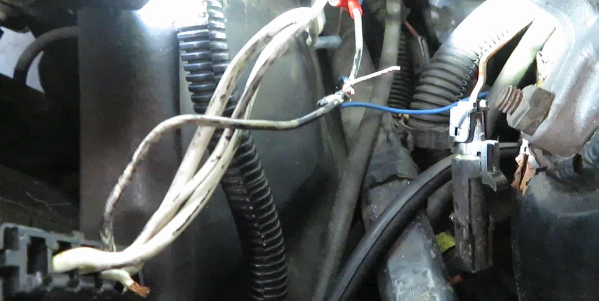

Oh, I do have a wiring mess with my coolant system....I bought this car about 3 weeks ago. I still love it but, I have a wiring mess to figure out? Somebody that didn't know what they were doing messed this up? first off, my temp gauge doesn't work? Does anyone know the color of the single wire on the driver side that goes to the temp gauge? Here's a picture of my relay....somebody ran all white wires? I think I have a blue wire that is in the wrong place? Hmmm....I have a pic and video and if anyone has time, please take a look and maybe point me in the correct direction?

OMG! Bubba has been hard at work on that one to improve on GMs wiring. GL with that mess. Buy a 84 GM FSM that will have all the diagrams you will need.

With Joby's diagram, you should be able to completely rewire correctly.
