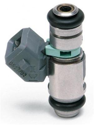

Is it me? Or do THESE INJECTORS look super short/small? Smaller injectors would be a big help, for a project I have going on....

1.857" overall height (end to end). Definitely shorter. Includes the notes in the specs "This is a replacement Pico fuel injector for an Edelbrock Pro-Flo EFI system"

I learned a few things. First, I/we need an injector with a "Jetronic" connector.
Second, the shortest injectors are 1 of two different injector body styles; "EV14" or "EV6/PICO". What ever that means. Anyway, I don't think there are any EV14 injectors made with a Jetronic connector, so that narrows it down to the EV6/PICO.
Unfortunately, there aren't many EV6/Jetronic 22 lb/hr injectors....at least not at Summit.

I would call the guys at South Bay Injectors as they sell shorter than stock Bosch injectors. They sell them for the C4 Corvettes and they work okay. I have a set in my C4 right now. They have a lot of parts there and tons of knowledge so they might be worth a call just to see what they have to offer you.
Just an idea to try and help you source the injector you seek!
