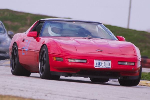

All that said, if you're intent on 11s, then EVILOPTI is right about the offset. I had two sets of 17x11 and one set of 18x11 for my 96 (front and rear). Here's what they looked like with 315 tires.
Replica A-mold 17x11 et50:
CCW Classics in 17x11 et50:
Forgestar CF5s in 18x11 et50:
