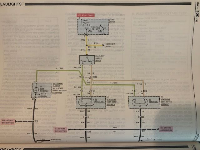

I have an 86 coupe. My right side headlight sometimes doesn't go on. They both flip up with no problem. I have checked the wiring. I wanted to know what the third relay does in the front driver's side does? I am assuming one is the left and the other is the right but; what does the third one do? Also, could someone tell me which one is the left and right?

The relays are in the headlight door circuit only and do not affect the lamps. The lamps are powered from the headlight switch to the dimmer switch to the lamps. They share the same power wire from the switch through the firewall and split to left and right under the hood. I would check the headlight and the socket. Check your ground wire also. Three wires go to the headlight. Low beam high beam and ground.
