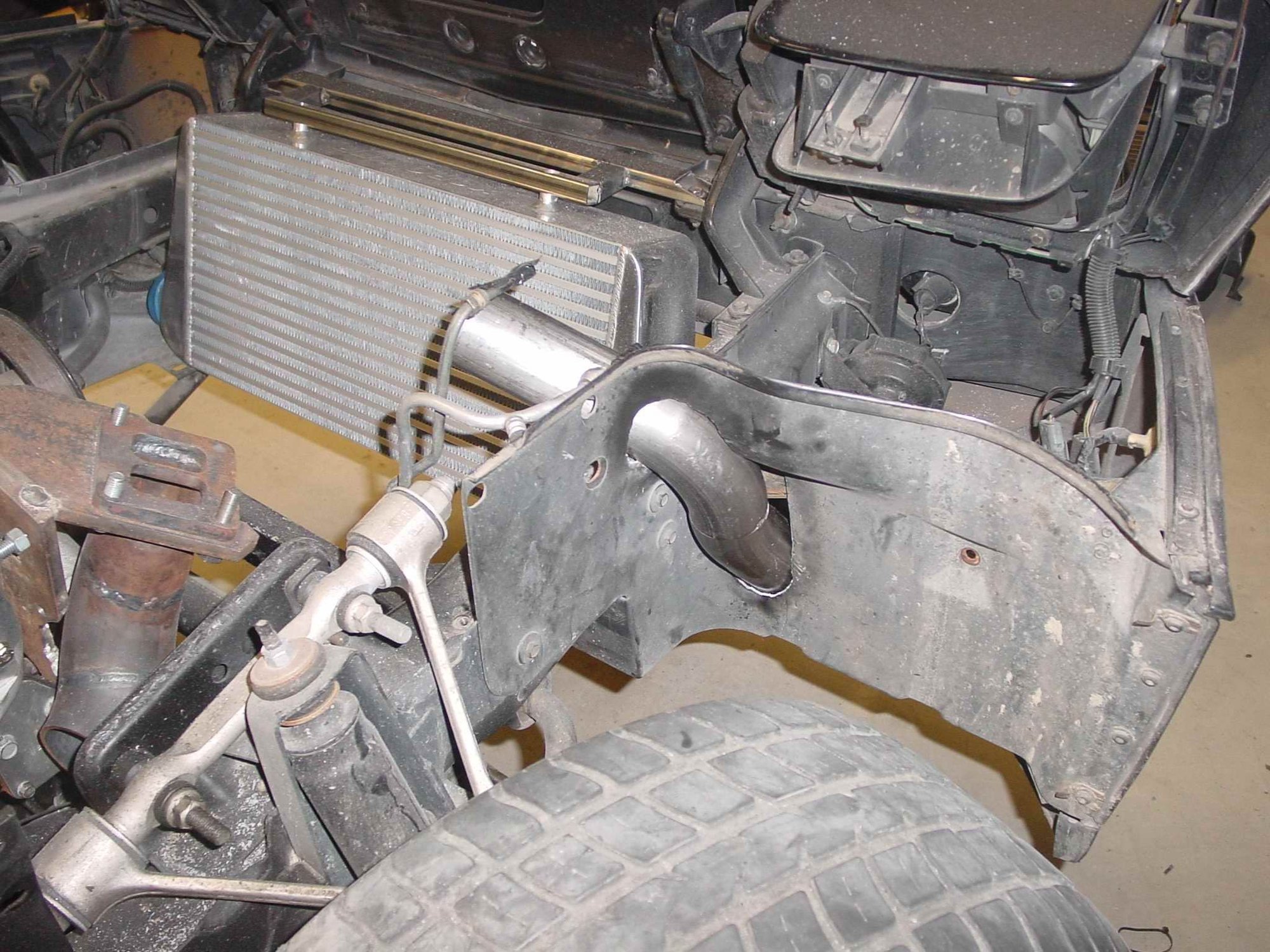

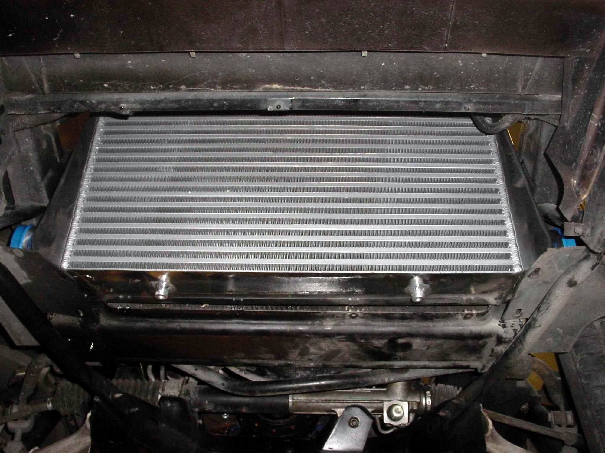

Old Oct 19, 2021 | 06:00 PM
JoBy's Avatar
JoBy
Posts: 2,149
Likes: 303
From: Timra, Sweden
A few pictures of my 1984 during fabrication. The core is 600mm x 300mm x 100mm ( 24" x 12" x 4" ).

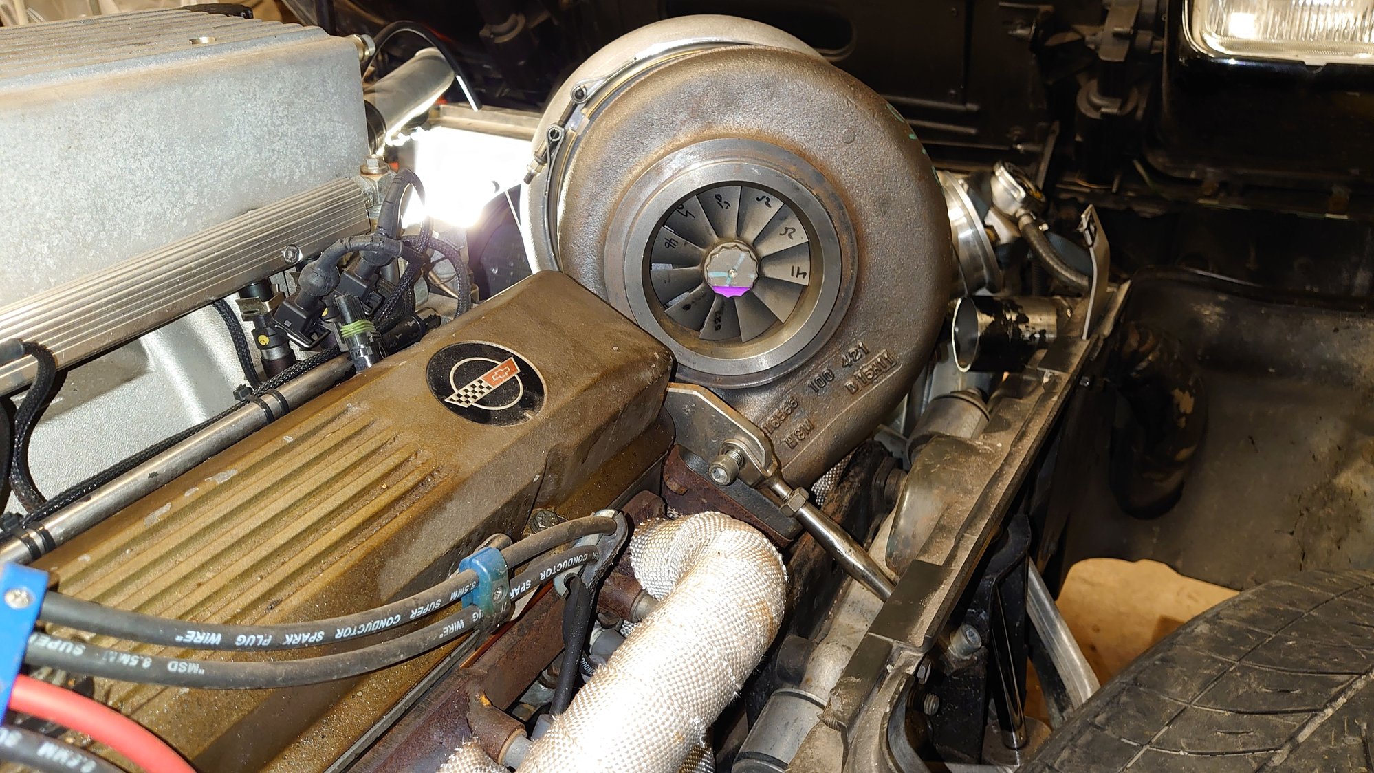

@JoBy Joby that's interesting, your intercooler piping is routed very similar to how mine is. (Not like there are a ton of options with the very limited room in a C4...) Looks like 3" pipe? I'm planning on changing the path of the piping on the passenger side. I like how your looks there a lot better than how I did mine. Does your car still have the factory coolant overflow tank in the stock location?
Old Oct 20, 2021 | 06:43 AM
JoBy's Avatar
JoBy
Posts: 2,149
Likes: 303
From: Timra, Sweden
Yes, but those pictures are over 16 years old.
Intercooler has 3" ports. Driver side to engine is 3". Pipe from turbo to intercooler increases from 2.5" to 3". I have bought my third tubro for the Corvette no, sizing up again. So I have to make a new pipe from turbo to intercooler.
I have installed a thicker all aluminum radiator and also lowered it to make room for a new radiator shroud with inlet ducting over the radiator. The Crossfire has a different radiator shroud with no space over the radiator and air ducting molded inte the hood.

Great pics, I was thinking the radiator on the first set of pics was very thin too, I figured you eventually upgraded
