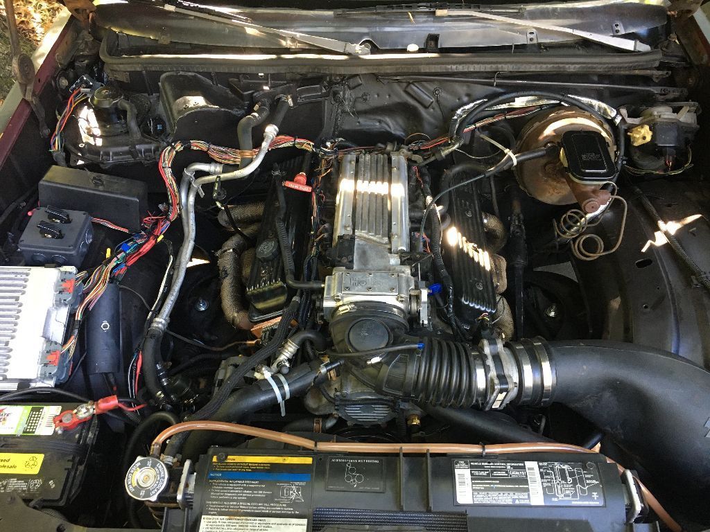

Yeah, let us know what you see on your's. BTW, what year is yours. I have a 96 LT1 Corvette and all the hoses are still in the stock configuration. I also have a 94 LT1 from an F body Z28 that currently lives in a 79 Malibu wagon. On that one I bypassed the TB and ran the steam pipe to the top of the radiator. We're using the Z28 radiator in the Malibu too so the fitting is there on the radiator tank.
We still have some finishing touches to do in this engine compartmant with covering and securing wiring and such. But in this pic you can see the hose from the steam pipe to the top of the rad on the passenger side. Anyway, different years and different platforms may have slightly different hose routing. There's B body, F Body and Corvette across the various years between 92-97 that were equipped with LT1 engine.
