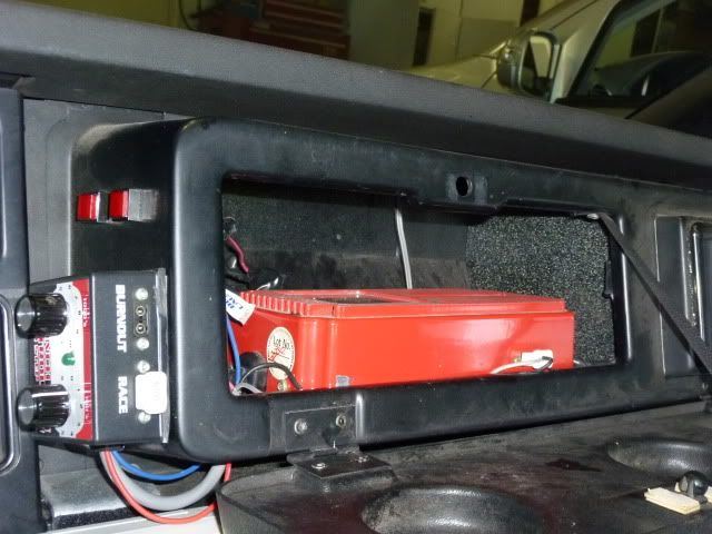

I put a 6AL in my 86 in the little cubby behind the drivers seat right above the ABS unit. Keeps it safe and dry. It has been working great there for the last 3 years.
