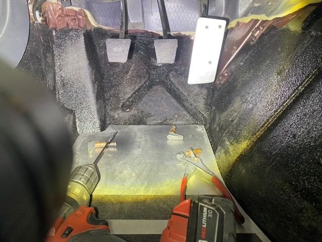

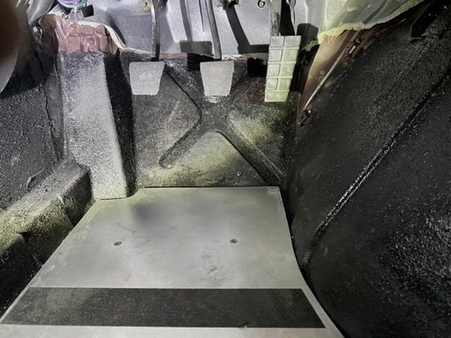

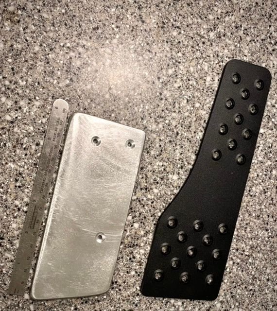

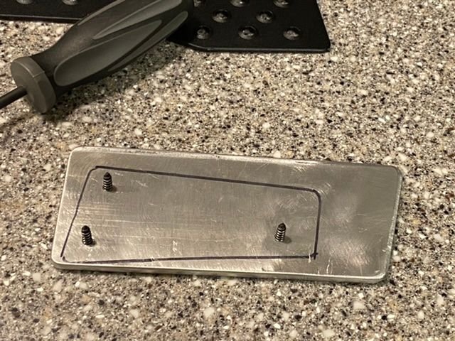

Old Aug 24, 2022 | 12:51 AM
AZSP33D's Avatar
AZSP33D
Joined: Jun 2020
Posts: 1,694
Likes: 728
From: Stay dangerous my friends
Took me a bit to get around to it but I made an improvement. The gas pedal is very flimsy relative to the pedal stalk, so I can’t say I’m very happy with it, but I can make it work now. Picture also compares the P951 gas pedal cover which is the same size as the Gas pedal on that car, hinge affixed to the floor along the bottom edge, and I’m mentioning it as heel toe on that car is very satisfying. So for the C4 I wanted to extend it inboard and further down. If you have carpet, it would need to be shorter at the bottom, because it almost hits the floor board as of right now. My thinking is that the ball of the foot should be on the brake pedal for best control/feel, and the right side of the foot and heel are rotated towards the gas to extend the heel towards the gas giving it a quick stab with the mid to lower section. Brake pedal is firm and brakes are very agressive so it takes some concentration to modulate accurately.
