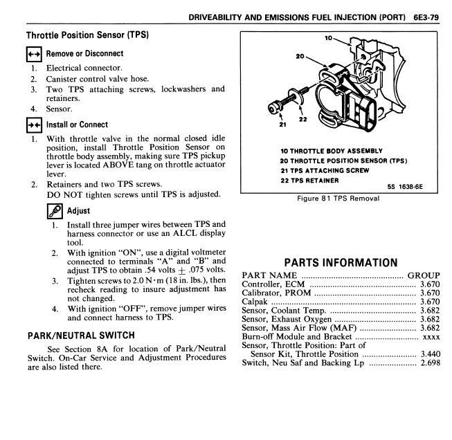

ive just got my car back from the garage ( been in since June with intermittent running issues ) they are resolved however I now have another issue with the idle when the car gets up to running temp. The revs at idle surge between 600rpm to 1200rpm ( roughly ) but is fine from cold. I unplugged the TPS and it idled better with no surging. I have ordered a new tps but when I change it do I need to position it a certain way? Thanks

Below s the procedure to adjust the TPS from my 1985 Corvette Factory Service Manual. You will need a Tech 1 scanner, or a voltmeter to adjust the TPS.
What other troubleshooting have you done? Are you sure the TPS is bad? Have you checked IAC valve?
Are you getting any DTC's?
