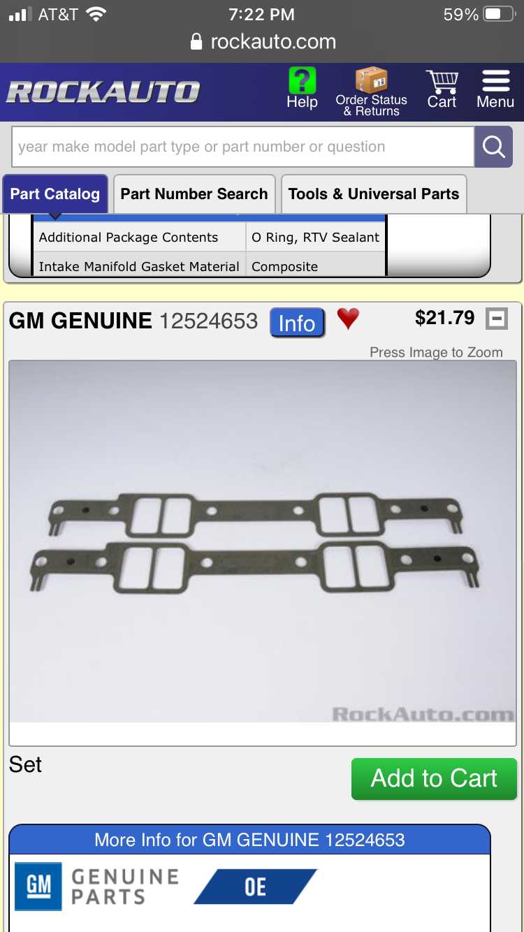

Fot the intake gaskets I prefer Genuine GM. They have locator pins that go in small holes that are in the heads. It keeps the gaskets properly positioned during installation. Any gaskets without these location pins have tendency to slide out of place.
