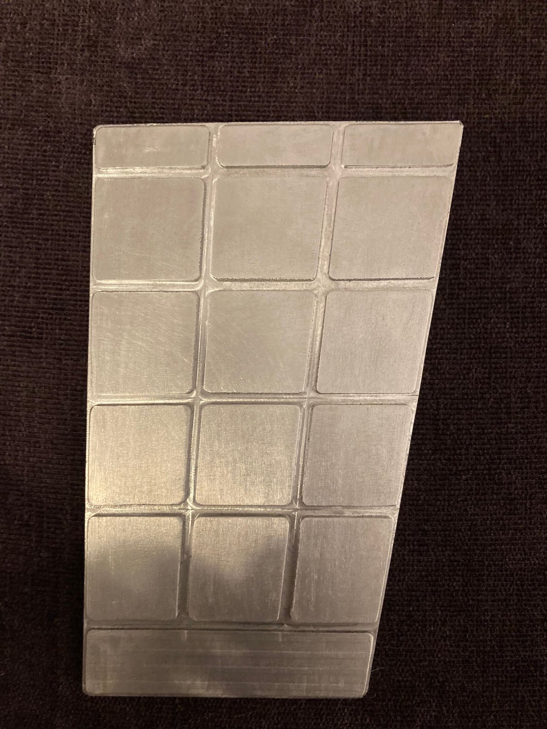

I’m trying to glue this on top of the pedal.
Here is a picture.
Hopefully it will make throttle blips while braking easier. I’ve used a gray seam sealer. it sticks well to aluminum, not sure for plastic though

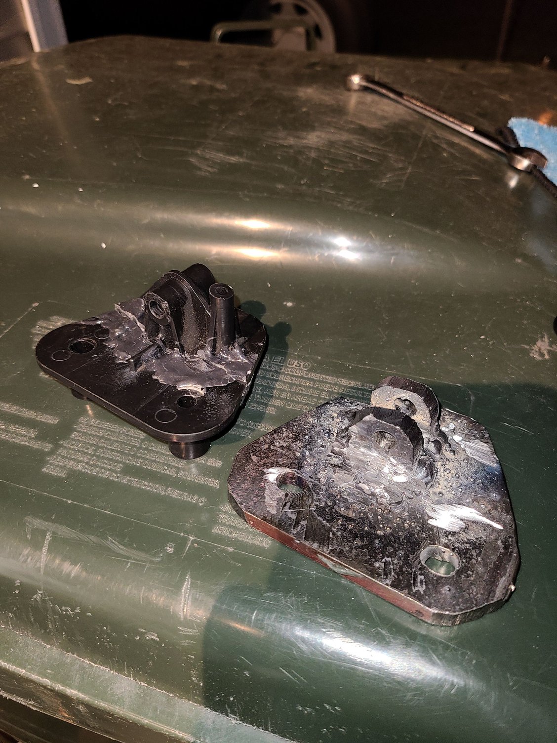

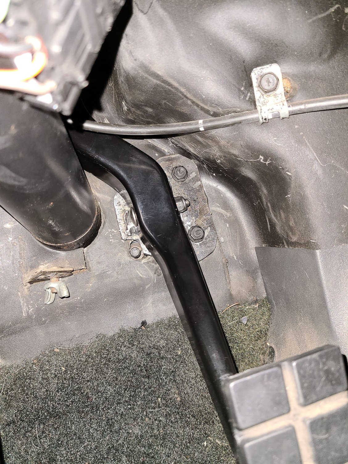

I’ve glued it on top of the stock pedal. Haven’t driven it yet because I’m working on the seat for some leather repairs, but I checked it and I can’t reach it with the heel. Pressing it with the ball of the foot may work, however, another problem I’ve noticed is the pedal mount is made of plastic and I’ve seen a guy than broke that mount. Now my pedal is offset to the left so it will create a greater stress on the mount if I don’t apply force aligned to the pedal arm
I’ll try to find a 3d model of a reinforced mount then build one from aluminium, alternatively a 3d print could be just fine if it is a stronger design.

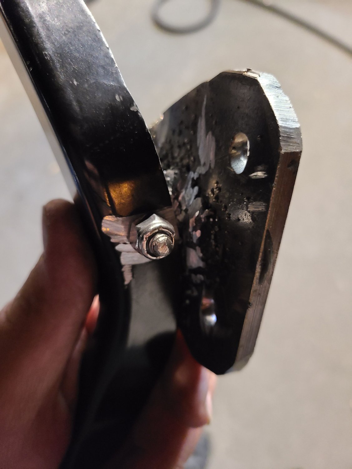

I built mine out of 3/16 plate. Worked well enough so far.
when you have time can you post a picture with yours?
thanks, your plate doesn’t seem to have the three legs at the bottom, I guess they are not absolutely necessary
I ran it without for a bit, but I eventually took some bushings and cut to height and installed them. All it did was move it out a bit and keep the sound deadening from being crushed. I'd probably use washers this time around to space it out. But definitely in my opinion use something.

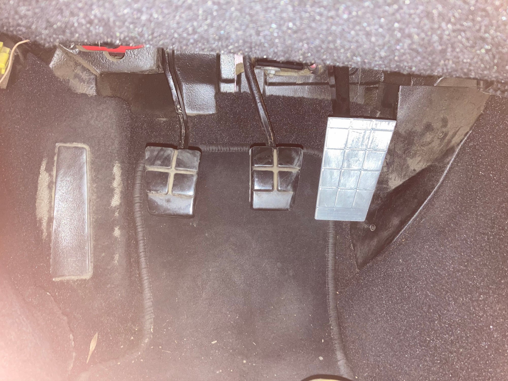

Here is a picture of the pedals
the pedals are a bit too close, I can blip the throttle easily now but when I brake I have to be careful not to hit the accelerator, this will get worse probably with more wear on the brake pads . Anyway, afaik many race cars have the pedals very close and they can be driven.
