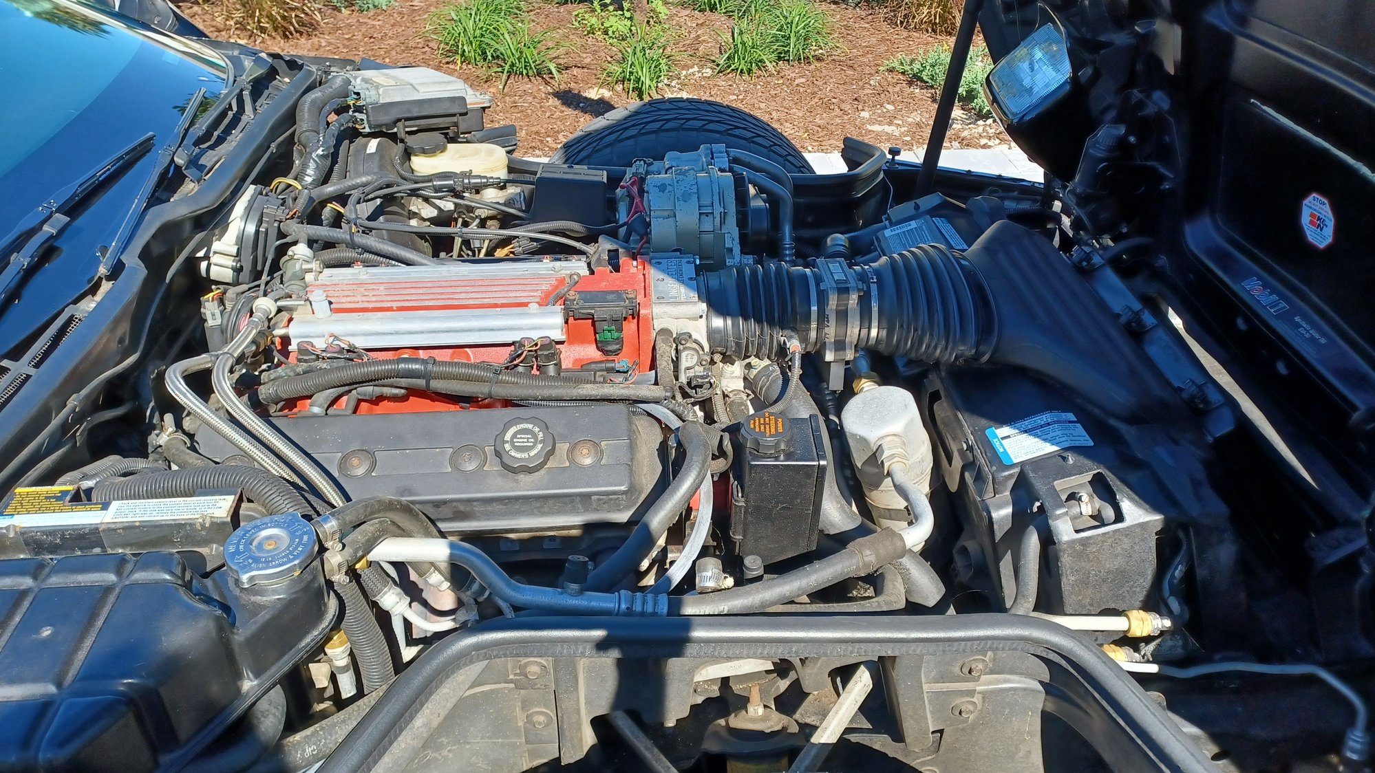

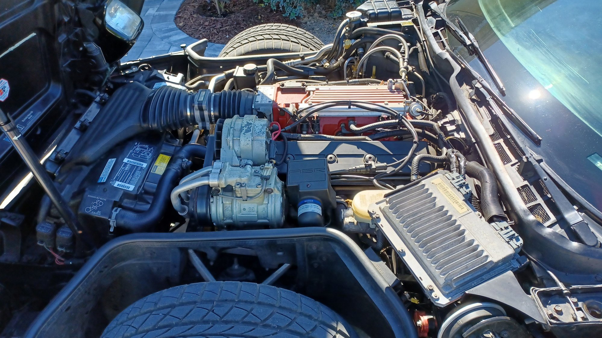

I'm still learning and I'm almost certain it's an LT4, but please prove me right or wrong by any means, LOL! If M6 means 6-speed manual, yes I do. Pics of engine bay here:

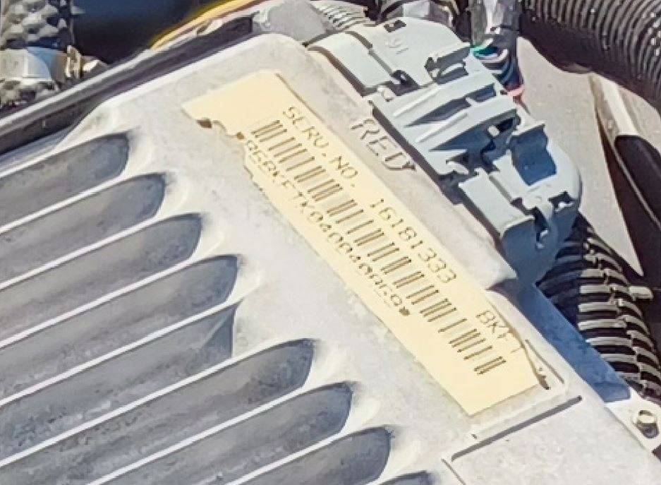

The label on the PCM says what? A snapshot of only that?

Best I got for now...

That is a '94 - '95 PCM using the label! Someone with maybe a similar engine swap can better answer your questions.
The car was originally an M6?
I can't suggest other diagnostics but someone will stop by mentioning 'software' - laptop and cables!
****Maybe yours is only an LT4 intake 'only' OR maybe cylinder heads and intake OR maybe as you mentioned 'engine swap'. I believe it could be manifold only or heads and other hardware.

Correct me if I'm wrong but LT4's don't use an EGR valve because of the cams duration and valve overlap.
That is correct, and therefore this is almost certainly not an LT4 swap (at least not a complete one). C-Cuatro, what made you think your car has an LT4 swapped in? If it's just the red intake, then be aware that any LT1 intake can be painted red, and I think a fair number of people did that.
Just a mix-mosh of suggestions, observations and such. I'm still learning, LOL! And thank you guys for pointing things out. I'm still trying to get some answers from one of the previous owners, one who was on these forums for a short time: Dr Boost who sold off the DRM stuff and pulled the original engine. I was told by his brother that he was preparing for a twin-turbo set-up and lost interest; ran NOS instead. I am told too that the engine that is in the car now was a fresh rebuild, but he hasn't been able to confirm my questions with his brother just yet. Hopefully I'll hear back.
