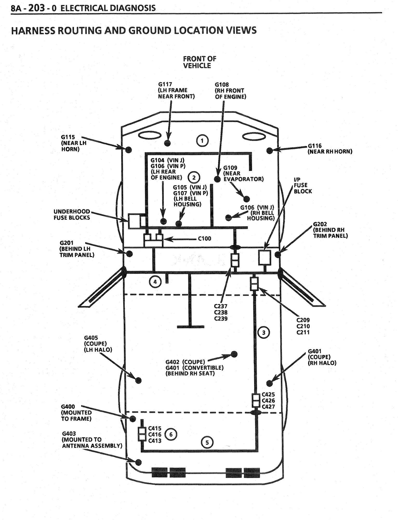

I'm having to rewire nearly my entire cabin. I don't know what, why or how but an electrical fire started behind the passenger seat. No real damage other than the carpeting and of course the wiring.
I nearly gutted the car 6 months ago with the intentions of rewiring the cabin as one project. Life happened tho and time passed.
I only just now was able to afford and find the exact interior wiring harness.
The thing is is I'm forgetting what-goes-where.
In searching I cannot find a detailed wiring manual for a 93 lt1.
Any help would be so much appreciated!

Did you buy some used harness(s) to attempt the fix or what? If you bought 'used' it certainly appears that unless a person was extremely talented it would need to be from only '93. Is the damage in the compartment and forward or compartment rearward towards tail of car!
Using links in the left click on my user ID and send me either a PM or an email. A PM including your email should work.
Where is the damage using this 'routing' and harness ID.
