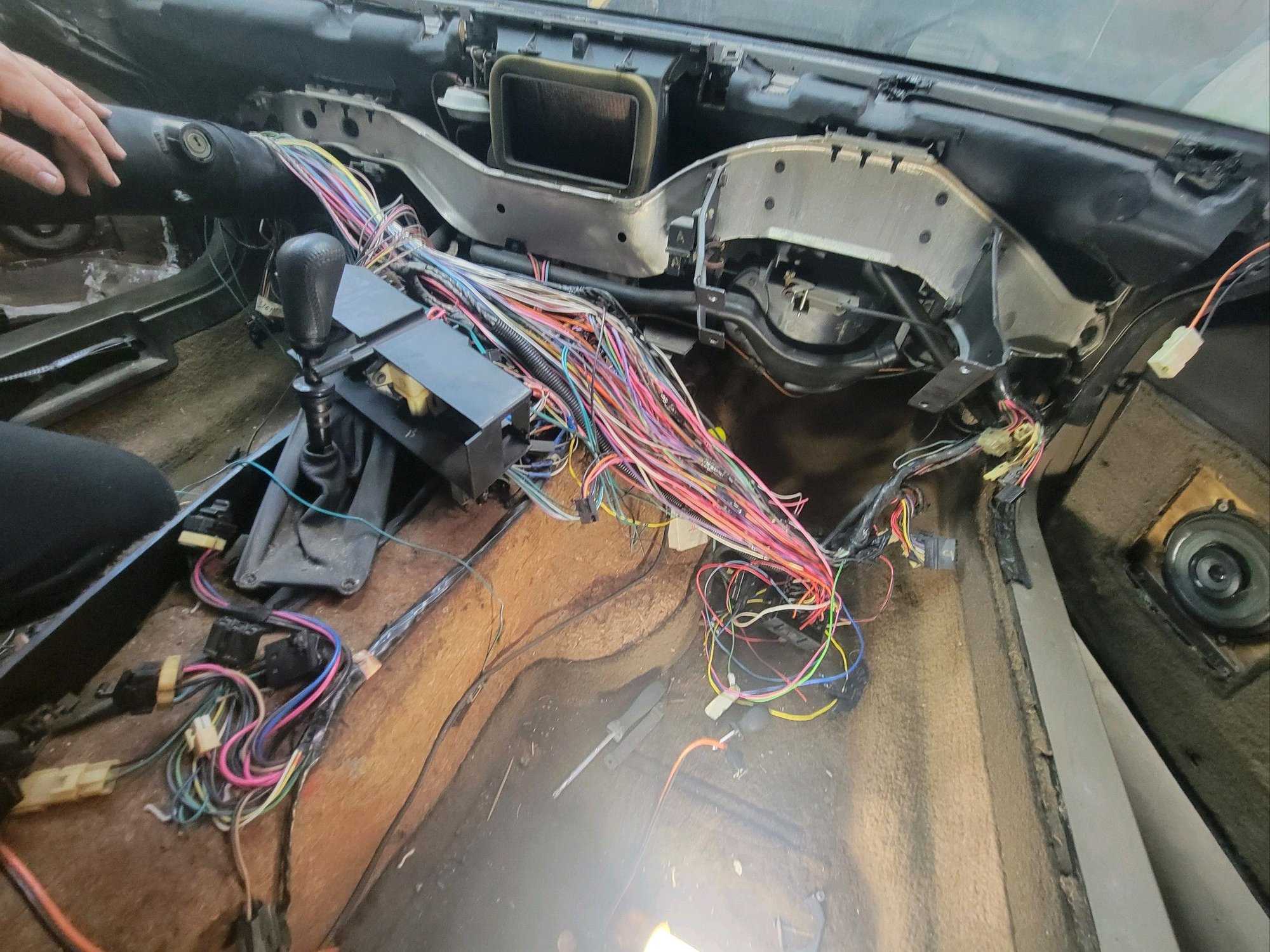

Any of you guys remove an interior harness. Iam stuck at the right door. Cant open that door all the way and have a feeling its difficult to pass that harness through the door. Need to check and re-wrap the harness. Someone messed with it.

Anyone have a pic of the harness routing so that i can see the correct placement.

If you disconnect all the connectors inside the door, take out the 2 screws holding the bellows to the car and door, you can pass the harness into the car. Its actually not too bad.
