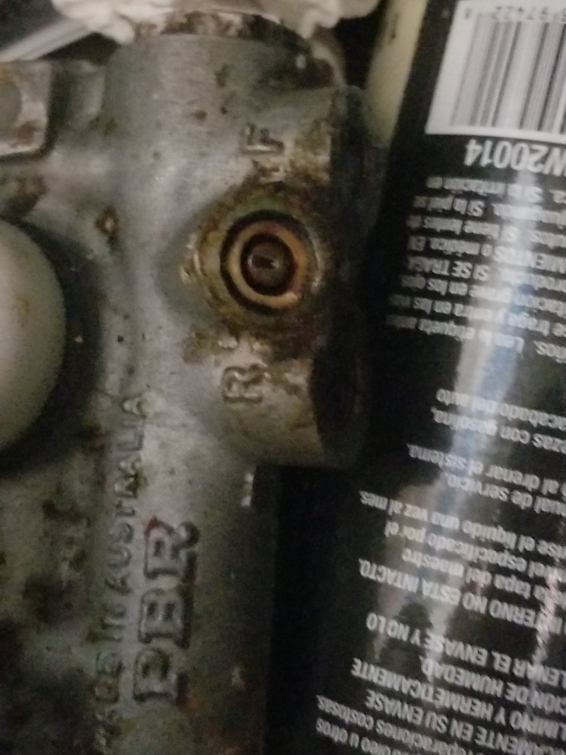

There is a hole in it so it shoots brake fluid out when you press on the pedal. Mine is broken off completely. I will be putting a plug in there. Excuse the bad pic, I took it while the master was in the garbage can lol

I believe if you're anticipating a plug you need to consider the thread depth. Maybe count threads in the master cylinder being installed and match that or maybe 1 thread less.
Yeah, unfortunately I already bench bled the new on and it's on the car but I have a plastic plug in it that I will use as my guide for the new plug.
