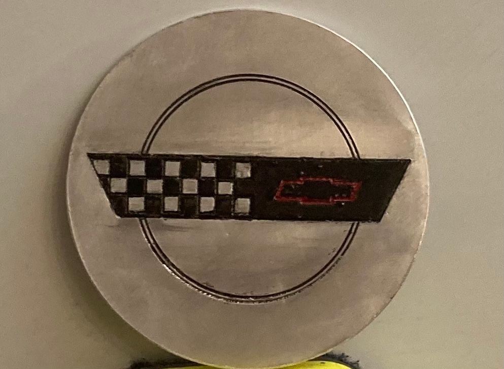

Here is an example of a wheel cap I made using cnc engraving and milling.
the aluminum is soft 1050, not the best finish but it’s ok, also I need to improve the painting techniques a bit.
The cnc software: vectric, uccnc; 2mm for the circle cut and 60deg bit engraving.
