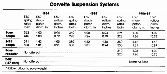

^^^ I agree, except coilovers is not required and not realistically possible on 84-87 C4s. Here's what I recommend:
  1. You can use any C4 rear leaf spring on your C4, so look at later base model C4 rear springs (should be code RR) and swap it in place of your stock one (like from a 95 or 96 C4). Even if your 85 is not a Z51, these springs are a lot softer. Since you nearly sit on top of the rear axle line, the rear stiffness has way more effect on ride comfort than the front. The rear spring is also super-easy to remove and replace, so this is the obvious first thing to do. You may want to substitute a slightly stiffer rear swaybar to maintain your handling balance, and again you can use any rear bar from any C4. If your car is a base model, then it should be a 20mm rear bar, and you could step up to a 22mm bar. Again, it's a very easy job.
  2. Up front, you can only interchange 84-87 leaf springs. If your car is a base 85, then there aren't any front springs that are much softer. If it is a Z51, then you could swap in a base model front spring from an 86-87 C4 (I don't have a good code for this one, sorry).
  3. Finally, you can get shocks that have less overall rebound and a more digressive rate curve, and which are adjustable for rebound rate. Shocks generally make an even bigger difference in ride quality than springs. The bad news is that the two shocks that will improve your ride the most are not super cheap, but they are high quality. I recommend either the Koni yellows or the Ridetech HQs. Both are adjustable, the Ridetechs are much easier to adjust in the rear. OTOH, you can sometimes find good used Konis on the Classified forum here for a lot less money.

Second, 1986 base corvette springs are the absolute softest of all the early cars👍🏼.
