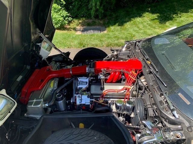

I've had my 1985 C4 Corvette for a little less than a year now and I've honestly had some issues with it here and there but I got those things fixed up and it was running well again but now, when I go to start up my car it won't idle at all. I've tried adjusting the TPS sensor, cleaning the TPS and now I'm going to be buying a new one because I think the TPS could just be faulty. I also replaced the IAC valve on the throttle body because I thought that was the first issue. Is there any other pieces I should check for that I could have missed? It's also starting to get colder where I live so maybe that is an issue? Thank you in advance if you have any advice though. Also here's some pics of the beauty.
