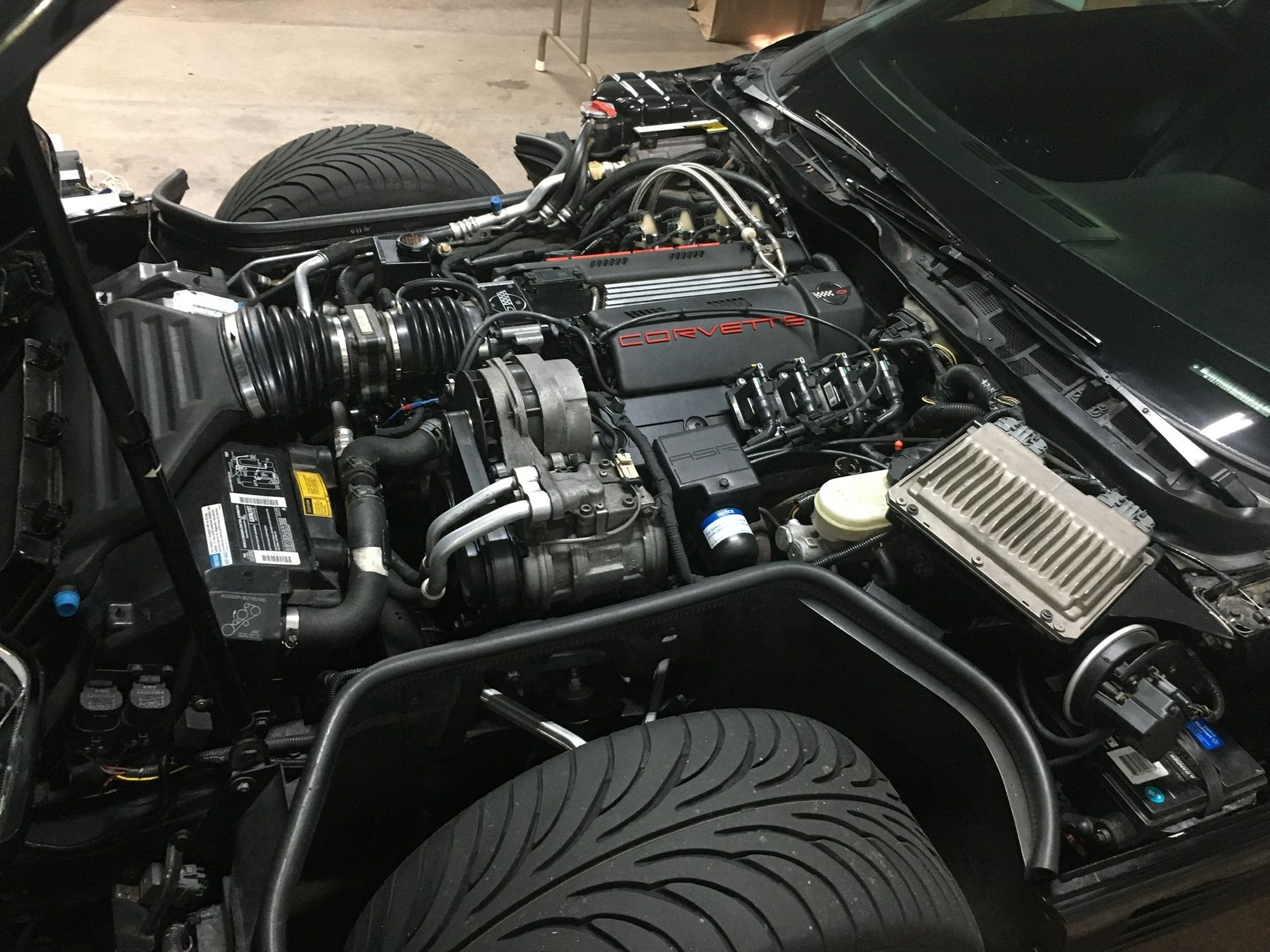

That's currently in progress. I mounted them to the valve covers initially, but i've changed my mind and will fab a rail to mount on top of the intake manifold. The LS valve covers were designed with the extra weight in mind, LT wasn't

There are tons of brackets available for LS1 coils. The hard part is finding where to mount to the car. I mounted it to the valve covers. I got extra OEM valve cover bolts and welded standoffs to them to then mount the coil brackets. Allowed for an OEM bolt to seal the rubber grommet while accommodating the bracket too and doesn’t require modification to the valve covers.

Yes, I could have been more clear— where and how to mount is my question. Great explanation of your solution!
I suppose I was hoping someone made a LS to LT bracket readymade.
