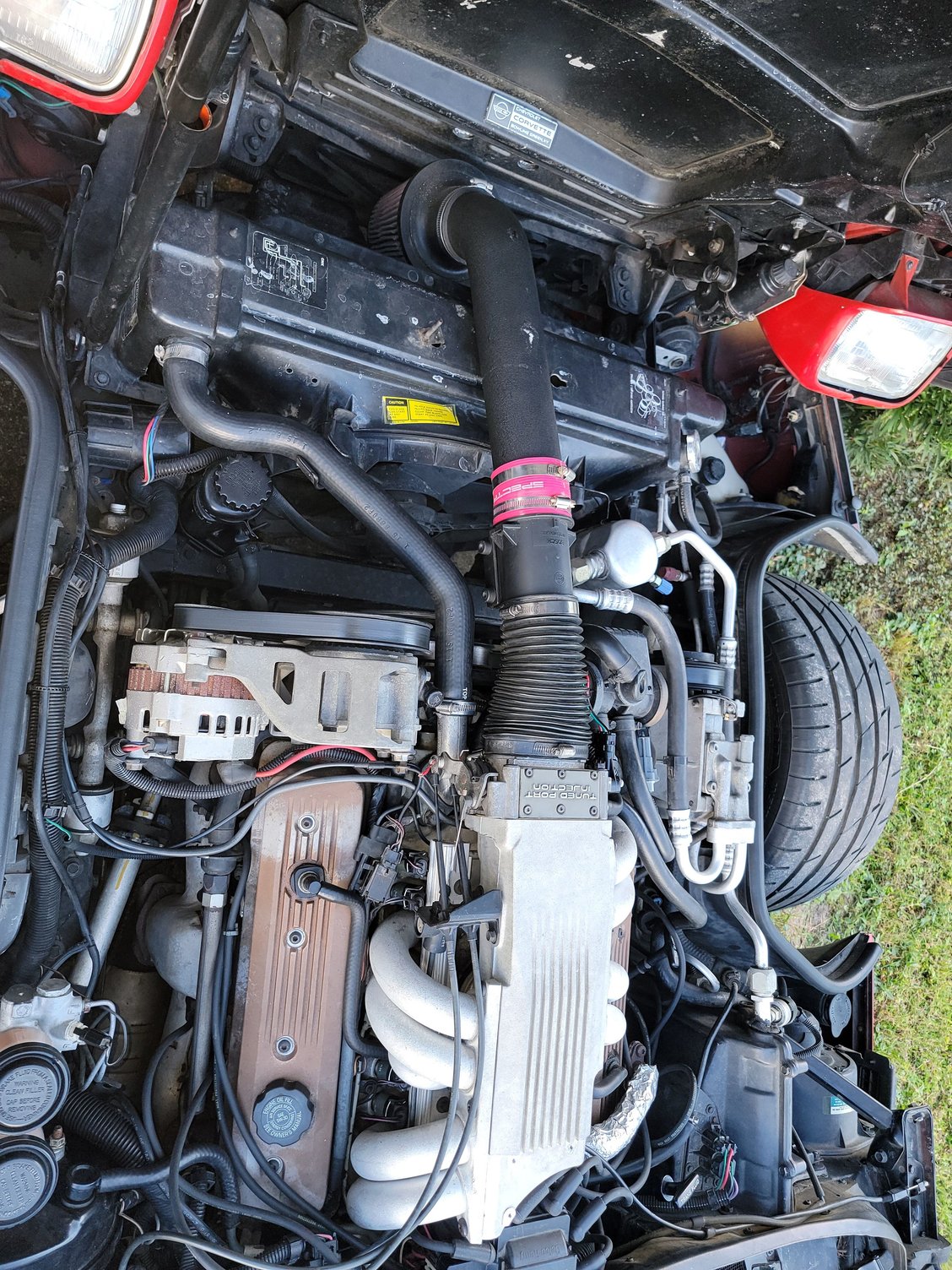

I've got an 88 corvette thats an automatic. It sat for a few months while i was fixing it up a bit. Got new plugs, wires, fuel pump, tps, air intake, distributor cap. Pulled a lot of sound damping out of the exhaust because it was completely plugged up. But now that it idles and drives, I've noticed that 1st gear is slacking hard. Theres little power to it. But 2nd and up are running excellent. When i got it, i could hit the gas and tires would spin. Now i hit the gas and it picks the rpms up slower. Theres no noise coming from transmission and it still shifts fine.
Would this be my transmission going out? I'll check my fluid tomorrow to see if thats it too. But what other problem could it be? Could it be my IAC? I pulled the old one out and installed a new one probably 8 months ago.

First of all I want to say that you have a beautiful Corvette there! I have the exact same spoiler but painted silver like my C4 is. Do you know who made them by chance?
BTW Welcome to the Corvette Forum! We are glad you are here and hope you learn lots while here!
The slacking of First Gear doesn't make too much sense to me. Can you describe the symptoms in a little more detail for us?
I too have a 1988 C4 and it has never really been able to spin it's tires even with the 3.07 rear axle ratio and a healthy L98. I have Pirelli Tires on it that are very sticky and that might be the reason. The car has never seemed like a power house in first gear to me anyway. I bought my C4 with almost 90k miles and my transmission was starting to slip a bit. I made a quick trip to the local AAMCO and $1400 later I had a rebuilt 700R4. The difference in performance from having the transmission rebuilt was pretty impressive. I would take your Corvette to a reputable transmission shop and have them evaluate your transmission for you.
The knock sensors in the C4's would sometimes get out of whack and trigger falsely. I had one that had failed and was keeping the timing retarded all the time because of knock sensor erroneously sending out false signals. To test the Knock Sensor just take a metal wrench and tap the cylinder head while the engine is running. The idle speed should drop a bit and then recover after the "tap".

Have you checked the basic setting on the throttle body and EFI system setup? The Throttle Position Sensor needs to be set precisely to get the idle to be smooth. Then clean and verify the Idle Air Control Valve is still working properly. There bis a lot more to setting the system up than most new owners are not aware of. I bought a set of harness' that allow me to see the parts in action in the EFI system. They were about $80 for the set but they make the set up a simple process.
These engine are designed to operate between 195 and 205* (F) so the temperatures you saw were normal. Clean under the radiator Cover between the Condenser and the Radiator. Be sure that you don't have more than 50% anti-freeze in the Corvettes Coolant. Too much anti-freeze is a bad thing as it doesn't transfer heat like water does. It sounds like your temperatures while running are okay.
Take pictures of the loose ends and we should be able to help you identify the parts. The FSM has a diagram showing each connector and identifying it. Having a set of the FSM's will make your life easier as it has troubleshooting charts and schematics of the various systems used in the C4.
I have never been much of a Side-pipes Guy but the system on your Corvette looks really great! I still have a scar from 40 years ago on a side pipe. They really look nice on your C4!
We are here to help you out so keep on with your questions and we will do our best to answer them quickly and correctly for you!
Be careful buying new Injectors unless you need them. The original ones were not able to handle Ethanol and by now they should have failed. When buying Fuel Injectors you buy them as a set of 8 and they can be had a reputable shops so please don't buy them on Ebay or Amazon. People on this Forum use FIC ( Fuel Injector Connection (??)) and I have used South Bay Injectors who are located in NYC. My last set was less than $200 for Bosch Brand Injectors which I trust.
One item that does wear out is the O2 sensor on the C4's. It was designed for a 24 month/50k life expectancy and then replaced. They are inexpensive and can have a huge effect on the Corvette if your is old and malfunctioning. You get better performance and Economy with a new Oxygen sensor.
I would have kept the Master Cylinder off your Corvette and had it rebuilt when convenient. Being a One year item they will get harder and harder to find. Finding a rebuilt 1988 Brake Master Cylinder might get tough in a few years... The booster is a common item but the master cylinder you should have kept.
The auto parts stores will sometimes lend things like the fuel pressure tester, get one and let us know what you find. Having the gauge on a long hose allows you to tape it to the windshield if you are having things happen while driving. Have you found anyone with a scanner that works on OBD1?
