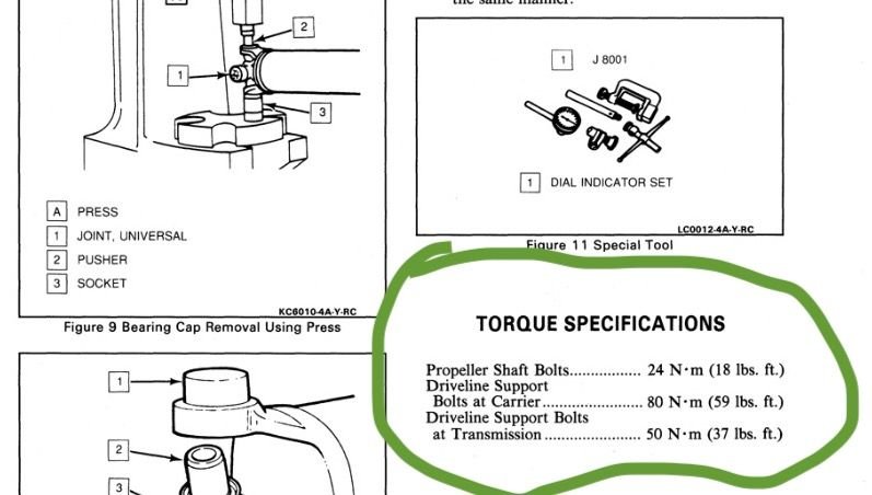

Anyway, I'm gonna check that beam first but not sure about torque. Can somebody double check me on it, please?

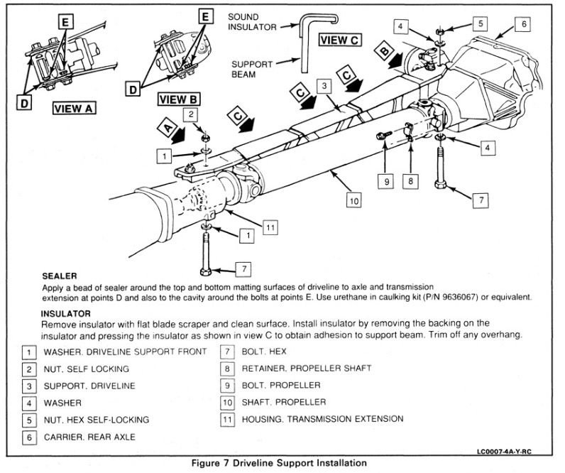

From the diagram it looks like 37 lbs. ft. on 7 on all four bolts. Or is it 37 lbs. ft. on the front two bolts and 59 lbs. ft. on the two rear bolts?
I don't have those aftermarket plates. I might pick them up at some point but I just wanna check the torque on those bolts for now.
Thanks.

With the specs. Your showing simply testing with a wrench would be possible if it moves it's loose which means to do the spec. Torque or bump it up a bit
. I wouldnt get to lost worring about getting that perfect torque it is a Robust area

37 at the transmission housing and 59 at the differential

Yeah, I just wanna get it as close as I can, honestly. Without new adhesive it'll likely loosen again over time anyway.

Thanks! Always good to have a second set of eyes. Might get it up and put a wrench on it today.

The nuts are locking nuts, so they wont just loosen up on their own, unless someone replaced them with non locking types.
And for the adhesive, as far as i remember it is so the parts dont corrode together due to dissimilar metals and water. Could be wrong, but i believe thats its main purpose.

Be aware the holes in the beam can get elongated ( esp stick cars ) allowing some movement even when the bolts are tight.
The beam plates as well as being very convenient , spread the clamping force over a much wider area instead of just under the bolt head.
