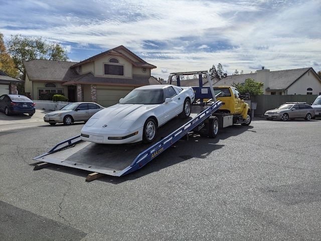

Obligatory Car Picture:

Looks like a nice car, though.
