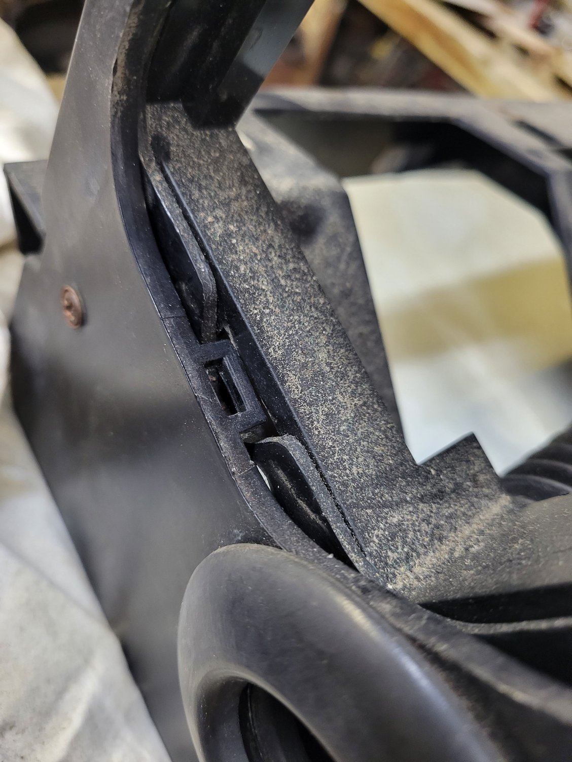

The bezel is hitting the fuse housing. What am i missing here?

normal

When we had a customers that would complain about a rattle from fuse cover we would put a thin foam rubber or felt tape there. The furry side of velcro works well to cut to fit.
