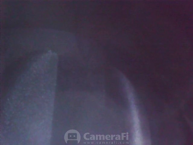

Default Pic
Here is a pic I took with a scope
Looks similar to these but hard to tell.

Default Stock
I found a pic on this site. Stock 84. This is what i have. 9:1
That is NOT the stock 1984 piston.
