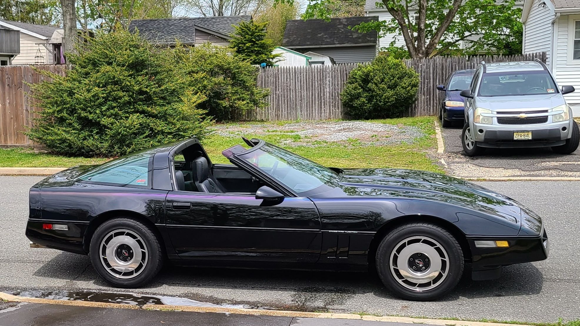

Here's an '86 wheel with about 6 hours of work in it (not the best pic....sorry). As mentioned, they don't take much effort to bring out a shine.
