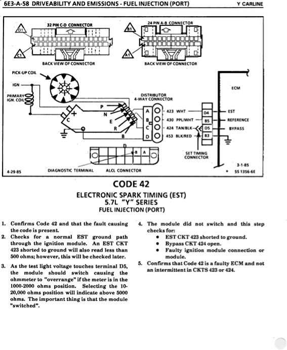

Not sure what year/model you've got, but here's the code 42 description and troubleshooting chart for a 1990 L98.

So, first things first. You were absolutely right. The ECM memory is what I had unplugged. The EST connector had been cut from the connector by a previous owner with both ends spliced together. I have since gone through the checks from the service manual for code 42. More info below. Thank you for your help!

Thank you so much for your help. I managed to find what I needed by googling CKT 423 but again I appreciate your help!

So today I went through the checks for code 42. I started with clearing the ECM by disconnecting the battery, once I fired up the car I got the code 42.
- Next I disconnected and removed the ECM to follow the next steps, I received no power from CKT 423 or Port D4 on the 32 pin connector.
-I then verified that I was receiving power from CKT 424 or Port D5 (tan and black EST wire) which seemed okay.
After some more troubleshooting I came to find out that there was no wire plugged into port D4 powering port A on the distributor terminal connector.
- First and most obvious question, this was obviously removed by somebody maybe inadvertently correct?
- Second, could I route a wire from the ECM connector and solder it to the Distributor Terminal Connector that leads to the ICM without any issues? How is this connector powered?
- Third, would there be a reason for someone to pull that wire? My conclusion is no, because it would immediately set off the code 42.
Thank you everyone for all of your help. You kindness and experience are much appreciated. Looking forward to reading any responses!
UPDATE: I may have been using the wrong wiring diagram smh
Gonna try again tomorrow before I hard wire anything.

This looks right for an 85 no?

I ran through the diagnostics, confirmed the ECM had a fault and replaced it today. No more codes. Thank you everyone. Anyone needing assistance with Code 42 EST feel free to comment or leave a PM, I'd be happy to help.
