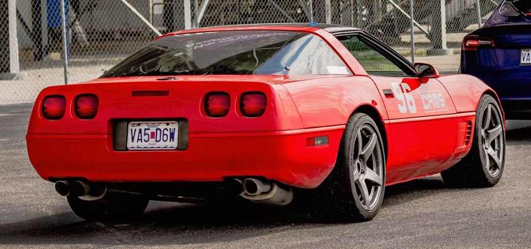

To give you a visual of what I'm talking about, here is my 96 with 315 tires on 11" wheels with 50mm offset:
If the tires stick out any more than that, you start to risk rubbing on the fender edges. For your early Vette, the only difference is that the hubs are about 3/4" inward from mine. So these same wheels and tires I used would sit inward about 3/4" further on your car, and they would rub/hit things on the inside. So to get this same placement on your car with the same wheels and tires, you'd need the 3/4 spacer. If you could find 11" wheels with an offset of 32-36mm, they would fit like this without using any spacers.
For the 8.5" wheels (with either 245mm or 255mm tires, I assume), you have a lot more "wiggle room". But to look proper, I'd still suggest shooting for the factory's 32mm net offset spec.
