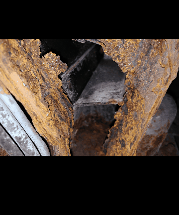

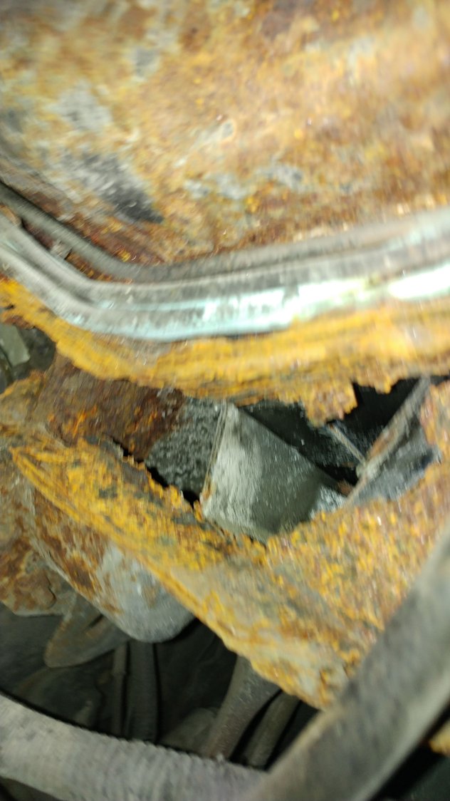

Old Jan 28, 2022 | 02:22 PM
s carter's Avatar
s carter
Joined: May 2014
Posts: 2,891
Likes: 591
From: New Port Richey FL
You mean like this
It was so bad I took it off the road sold it for parts to a guy who put Driveline in a spare track car for practice laps.
. Don't get a car that started life in Wisconsin worked it way through Michigan taking a 12 year stop there before a final stop in Florida
Old Jan 28, 2022 | 03:40 PM
VikingTrad3r's Avatar
VikingTrad3r
Oil Producer
Joined: Apr 2014
Posts: 9,365
Likes: 2,734
WOW. ive never seen one so bad as that!!!!!!!
i wouldnt have even guessed it would be possible.
I have read different things about different portions of the steel being galvanized
