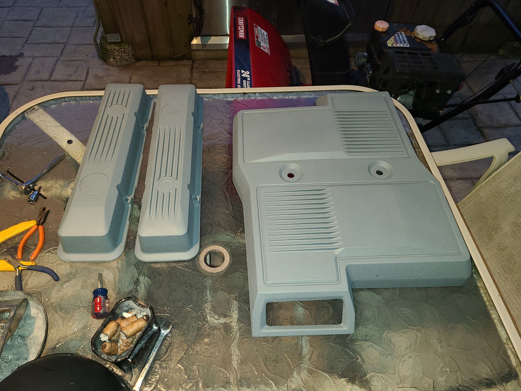

I sprayed them. The texture is good. Not 100% on the color yet but it's better than the regular Nickel paint..
