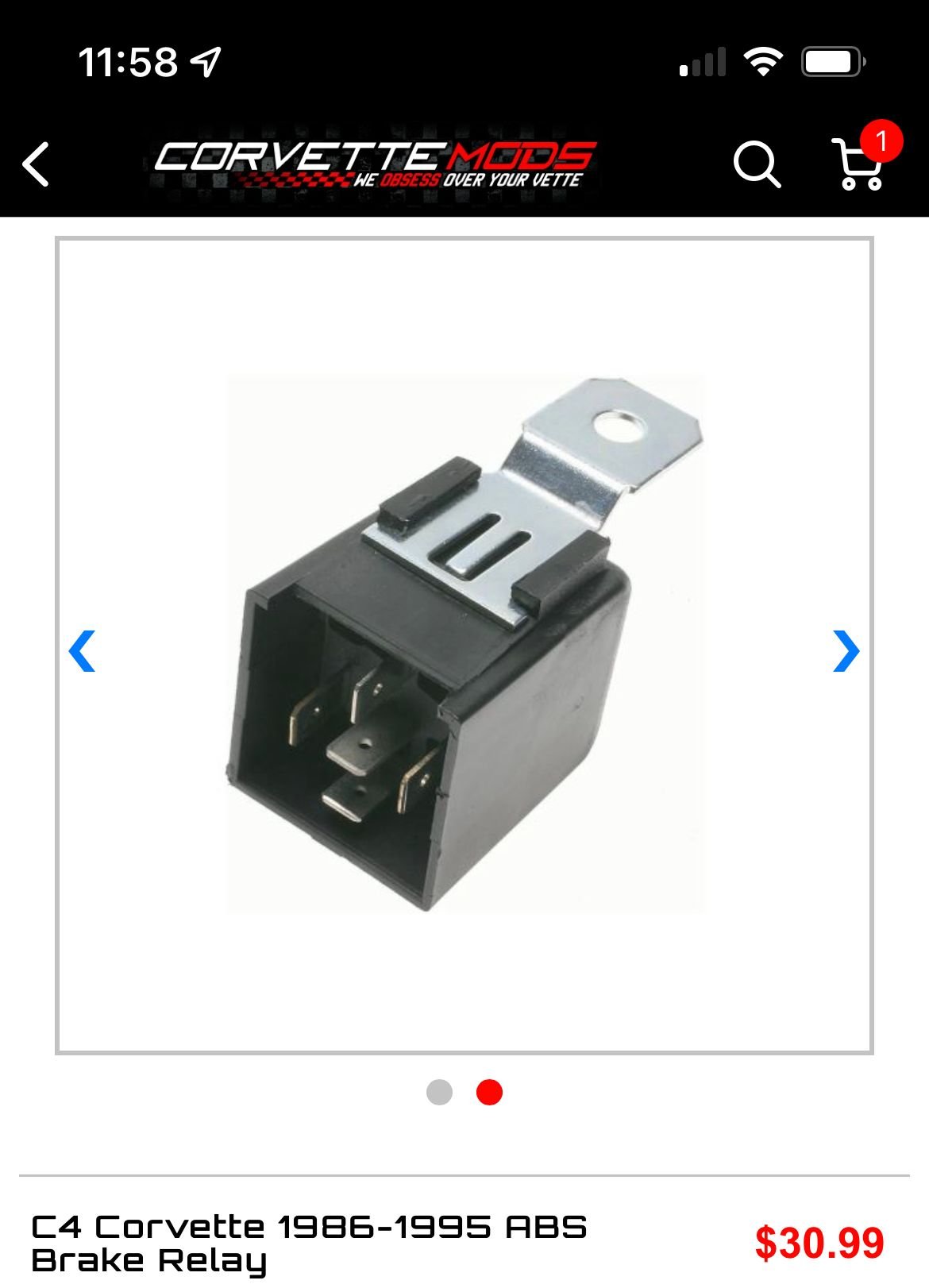

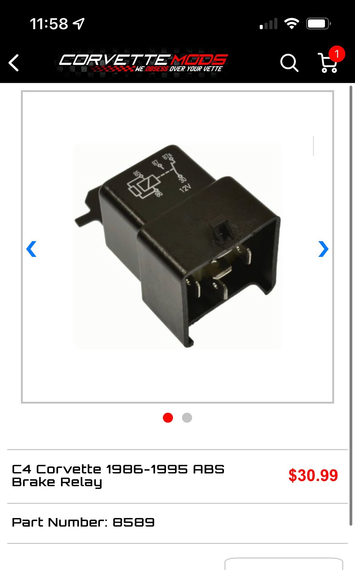

Hello, new newbie c4 owner, first car as well. I recently bought a brake relay (pictured) instead of the correct anti lock relay (relay in compartment behind driver by brake pump if I’m correct?) Does anyone have an idea where the relay below goes and it’s specific function in relation to the brakes? Any help would be appreciated

I believe the 'consensus of opinion' in the C4 Section for sure is to avoid a purchase of anything from that vendor! I never have and do all purchases 'local' or if necessary after much research from a 'known reliable source'! That vendor is NOT a 'known reliable source'!
Have you already purchased or what? If you haven't DO NOT
If you're interested in help, mention year of car and pertinent information for your car and the part requested.

I have, it’s a 86, I can still probably return it, just would be easier if I didn’t have too.

It won't do what you wanted so you could try this: Ask them to give you the OE/GM part # that it replaces. They do reference GM #'s to theirs for most of their products. Your purchase is a very 'generic' relay that will do 'NOTHING' for your '86. The relay you've posted from them can be purchased locally for probably 'one half' of their ask maybe less.
If you paid by Credit Card - 'dispute the charge'!!!!
