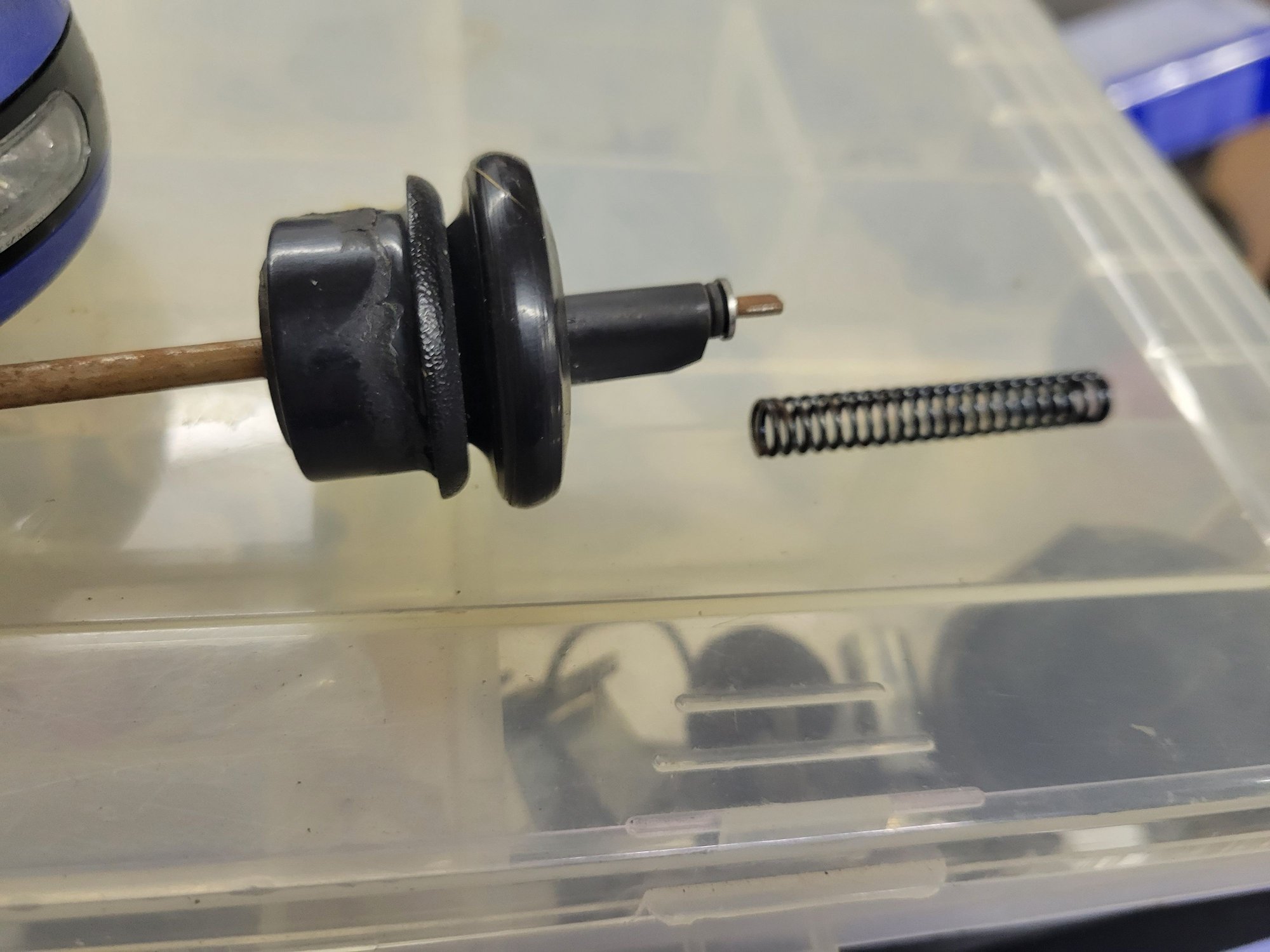

Default Reverse
Also, how does that reverse lockout work. I think mine is broken or missing parts

I looked in the parts catalog and you may be missing a clip that goes on top of the spring. I don't recall seeing a clip when I took mine apart, and I've pulled that spring all the way out, before figuring out that I didn't need it to come out like that. I've never had it apart like that. It just permits a gate to open up in the shifter body to allow the shifter selector to move into the reverse slider. I found that if I didn't put the reverse selector back together properly, it was WAY too simple to select reverse when shifting from any gear to 1.
