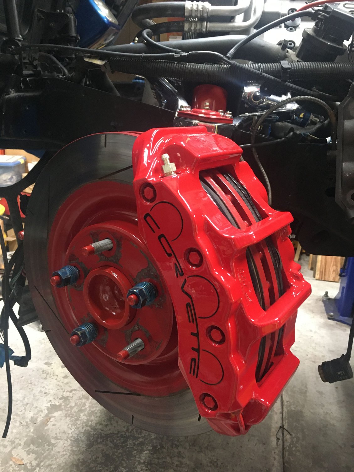

You can convert your C4 to C6 Z06 brakes. I also added DRM s/s caliper pistons and DBA 5000 2 piece rotors.
Front:
Rear with C6 parking brake

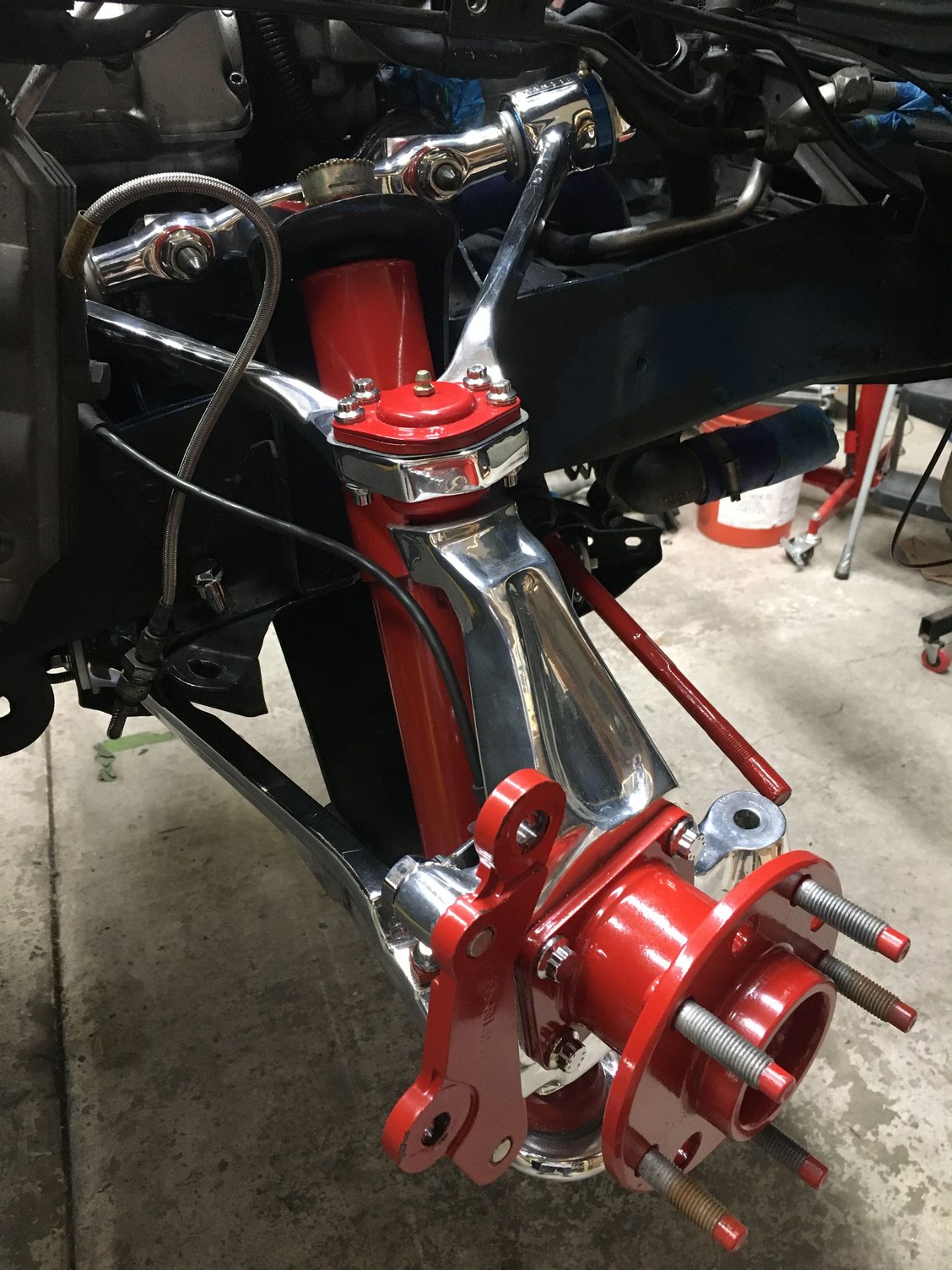

what you need is a Vansteel adapter bracket to mount the front calipers and some generic s/s brake hoses with some adapter fittings.
in the rear you use the C4 to C6 Z06 conversion hub by Street shop Inc. Which allows you to use a C6 internal drum parking brake and mount C6 Z06 rotors and calipers you will also need a lokar e-brake cable.
you have to call street shop Inc to get the hub as it's not on their website.

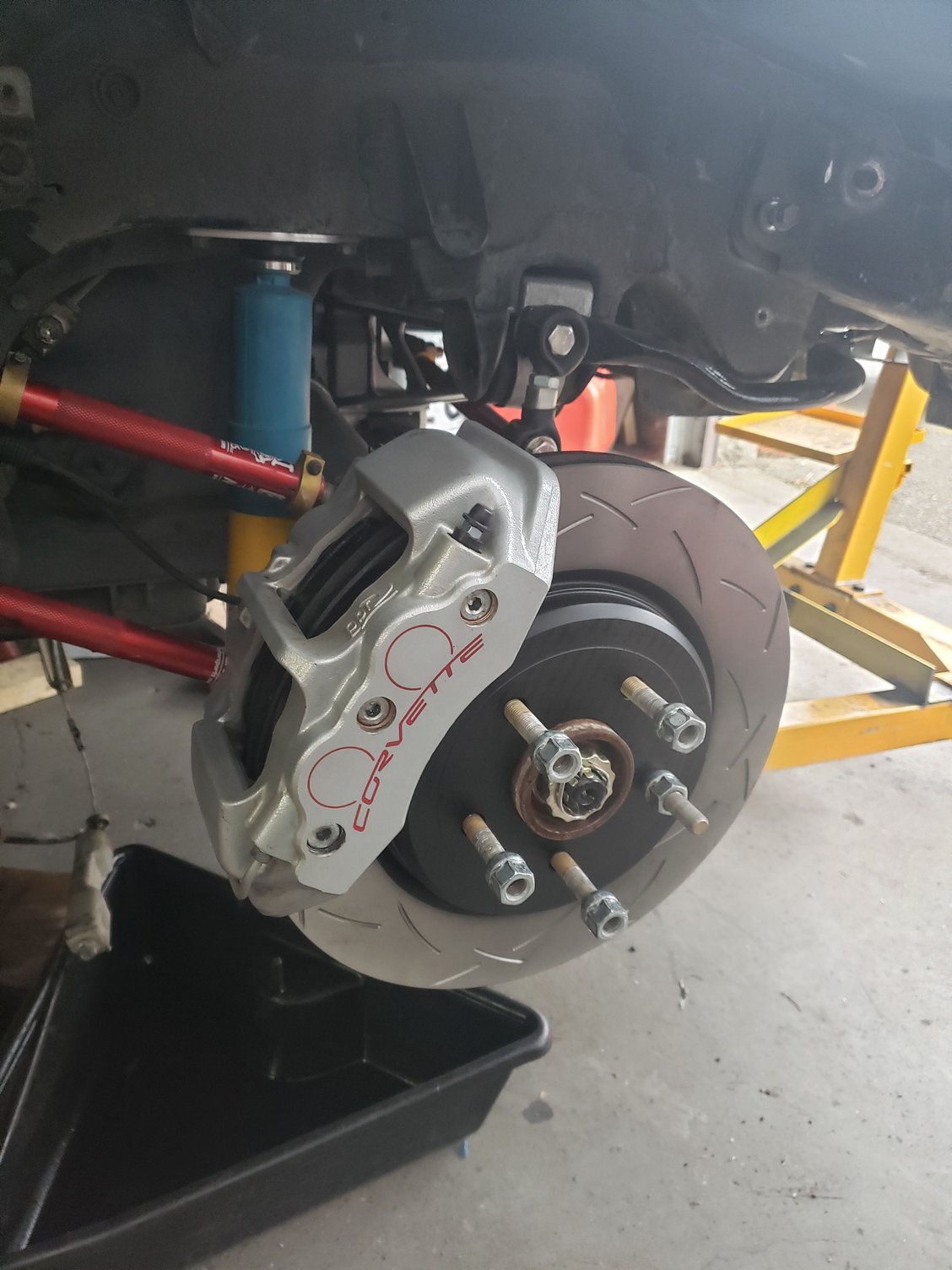

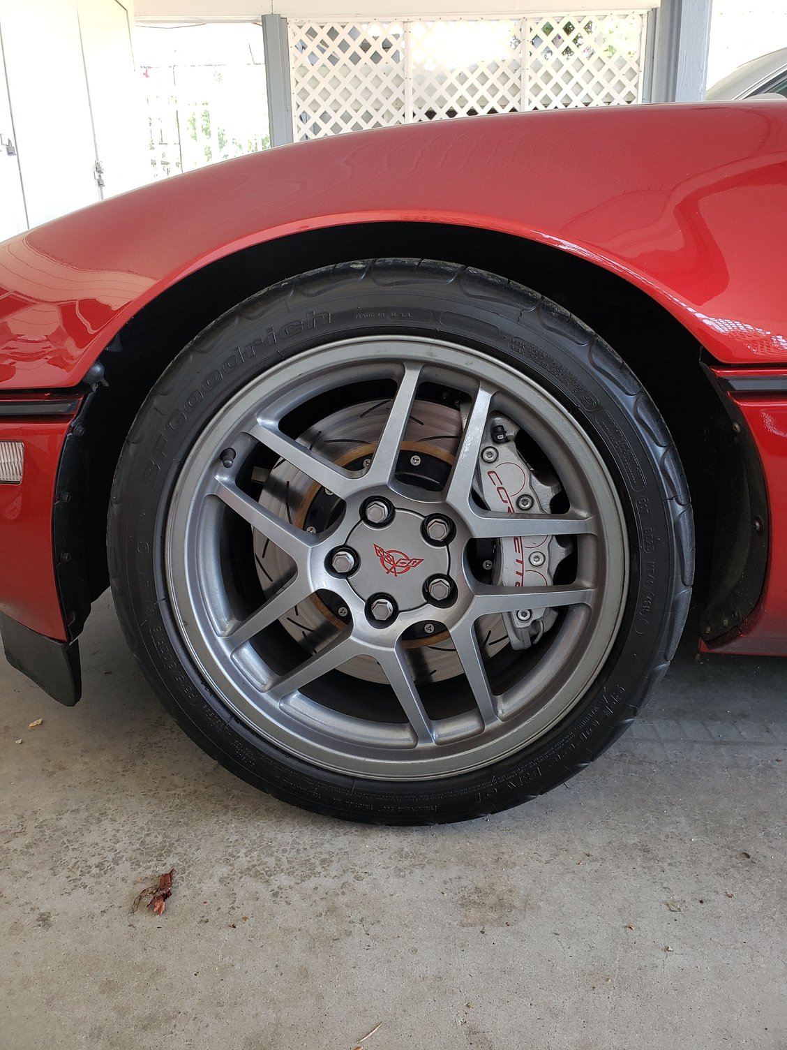

here are my c6 z06 brakes on my c4. also get the lokar brake kit.

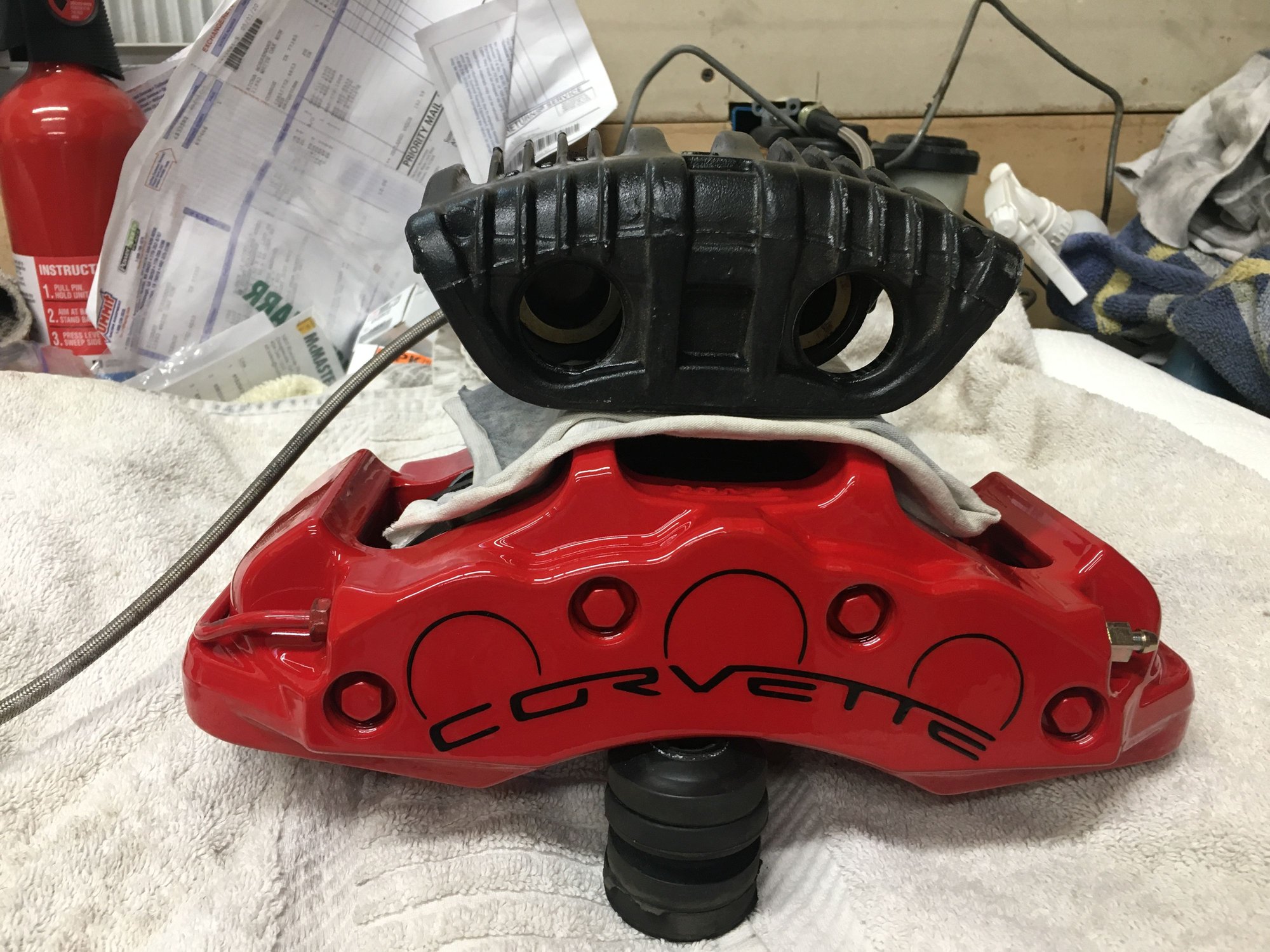

the c6 z06 front caliper compared to the c4 front caliper
yeah, i know, the rotors are on backwards. have been switched.

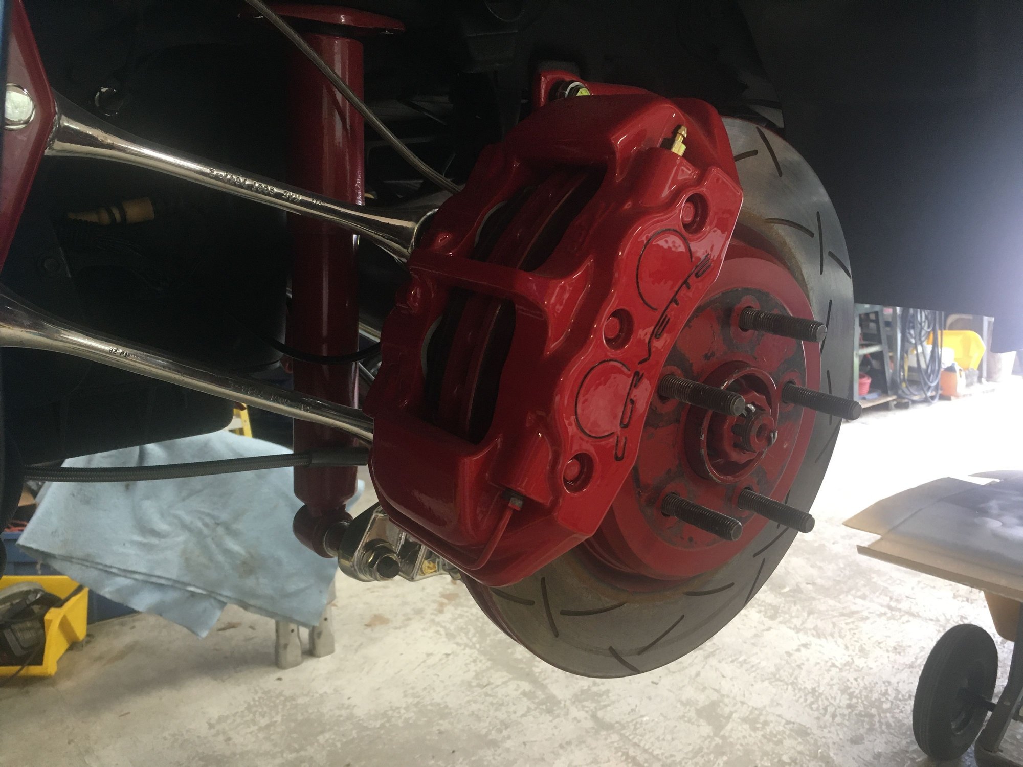

ere is what the van steel caliper adapter looks like.
To Larger c4 rear caliper
