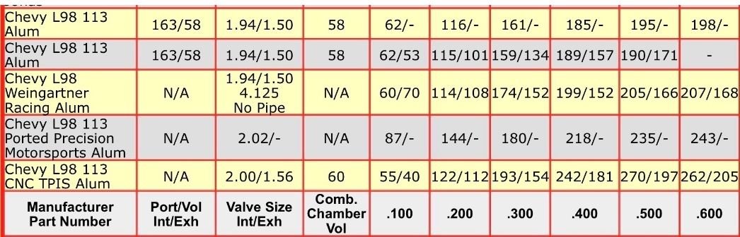

Anybody know max lift for a 113 cyl head?

I believe its .470

Are you using a set for a project? Just curious because everyone dishes on these aluminum heads. IMO, depending on what they are used for they can be made to work pretty well, assuming one isn’t chasing 6,000 or more RPM.
