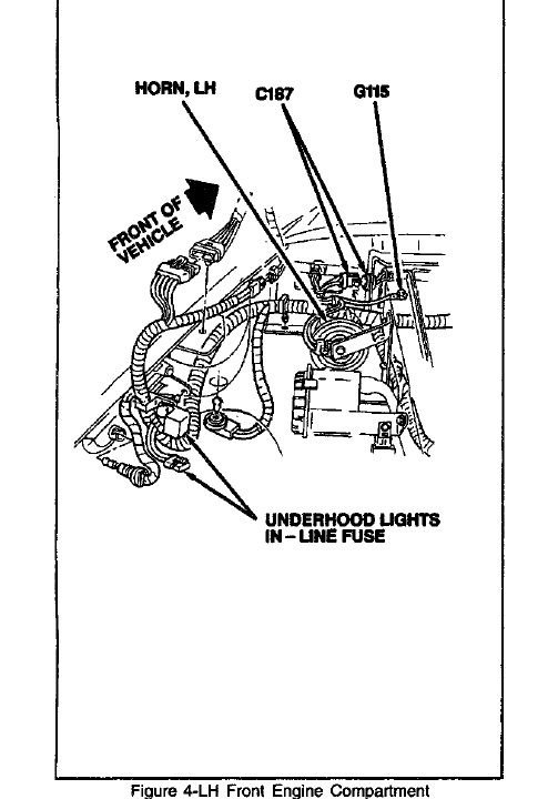

I was putzing around on the car today so I pulled the lenses for the hood lites and cleaned them. Since the hood is open a lot while I clean and repair things I was looking for the switch so I could disable them. Well I can’t find it🙁. I don’t have my FSM yet so figured one of you experts could send me in the proper direction a lot faster then if I try to follow the wire loom.

In each front bumper wells by the marker lights there are plugs with two wires they are the power supply, the actual switch is a Mercury pellet in each light fixture.
. There is also a fuse for each side in a rain cover in by the corner lights

Thanks👍 I kind thought it might be a mercury switch. I’ve worked around a lot of those over the years. It just seemed overkill instead of using door type switch.

Old Feb 13, 2022 | 02:53 PM
Biloger's Avatar
Biloger
Joined: Feb 2022
Posts: 63
Likes: 6
Originally Posted by WVZR-1
Thanks very much👍👍
