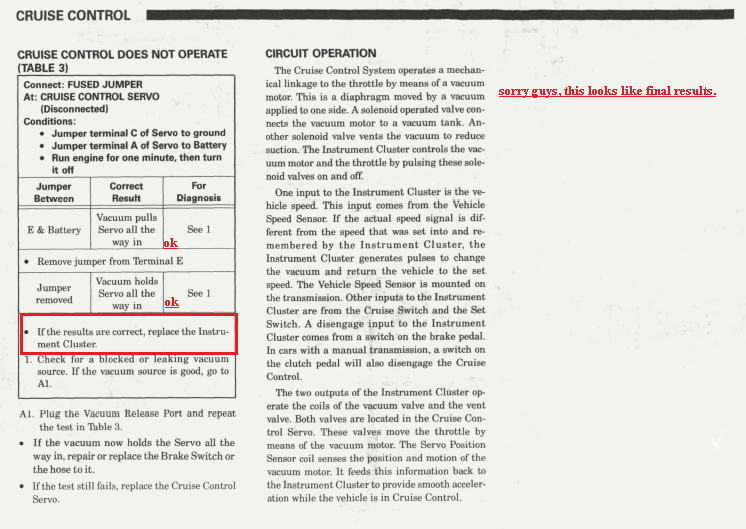

Sorry guys, final live test didn't do well. I will contact Bryan at Batee.com. The funds may not allow.

Hi WVZR, what gets me is I did the polarizing film,bulbs, even had to repair the VSS connector. The IP is fully
lit and fully functional! Of course my gas mileage is only at 9.8 MPG,which I was going to confirm
as soon as I get to drive enough :-). I have to wonder if the TCC has something to do with both the
mileage and the cruise? I believe, If its not locked, then the cruise wont function. At 62 MPH my tach reads 19K.
I believe thats probably correct. I will get this done, but I am about to start a bathroom renovation. I was hoping
to get this done before this next project........dammm

WOW! Excellent detective work! I am excited again! You see, where I live in VA. its mostly a speed trap. So, besides Cruise being a convenience
its practical. I did send an E-mail to Bryan,now I'm anxious to see what he comes up with!

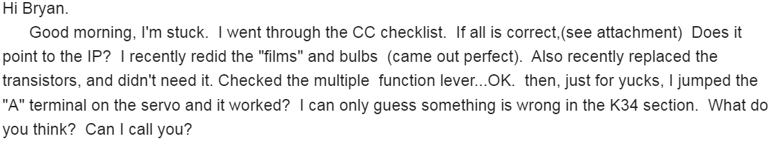

update..............Sent this e-mail to Batee. Still updating the bathroom. found some time to investigate. Stay, looks like i'm going into April.
