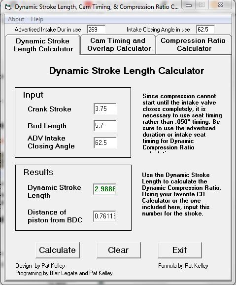

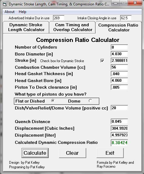

For anyone downloading the DCR calculator linked above, this short set of instructions may help.
FIRST, enter cam specs: Advertised duration (seat-to-seat not .005"), LSA, and ICL
After inputting cam info, press "Calculate". Results (cam events) will fill in.
Click on the left tab next (Dynamic Stroke). Fill in stroke length and rod length, press "Calculate".
Effective "swept volume" of the stroke will fill in. You need this for the Compression tab.
Fill in build specs, ending at piston volume, Click "dynamic stroke" box. It will pull the calculated number from the first tab.
Calculate button will reveal DCR.
Unclick "dynamic stroke" box. Re-enter the stroke YOU entered on the first tab.
Calculate button will reveal SCR.
Use info from advisers/builders/forum to decide desired compression. In general, sites will suggest 7.5 - 8.5 DCR for alum heads....1pt lower with iron. Good quench will create the best builds...and allow a bit of increase. Typically, you want to most compression as it increases efficiency, MPG, and power.
Note: I'm at 8.3DCR...which means I might have been able to go higher (than 10.2:1 SCR). Also notice, my quench is .045. I found .030-040" as the ideal range to shoot for. I chose a .040" gasket and asked my builder to zero deck it. Instead, he took it down to .005 -- saying he did me a favor -- in case of future build. You know...so the next one had room for another "clean" deck and .040/.060 over pistons. It turned out OK...no detonation.
