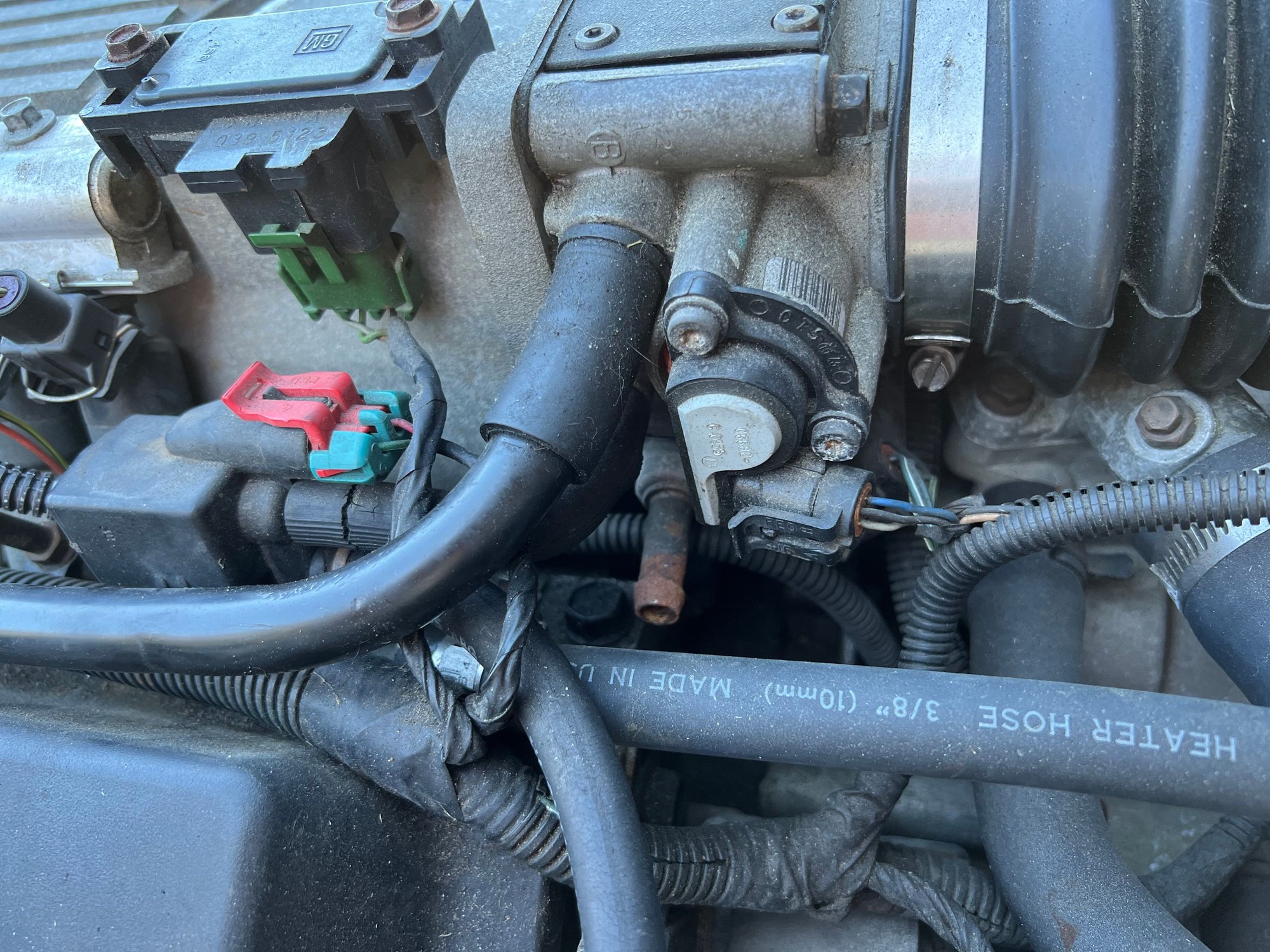

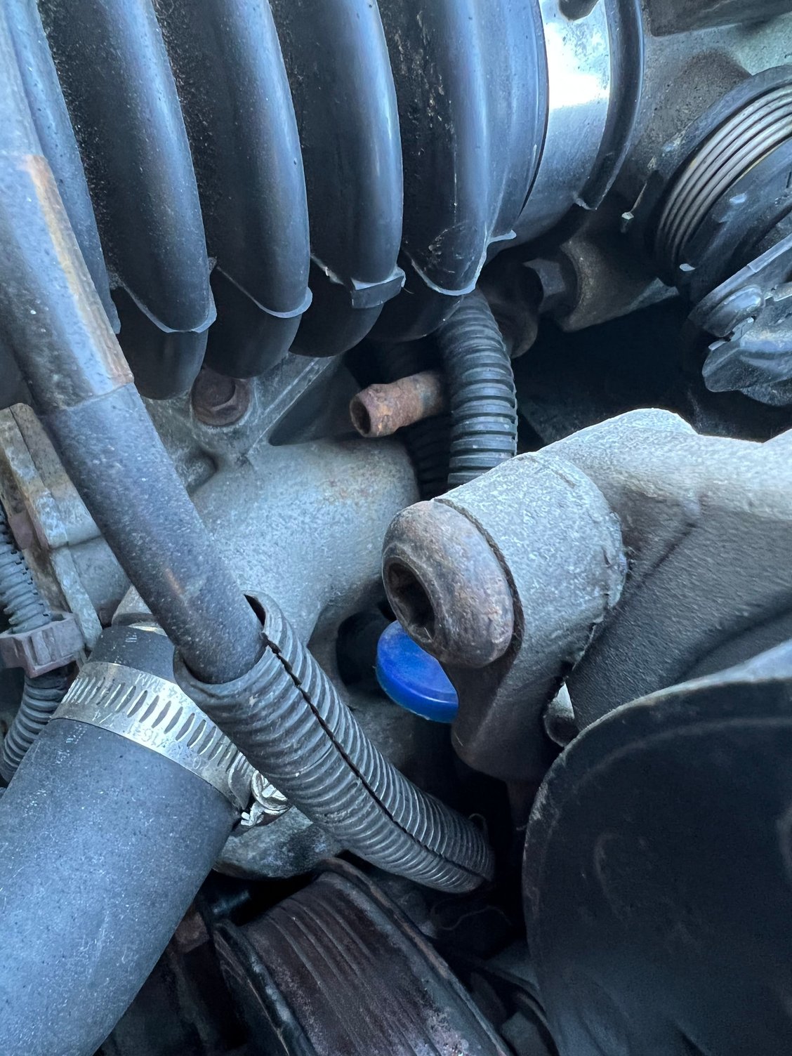

I discovered I have some hoses broken and missing near my throttle body. Can someone help with ID them and replacement. I have the red manual and I can’t find them.
first picture is driver side. What is this and where does it go
second picture is passenger side. The small L hose is failing apart how do I fix. Buy a foot and make a loop. What is the barb under the hose. Both barbs are rusty so it’s been missing for some time. Is it normal for this to be missing

Your throttle body cooler has been by-passed. If it was done well just put caps on those ports to 'PRETTY IT UP'!
It should be found in the FSM. The outlet hose is #215 FSM, Volume 1 6A1B-3
