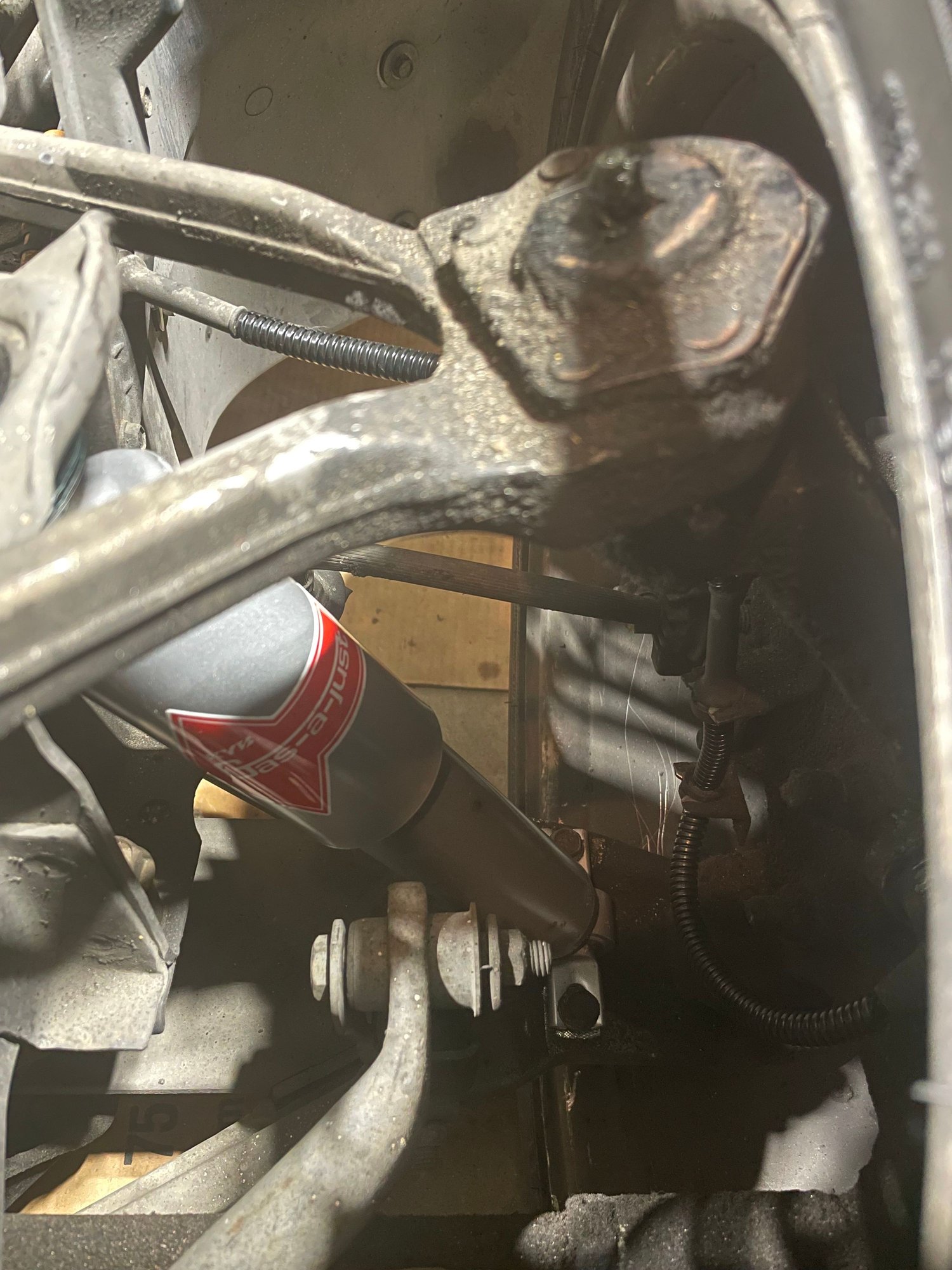

KYB shocks and Energy Suspension poly bushings
Overall, this job was easy. I liked the idea of using polyurethane bushings for both the front and rear upper shock mounts, so I ordered black Energy Suspension bushings from Zip Corvette (which, by the way, are generic upper shock mount bushings, they are not C4 specific). When working on the front shocks, my initial understanding was to torque the top shock nut to what the FSM says, which I think was 19 ft-lbs but don't quote me. We hadn't even gotten to 10 ft-lbs and the poly bushing was pancaking. We backed off because it didn't feel right. After some research, I have come to the conclusion that the torque spec for that night was decided by GM for the specific bushings they made of a specific material in a specific shape and 19 ft-lbs was the right torque. With different bushings made of different materials (rubber included) in a different shape, we can't use the FSM torque spec for this nut. I called Energy Suspension to see what they think it should be torqued to and after a 10 min conversation, they decided it'd be best to tighten the nut until the bushings bulge slightly outside the washer KYB provided while the weight of the car is on the wheels. Maybe everyone knows this already, but I saw so much conflicting info online that I wanted to share exactly what Energy said. Another thing I wanted to mention was that the rear shock's upper mount poly bushings did not fit completely with the KYBs. (I don't know if this is true on all shocks for our cars.) By the time you place the bottom washer, the bottom bushing, the bracket, the top bushing, and the top washer, there are no threads for the nut to grab onto to tighten everything down accordingly. I ended up using a poly bushing for just the bottom bushing and using one of the rubber bushings KYB provided for the top bushing because I wanted more stiffness out of the shock's bushing setup and I figured I'd get more of what I wanted if the poly bushing were on the bottom than if it were the one on top. Finally, marine grease, which I used very liberally seems to be working great with the poly bushings. In the limited amount I've driven the car so far, I've heard no squeaks. And while I can't speak on the quality of the KYBs specifically, what a difference these shocks are compared to the old ones; they felt fantastic on the road. My buddy could compress the original Delco shocks with one hand on each end, but he couldn't budge the KYBs.

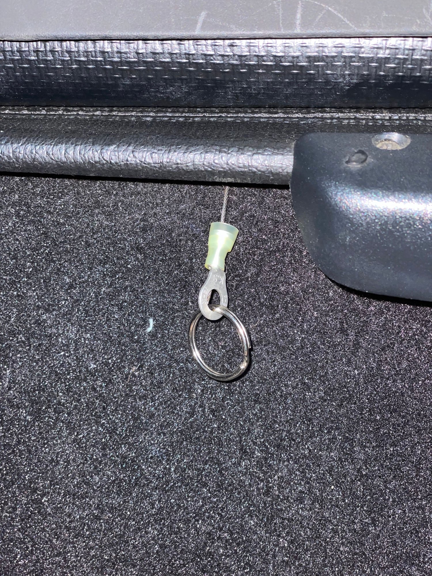

Hatch release cable with crimp lug
Just a little addition I made that I also wanted to recommend to everyone. I attached a 12-10 gauge 1/4" ring terminal to the rear hatch release cable that sits under the trunk cover with a crimper and hooked on a keychain ring. What a relief it is to not have to carry around channellocks while my hatch release buttons don't work. I also imagine this is a great addition for everyone even if your switches work just incase something does go wrong in the future and you don't have pliers, that wire is impossible to grip and pull with your fingers.
