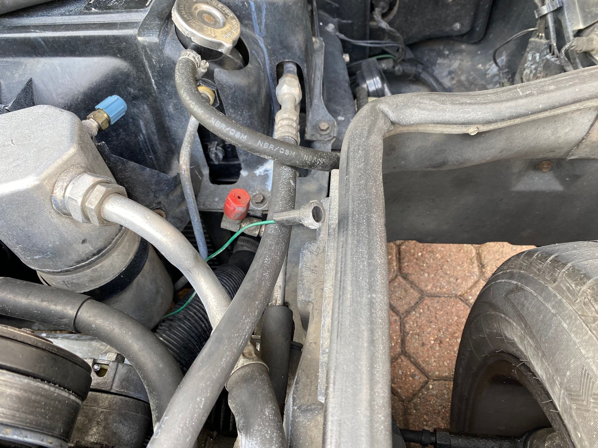

Where does this green wire go?

Low coolant probe in the right radiator tank 'if' radiator is OE.
*** If you've the FSM then I believe 8A-82-3 might help you.
***Your radiator appears to maybe have a cap over where the sensor would be. I don't know that I've ever seen it 'capped'. GM# 10054615 or equivalent

If you zoom in you can even see the probably Fake sensor filling the spot were the sensor goes

You are correct, must have replaced the radiator and they didn’t replace the sensor, that one is just a dummy one.
Thanks for your help
