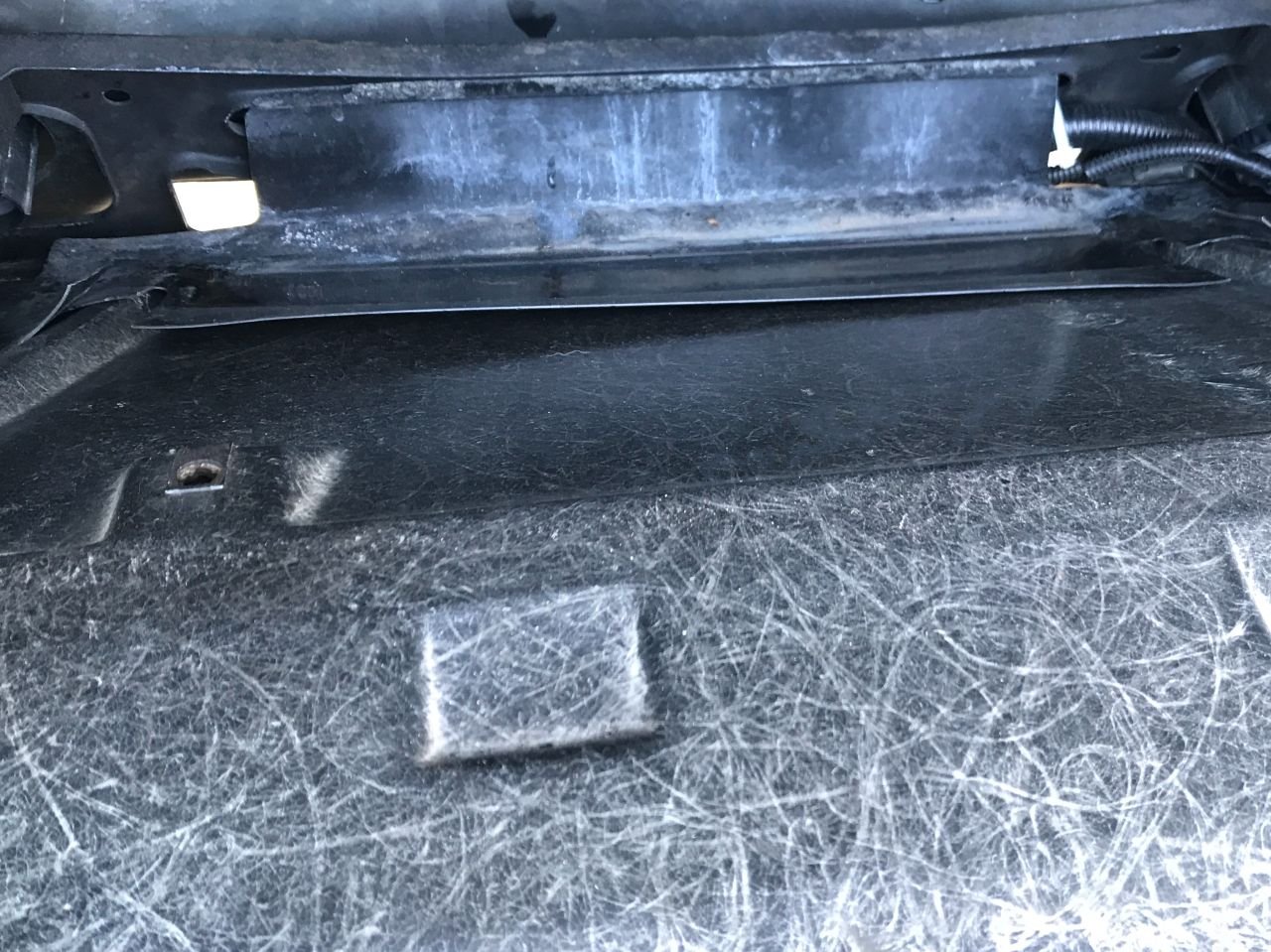

Originally Posted by tfvesquire
While I had the airbox put I checked the filter to make sure it was brand new (good to go) and noticed the loose black plastic air flap just lying underneath the box.
I pulled it out and cleaned it and vacuumed the surrounding areas that had some leaves and debris and put it back the way I found it. I assume it just lays in there and somehow directs air flow into the front of the air box?
That's actually a splash guard. It keeps water from getting into the filter box.
It installs like this...
Thank you for posting the information on the air intake "deflector" but I think it would decrease air flow a ton if that is in fact how it should be installed. I'll have to remove the front portion of my air filter box and see if it will fit that way. It is pretty thick ABS plastic that doesn't bend too well. I don't recall seeing the attaching clips on either side of the deflector to hold it in place. Mine was literally laying underneath my air box.
I've always thought the same. It seems only logical that it would indeed restrict the flow of air a great deal when installed ''correctly.''
But that's how it gets installed. So they say.
Here's a previous thread on it...
https://www.corvetteforum.com/forums...installed.html
There's also a link to a Mid America pdf in that thread with installation instructions. Though the pictures in the pdf are crumby.
A lot of people just toss em. It's not like many folks are really driving through standing water or making a habit driving these cars in the rain anyway.
