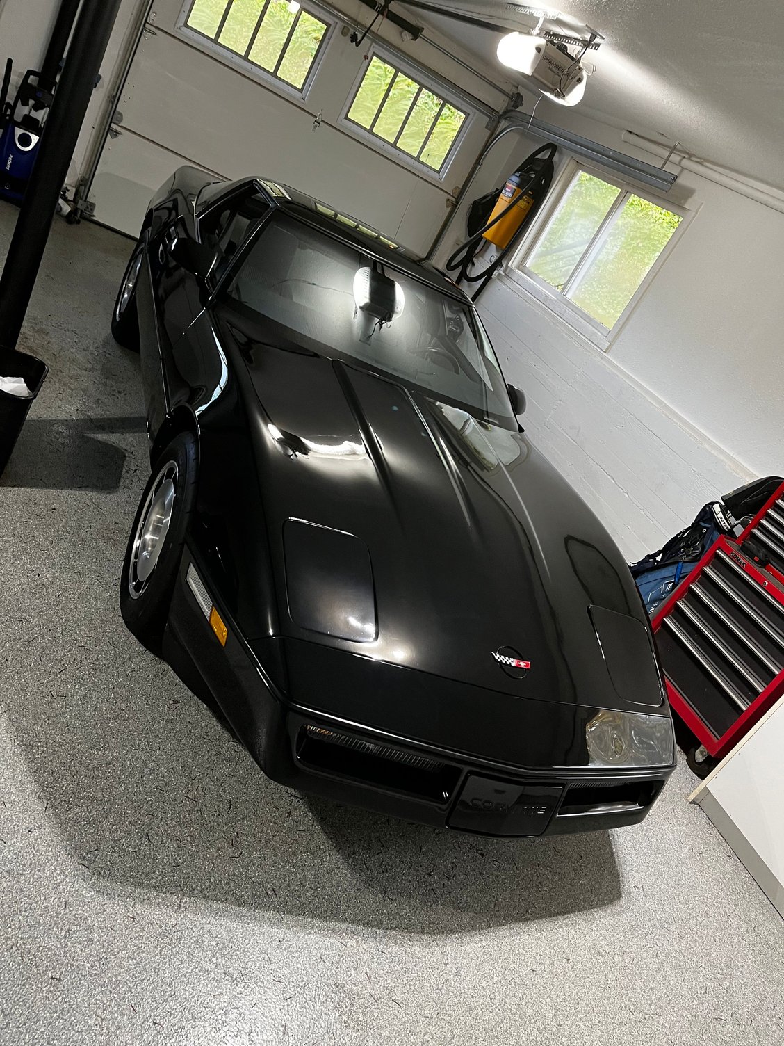

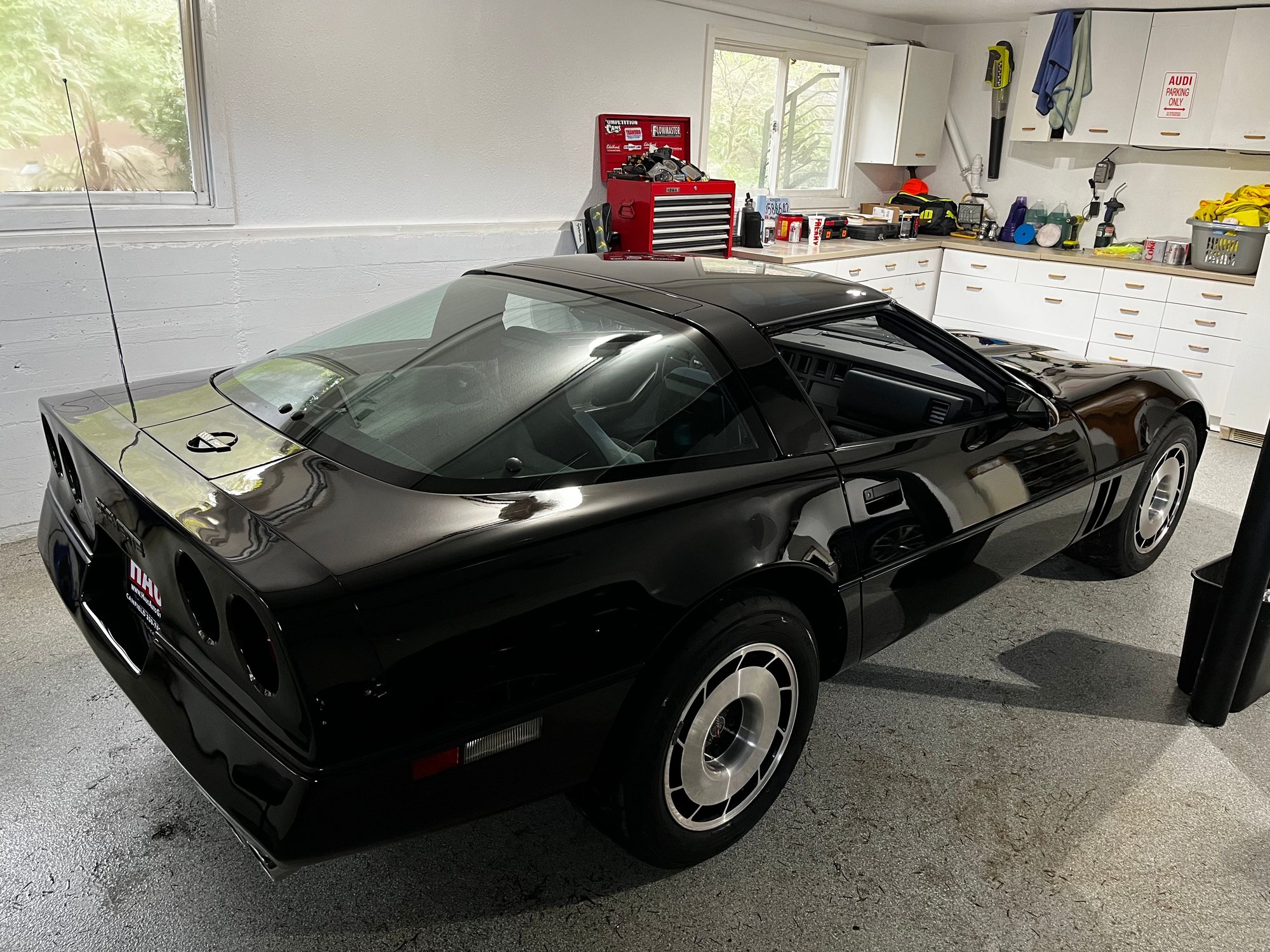

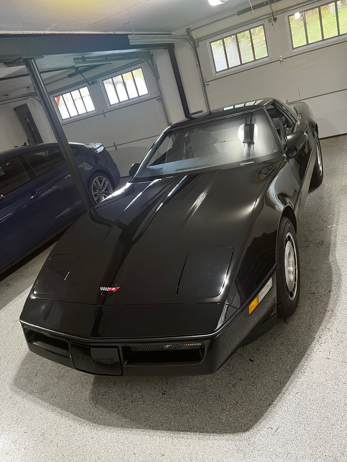

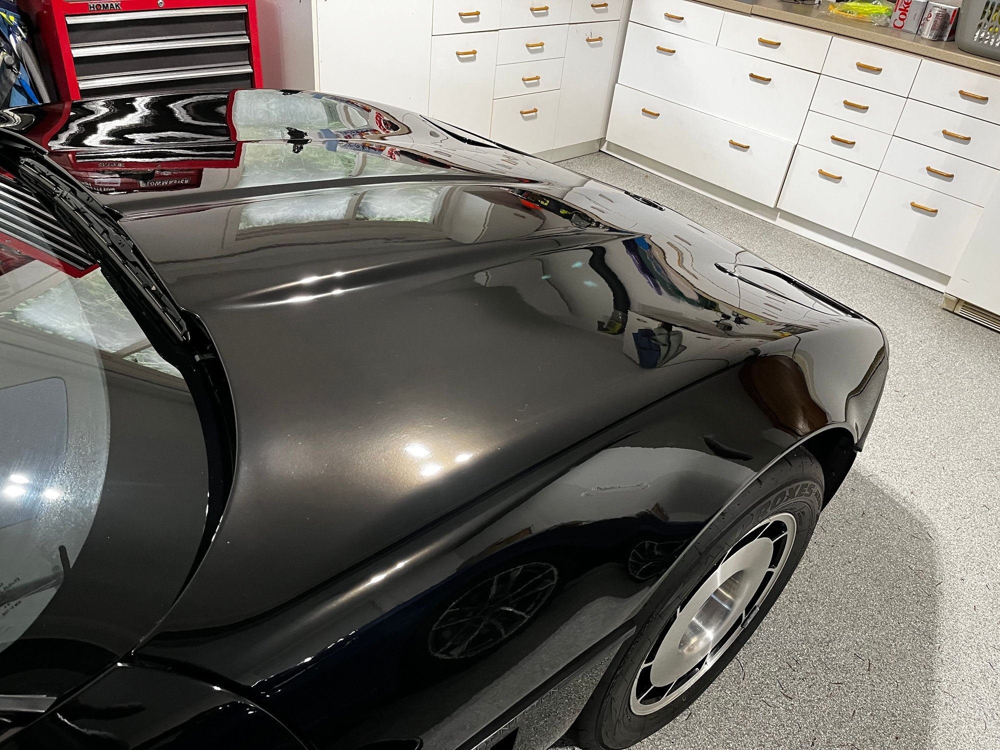

my car finally arrived on Tuesday. First mod was polishing out the hazy paint. Many hours later it looks like this. Spent some time yesterday ordering misc. parts as well as a set of wheels and tires for the street. The stock wheels have new track tires on them. Next issue to sort out is the overdrive. It was rebuilt before I bought it but does not engage. Im hoping that its just a wiring issue. The light does come on when it is supposed to be engaged.

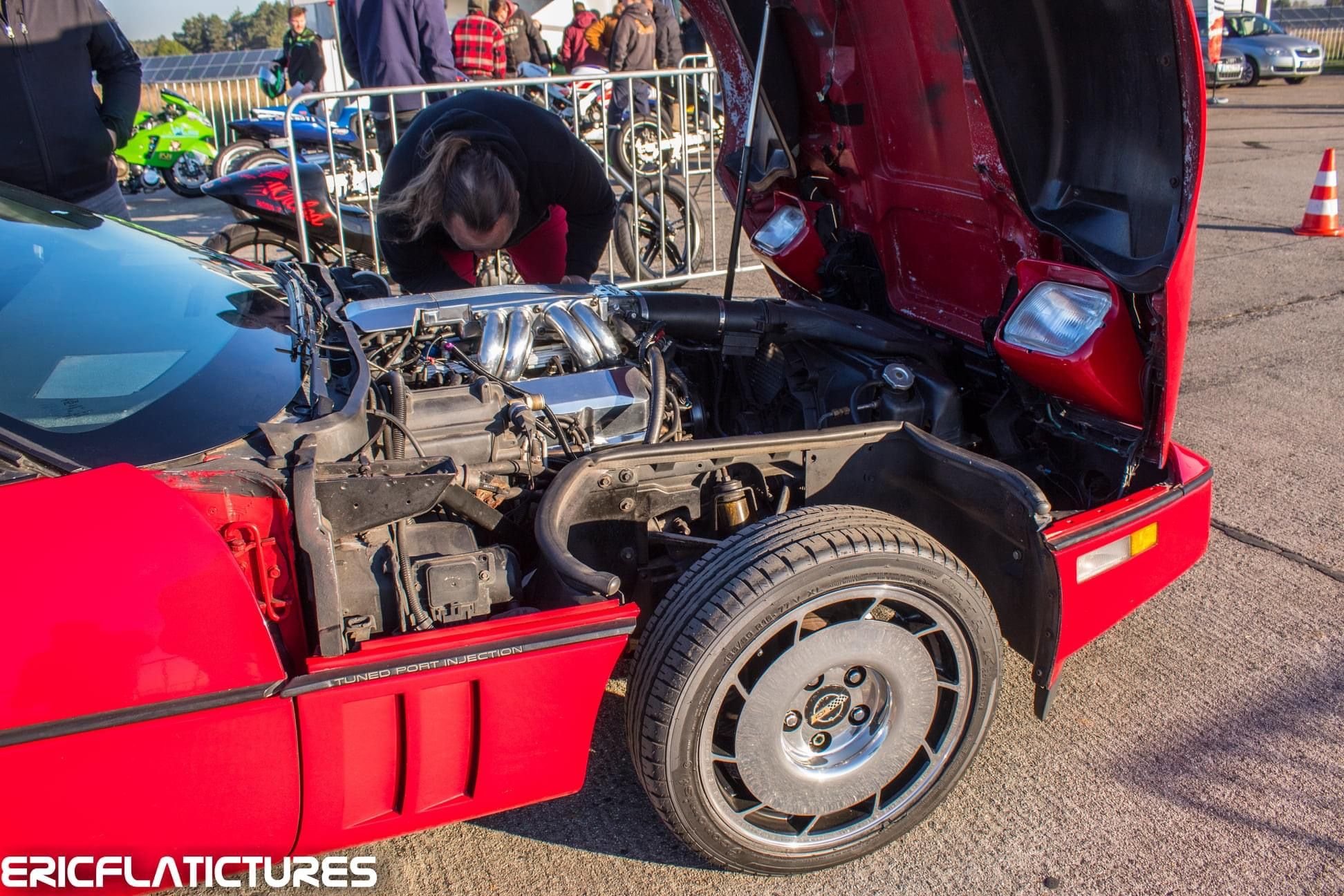

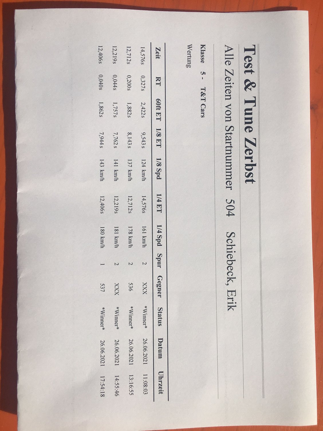

Hello,
my 85 with a basically stock L98 ran a best 12.215 in the quarter with a 175 hp wet shot of nitrous.
For racing I remove cat and the mufflers, The passenger seat is out ( I mount the nitrous bottles there ).
AC is removed for weight reasons, don´t forget the spare tire. Tank is filled to one third, don´t get lower,
the pump pick up will run dry. We use stock wheels, the front ones are narrowed for front runners.
Rear tire is a Hoosier QTP. I run one size larger injectors to keep it running a little on the rich side

^Efficiency^
What's it trap?

That was 181 km/h, that should be around 117 mph. I´m based in Germany.
Here is a print out from a Test & Tune in June of 2021:

Damn good trap speed for what I'd guess is ~400hp.

My estimate is she should have 235 hp,but the engine is old and stock. The original head gaskets from 1985 are still in use.
I would say 200 hp is realistic after 72.000 miles. We run a 175 hp wet shot from ZEX.
So yeah, we will be somewhere between 375 till 400 hp. I never dynoed this.

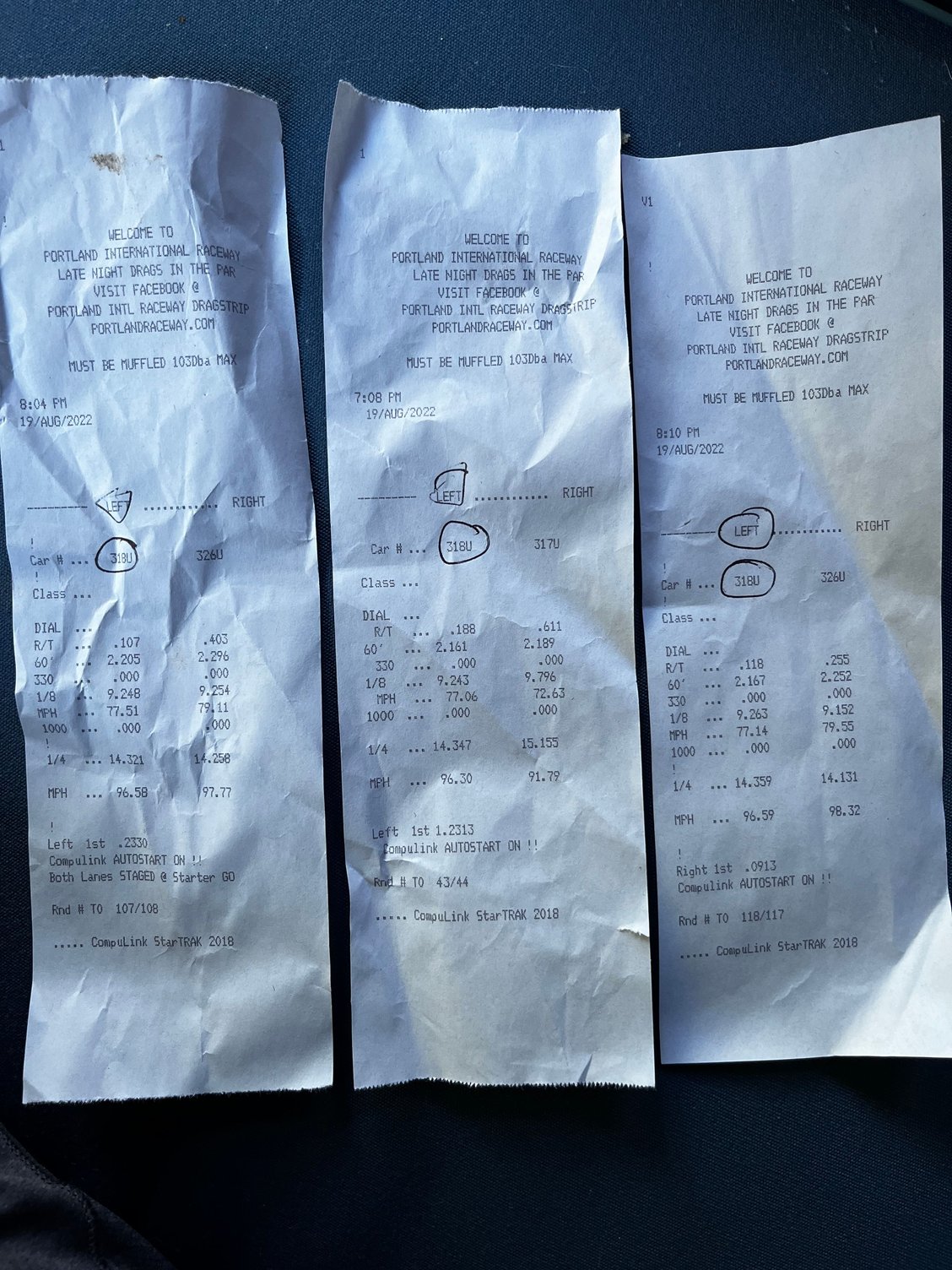

After months of work sorting out all of the issues on the car, I finally got it to the track last week. Ran a best of 14.3@96mph (backed it up with several passes). This was bone stock, except for K&N filter and a Borla cat back. Ran it on my street tires (Conti DWS06).
It was a bit tricky to get the launch just right. Shifting at 4500 produced the quickest times.
now I have to install my headers, rockers, and sticky tires and see if I can get into the 13’s!

can you post the timeslip or transfer the data points?[/size]

Sorry that took so long. I kept forgetting to get the timeslips out of the glovebox!
