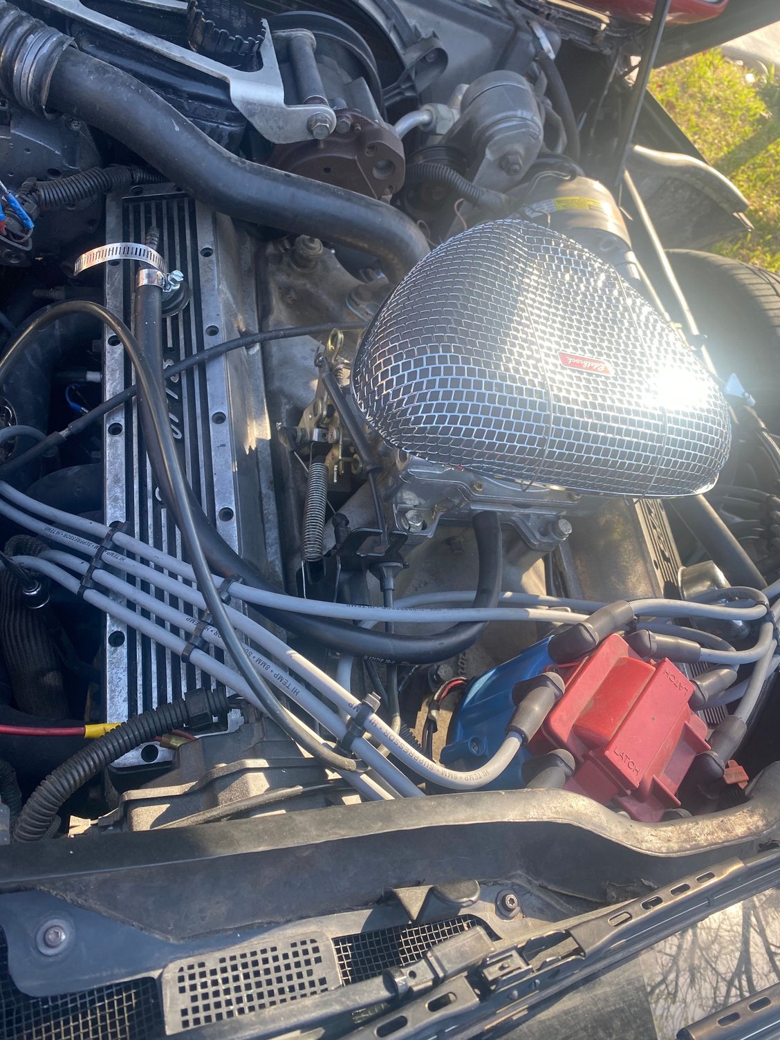

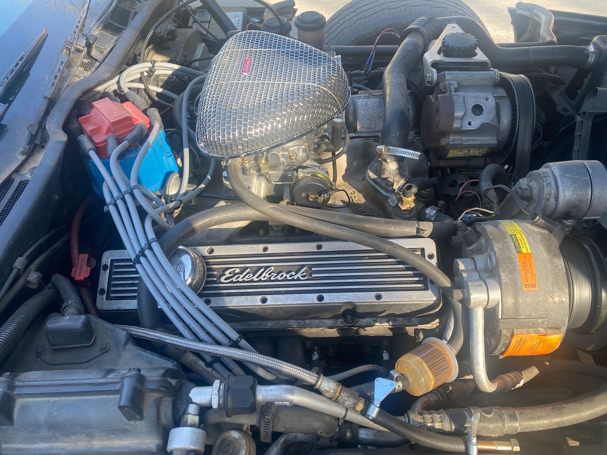

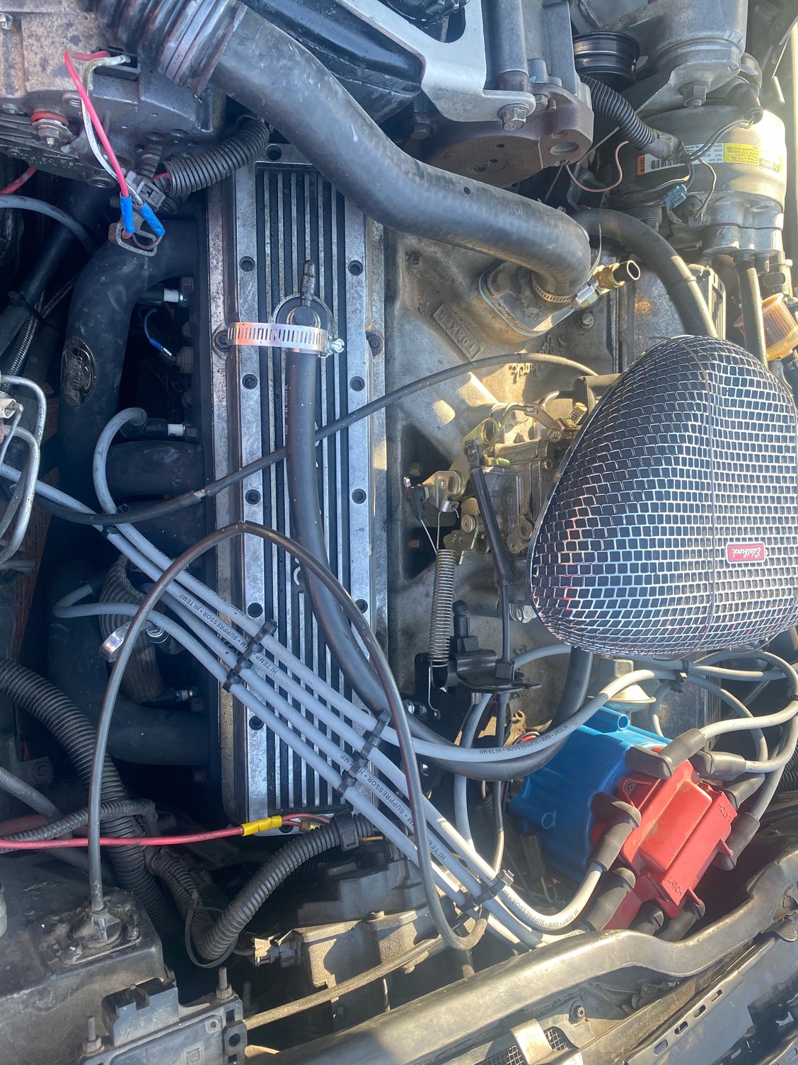

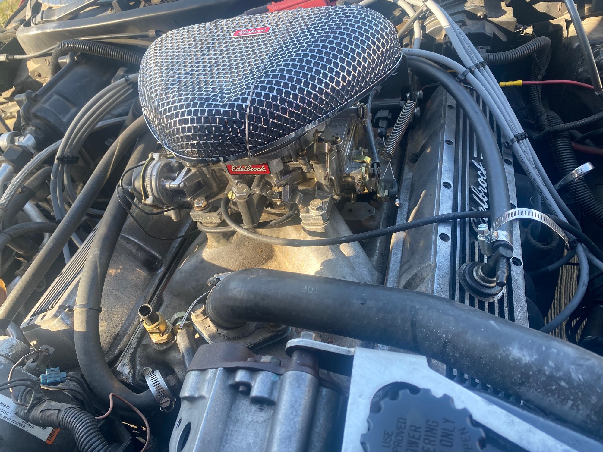

Alright here’s some pictures of the engine bay . Full backstory on the car supposedly kid had a Holley sniper kit on it previous to my purchase. He said he couldn’t get what he was wanting for the car with it installed so he removed the Holley system and threw on the edlebrock . He told me it would need tuned so I did a rebuild on the carb and cleaned the jets, replaced plugs and wires and that’s as much as I’ve done to it. The car stumbles on takeoff and cleans up about 2700-3000 rpm’s and has an inconsistent idle . The idle will clean up a little after it’s warm but stumble on takeoff is still there. Other mods to motor are a comp solid lift cam and hooker headers. Kid said cam was installed by previous owner and didn’t know the cam spec.

That's hilarious **** right there.
The distributor is in 2 teeth off.
Firing order looks correct but wires running needlessly around.
Personally I'd rather have the Holly.
Temp sensor not wired.
I can't see where it's getting brake booster vacuum from but probably should be where the PVC is attached.
What's your financial plan?
I would do the cylinder leak down test, to get an idea of overall integrity.
Consider getting the correct intake, or a Fitech system.
A stall on takeoff usually means not enough accelerator pump.
You have a journey ahead.

The distributor has advance springs and weights, if they are worn your ignition timing will be varying all the time.

Eventually I was wanting to return it to a Holley sniper system again and end goal for the car is a fun daily once it’s right but we’re far from that for the moment. I bought the car more so to learn how to work on cars than anything else and thought sbc would be an easier platform for a newbie . Thanks for the assessment of it being a shitshow…. I already knew that though. I’m gonna try to work on it more this weekend and I’ll try moving the distributor two teeth and buy some vent line tubing so I can try to get it back correct. I want to get the engine running right before I tackle the a/c issue

I agree with above, but also id hook up a vacuum gauge to the engine and see what you have. If you have burnt valves,etc, it will show on the gauge. Inconsistent idle could be vacuum leak, and judging by the hoses it defiantly possible.
Check timing (after you look at the weights and springs as mentioned above).
Did you pull spark plugs to compare to one another?
What are you running for a fuel pump? Also what transmission do you have?
