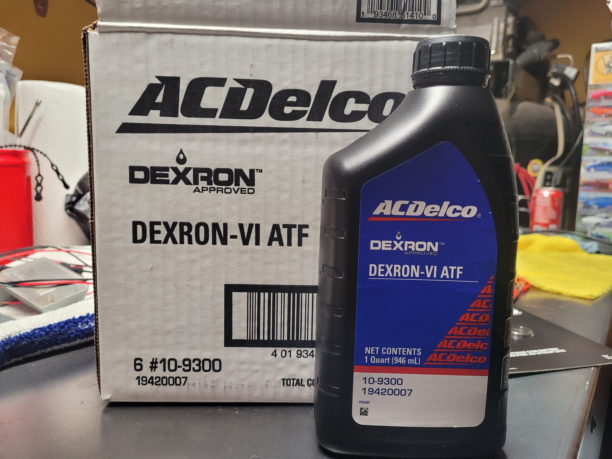

AC Delco Dexron-VI, my buddy who's been a GM Technician for over 35 years is my transmission guy, he's certified by GM to open and rebuild/fix any transmission in the GM lineup and also builds transmissions when he gets home.....I asked him what to put in my '84 and this was the recommendation! I've put it in ALL of my GM automatics '78, '84, '96, '04, '07, all of them still going strong👍
