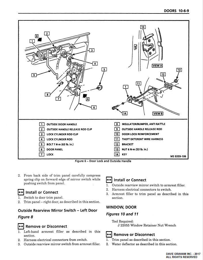

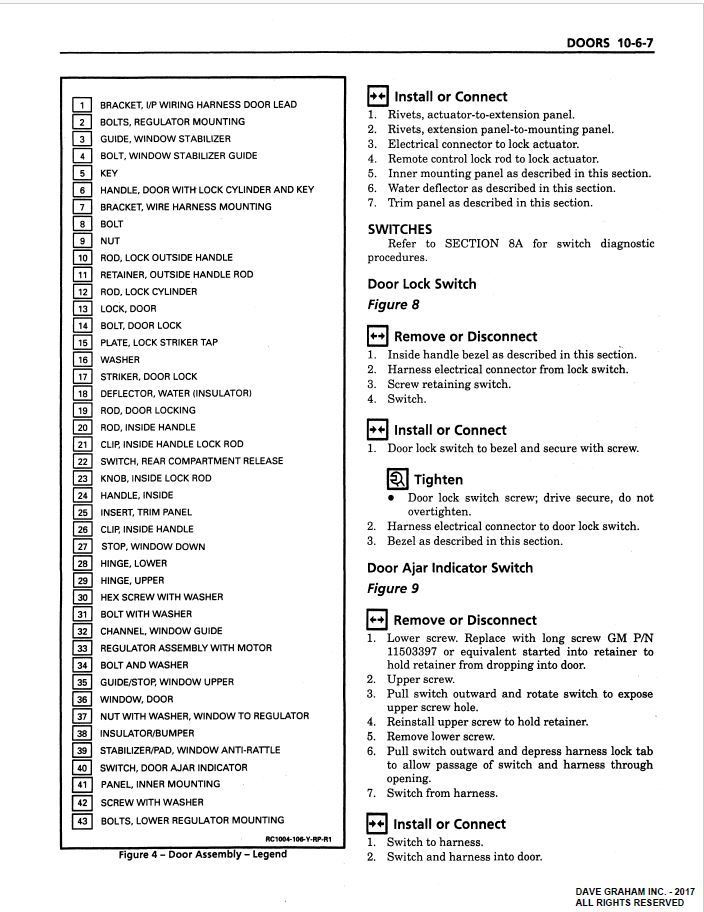

Yeah I've removed the door panel before and I could see that there was nothing attached to the door handle and that it was also quite loose. My guess is that it is occurring on both doors as I've only removed the driver side door panel previously. Is there anything in the FSM or a video that shows how the rod would attach to the key cylinder ?

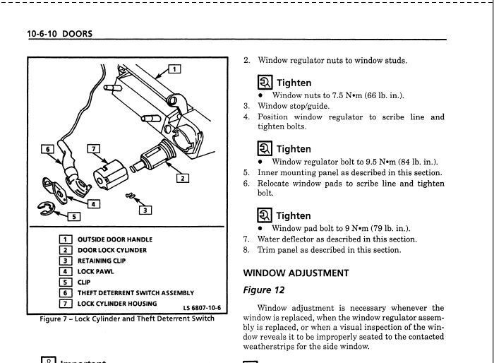

Old Apr 22, 2022 | 08:57 PM
Wintertide's Avatar
Wintertide
Cruising
Joined: Jul 2020
Posts: 12
From: Texas
Seems manageable enough, thanks guys. I'll wait for a door lock rod clip coming in the mail cause the driver side door wont open from the inside haha, it was the original reason I took off the door panel.

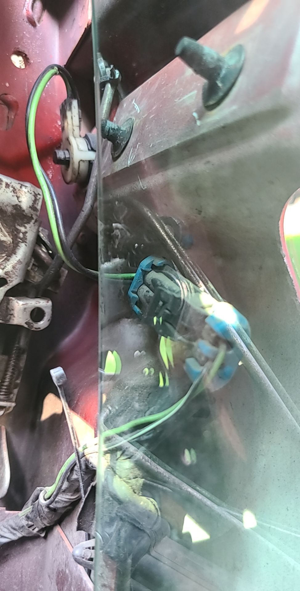

Today I took a crack at it and struggled pretty hard. After awhile I was able to finally take out the water deflector but couldn't find the direct problem for the key just spinning in the lock cylinder. Took a pic as best as I could and I'll try to see about re aligning the window properly because now it is not coming flush with the door.
