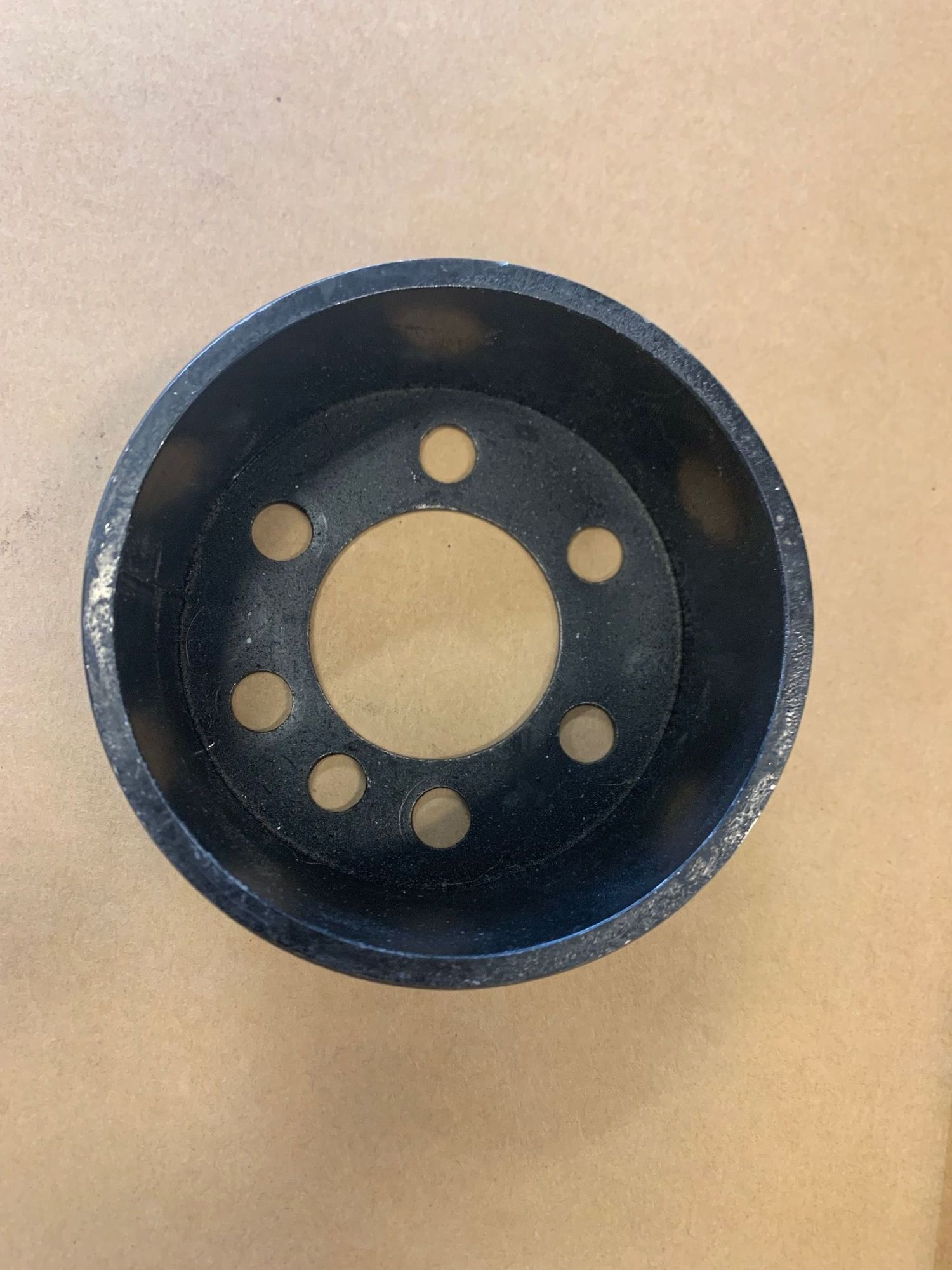

Some pics:
Eeek. Note that it appears front flywheel contamination may come from the flywheel bolts weeping from the back side.
View of hub

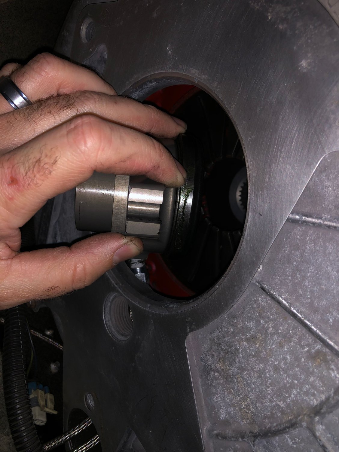

When I pulled things apart I discovered my new RAM bearing had thrown grease around onto the PP housing. I have been emailing Mike at RAM and it could be normal for the bearing to throw some due to excess grease. However there was enough that Mike suggested it’s not a bad idea to swap it out while it’s apart. Not sure how many people pull their clutch back apart after only 2-300 miles or so, so perhaps "normal" but not noticed.
EDIT: Mike Norcia is great to work with, he still thinks it could be completely normal but is sending me a brand new bearing under warranty today, awesome! He also suggested to recheck my clearances as I might be able to remove a shim now that the clutch is broken in and therefore have additional clutch life, cool!
PICS:
Huh? Believe this rubbed off of the PP housing when removing.
Some of the grease wiped off of the PP
Back side of bearing
Inside of bearing

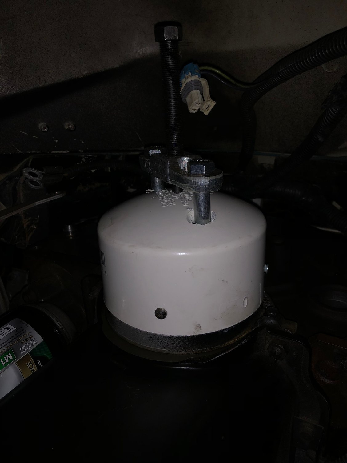

I don't like using a hammer on Rear main seals. A few years ago I made a tool by cutting out the center of an old flex plate and welding it to a piece of steel tubing. That way I can press it in evenly using bolts and have full control.

So I was inspired by RWDsmoke and the Kent Moore tool to create this frankentool…. It worked well!
4 inch sched 40 pipe inside sched 40 cap, pushed flush. The cap hits the housing right when the seal is flush so the seal cannot be pushed too far in.
Top view with 7/16-20 4 inch bolts through a steering wheel puller
Seal seated fully (carefully adjusted as went and cranked until cap flush)
Flush. This better not leak!!!! Little bit of RTV on outside of the seal before installing and some assembly lube on the inner seal lip.

Nice write up, and nice job on the install tool!
If the seal is rubber encapsulated, which that one appears to be, it's not necessary to use a sealer. However a little RTV is like chicken soup. It can't hurt.
