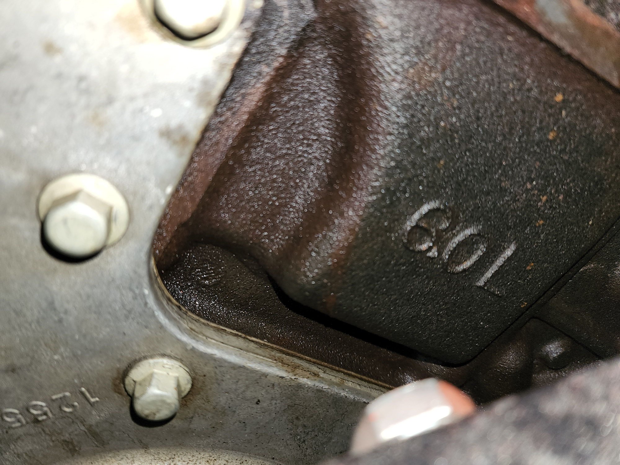

Good news, I found an LS. (Bad news if you think I shouldn't LS swap, perhaps?) I found a 6.0 LQ4 out of a 2001 Yukon XL for $850 local to me. The yard is pulling it (most of the yards around here pull the parts, there are only two that are the pick and pull type) and I should have it late next week. I'll get it on the stand and prepped. It'll still be at the very earliest next winter, likely the winter after that before I start anything big as the L98 is still healthy and I will still need to get the rest of the parts required (plus figure out a flywheel solution) but it's a start!

Good score! A super high mile junkyard 5.3 engine is 1300 and up everywhere you look in Ca. RIpoff..
Thats a great starting point for any ls build, displacement is where its at! Wont take much to turn your car in to a rocket

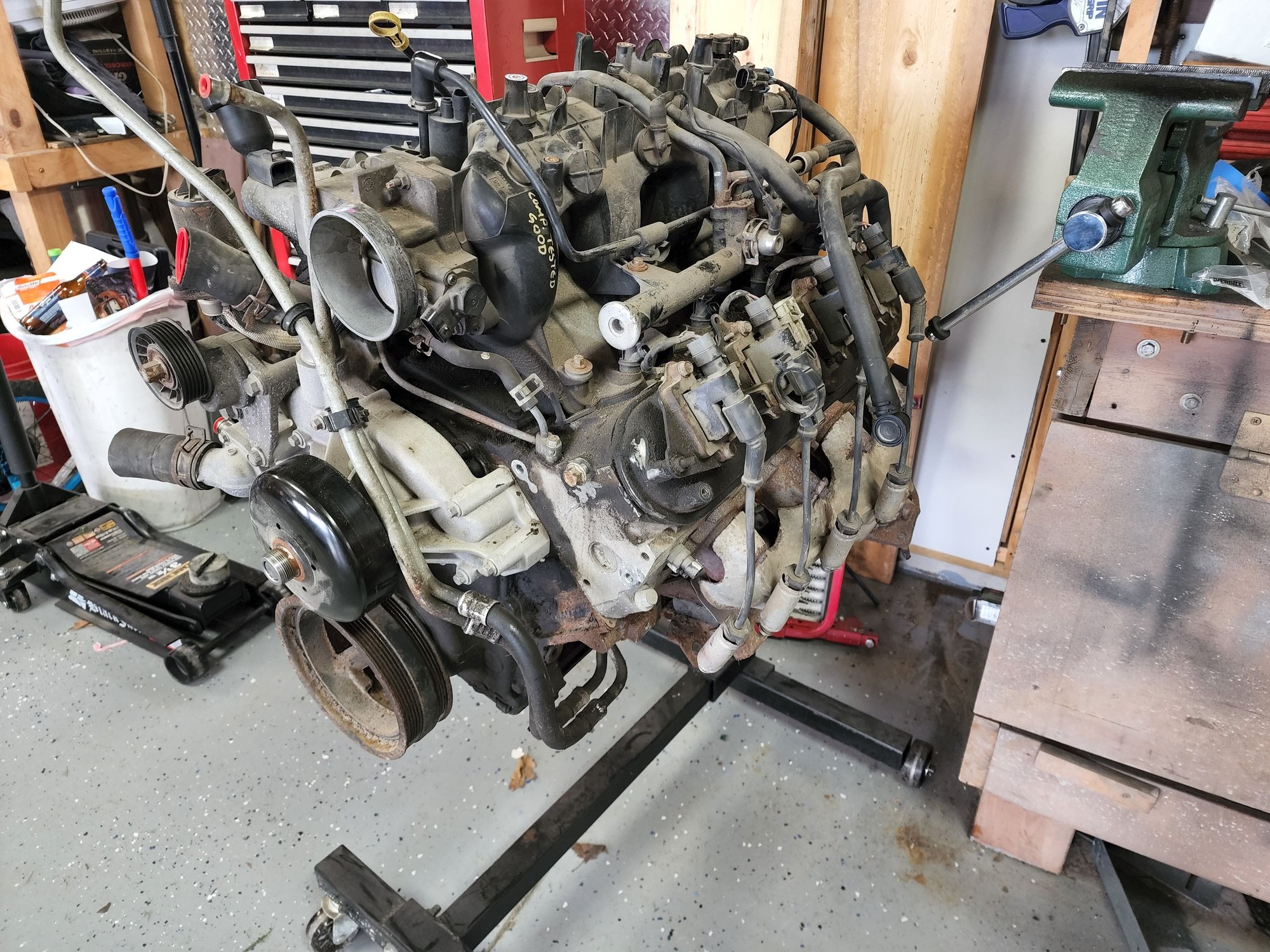

Look what followed me home! I found a good candidate for the swap. I'll start disassembly to evaluate what I've got soon. I'm in no rush as my L98 is still in good health. I'll keep figuring the other details like cam, intake, and accessory drive in the mean time. Unless I hurt the L98, I'll keep to my plan of doing the swap in this winter or the next.
To Reconsidering an LS swap.

One nice thing about the motor you got is that you can sell some parts that you can't use and make some of your money back. Unfortunately that's not the NNBS TBSS intake manifold but it's still worth $200 on ebay with the throttle body and rails. Also if you're planning on more compression than the 317 heads have to offer you can sell those for $300 and then pick up a nice set of 706 heads for around $100 (no one wants them)..This will give you over 10:1 compression with very good air velocity for low end power. (check out Richard Holdener's videos on this topic) Or you could find a set of 243/799 heads that flow better but won't give you as much of a compression boost.
If I had to do my LS swap over again I would have bought two motors. I would have got the same LQ9 6.0L that I got but I would have also picked up a 4.8L with transmission out of a 2007+ 3/4 ton van at the same time. That way I would have 799 heads, a 4L80e transmission and a TBSS intake to sell for $400. That would also give you 36 lb flex injectors. This way I could have sold the 317 heads and both intakes and made money on doing the swap.
