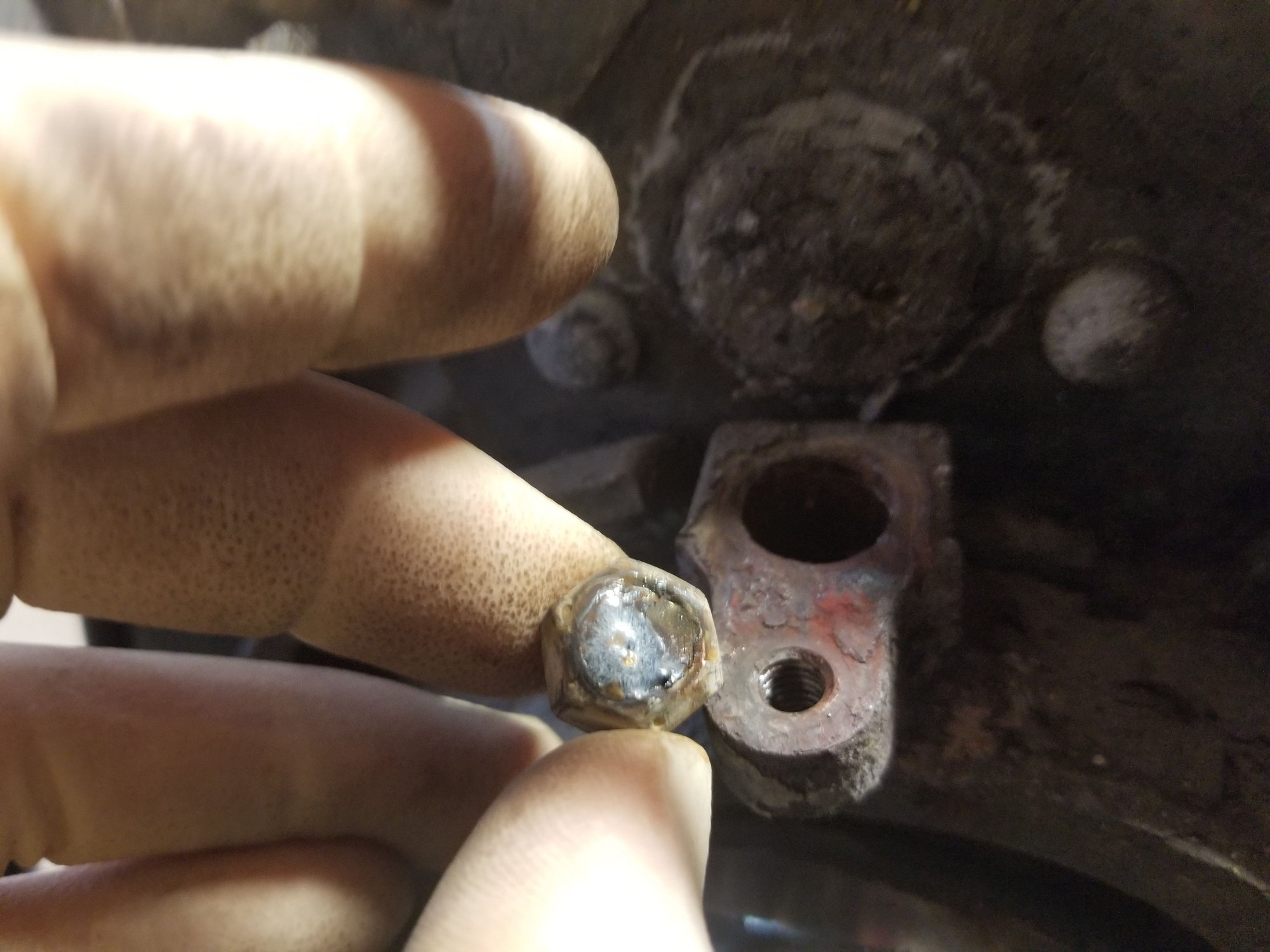

First was the Wheel speed sensor bolts. To the extent that I could, (w/o melting the sensor and CV boot below), I heated the ear of the knuckle where the bolt was, then broke the bolt off, about flush w/the hole. Removed the sensor, heated more, and then welded a nut onto the broken stud, screwed it out....

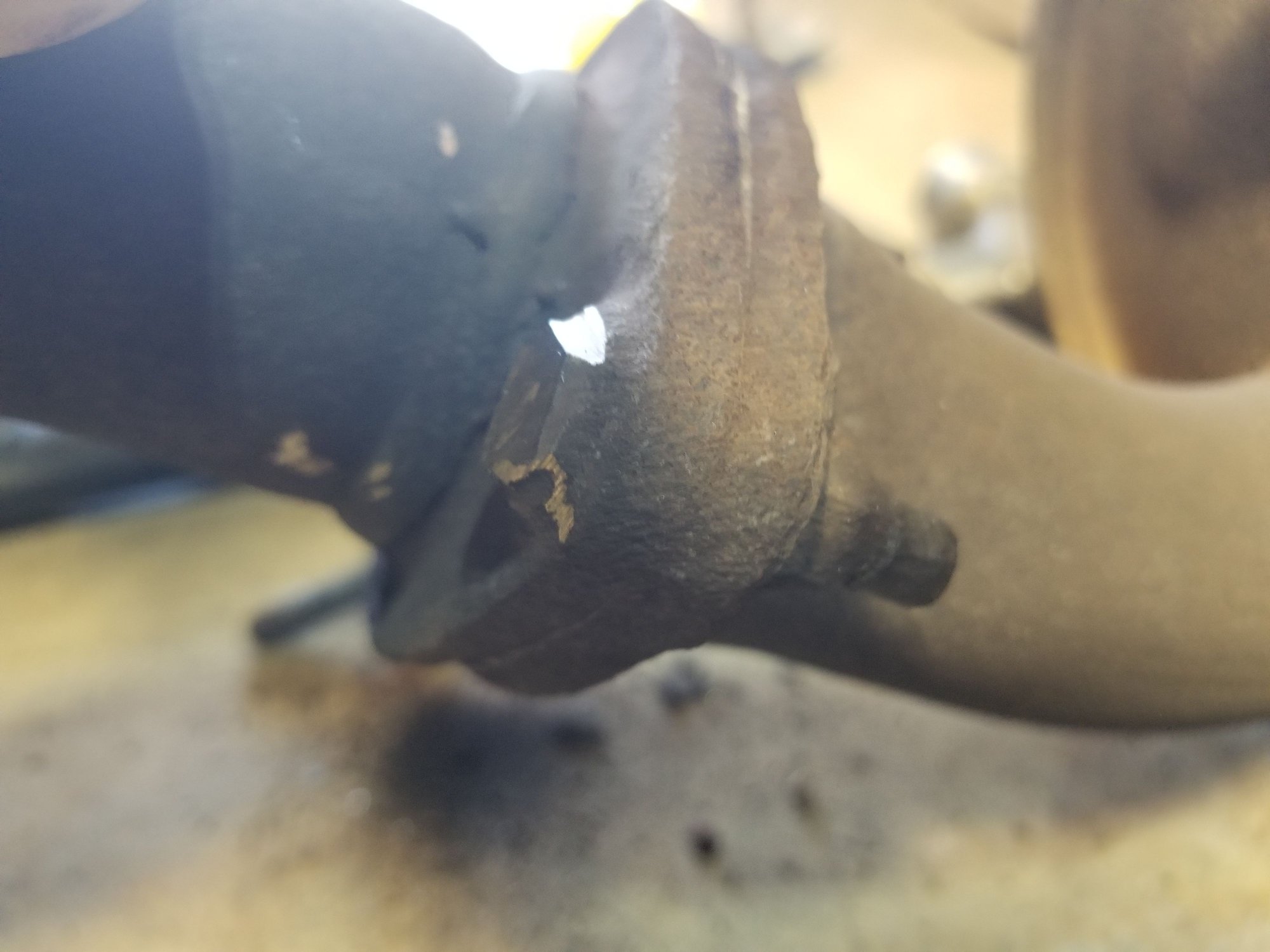

On to the exhaust....have a look at that bolt head; you can't tell where the head ends and the flange begins! Likewise w/the nut and the bolt's threads. You can see I tried to grind two "flats" onto the bolt head to get a bite on it...no dice. Then I ground the bolt head down to have a good platform to weld onto....

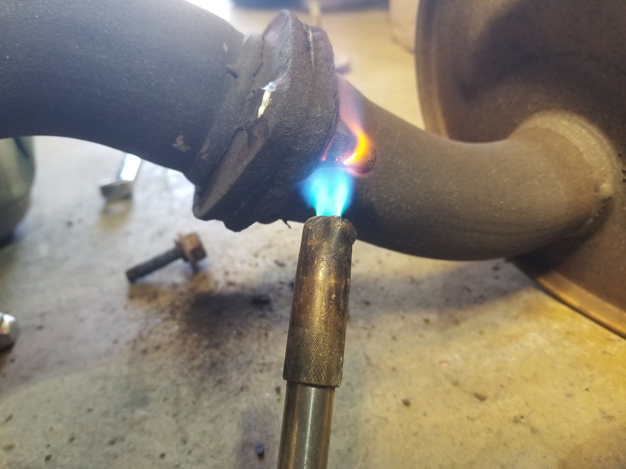

Then, I propped up my MAPP gas torch and started heating the nut-side....

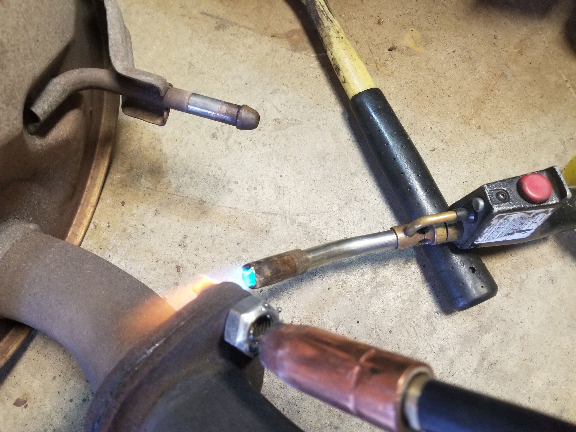

While the nut was baking, I welded a nut onto the bolt head. Lots of HEAT there!.....

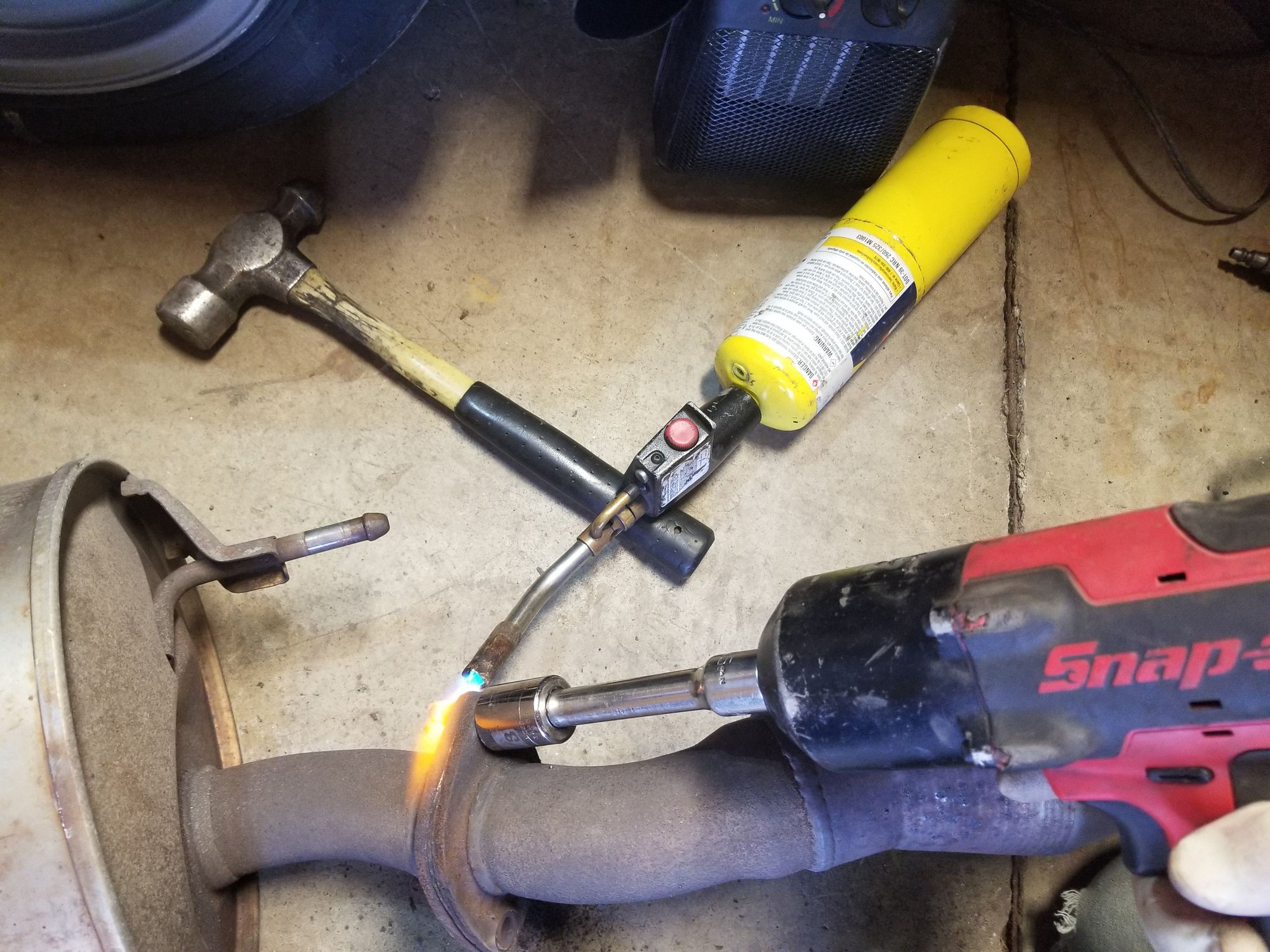

With the nut welded onto the bolt head, the exhaust nut glowing red, I hit it w/my impact.....
....and right on out, she came. Like BUTTAH!

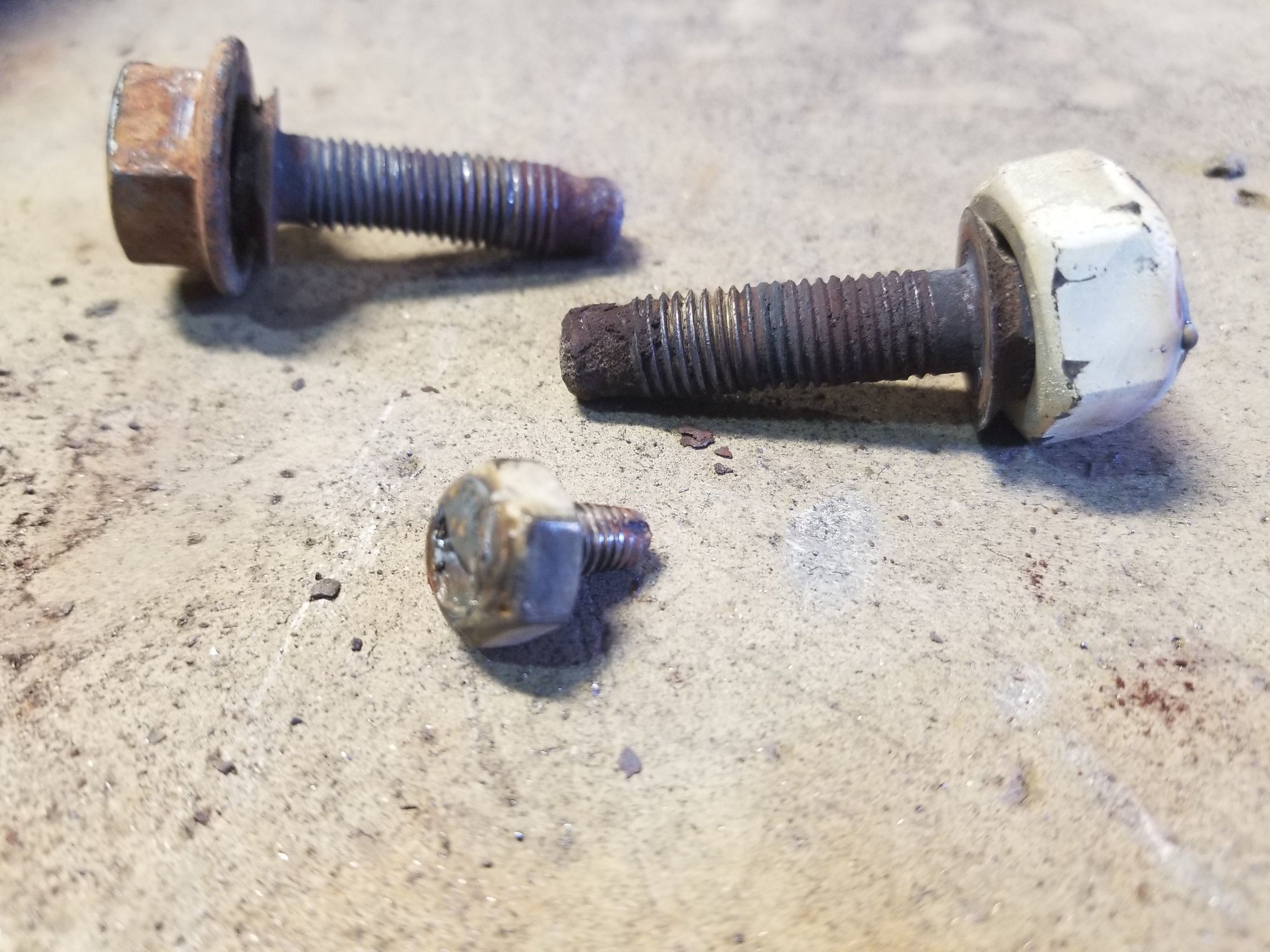

Here is the collection of stubborn sons a'....
