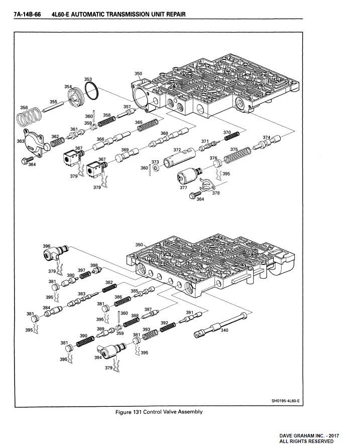

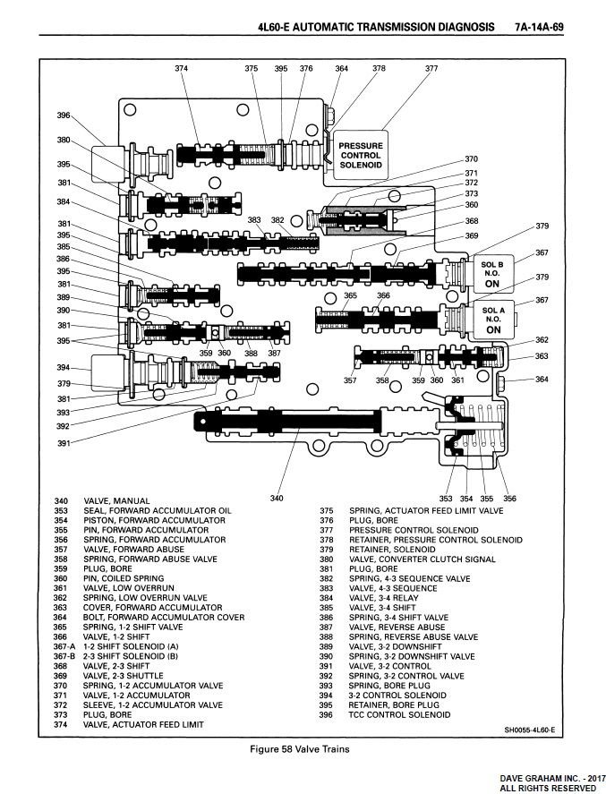

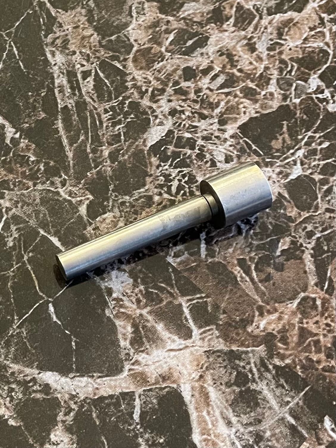

I ended up replacing the shifter cable, to no avail. Then after digging and digging. I decided to drop the valve body and separated everything. Laying it out accordingly, while matching it to the SM Diagrams. I noticed I'm missing two springs, and a valve. Also, some how this guy was inside, and I couldn't find its place (Lone Valve). Now I'm beginning to think it was the valve body this whole time! Thoughts???
Where did this guy come from????
